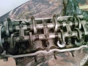

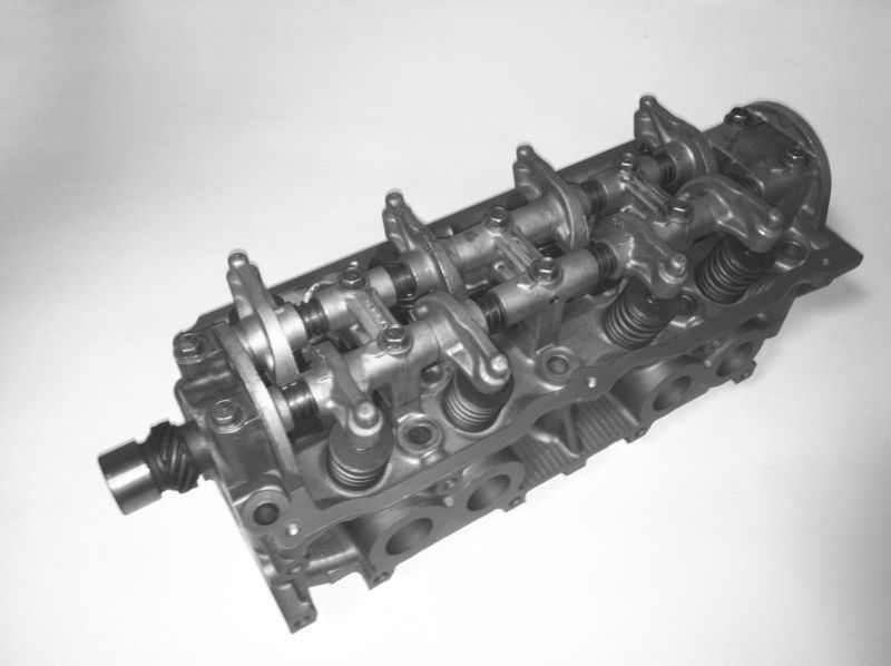

So if im right...
this is a hydraulic head and
this is a mechanical head. Mine looks like the first so it must be hydraulic.

I'm not getting any images

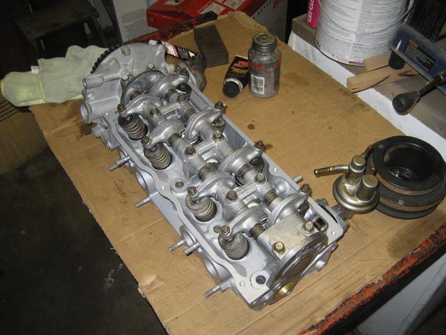

watster9's avatar
watster9
Here is a pic of the hyrdo head on CL
