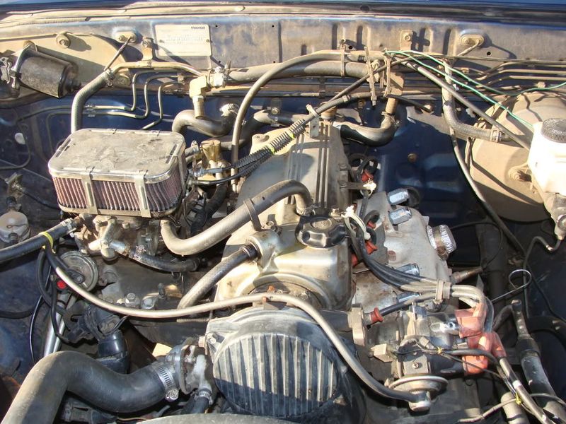

elec choke.... kid i jus bought this truck from hadda wire from the end of the choke sylinode(cant spell) going no where, as i see no other locations for a choke cable or anything, im assumin elec choke, where should i run that wire?
and secondly, kid also has line from pcv valve just capped.... shouldnt that need to breath?

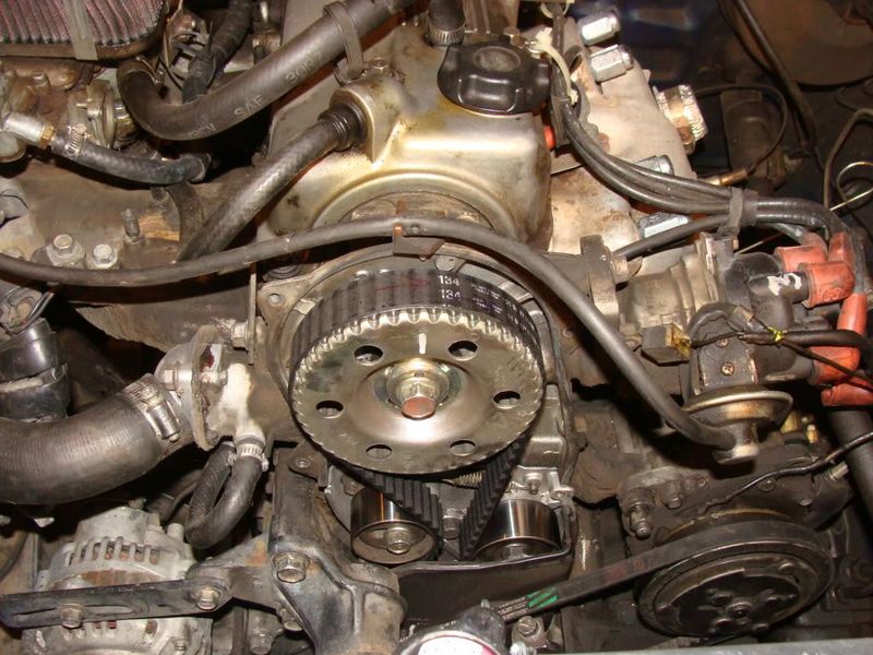

There should be a hose from the PCV valve (forward of the oil fill cap) to the intake manifold; the front of the lowest Weber adapter plate likely had a part ground out larger by the installer to get that to fit. The valve cover vent (rearward of the oil fill cap) should connect to the air cleaner housing.
See these photos
