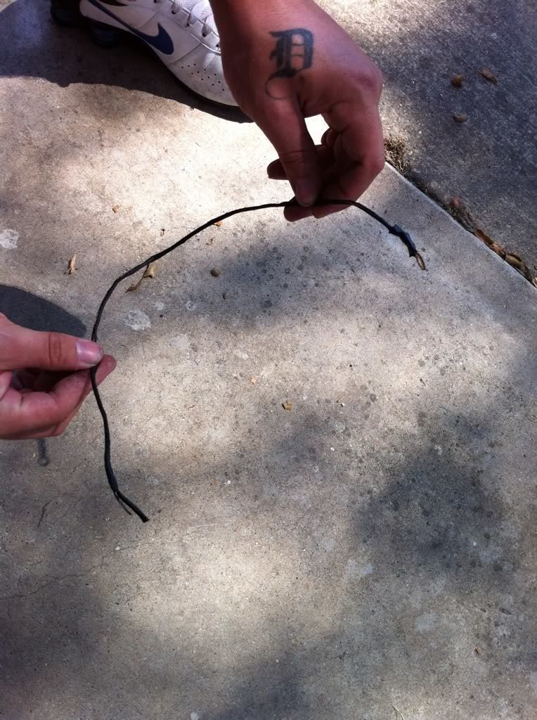

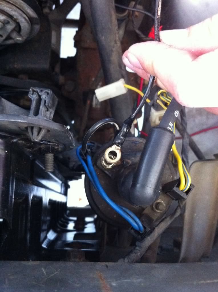

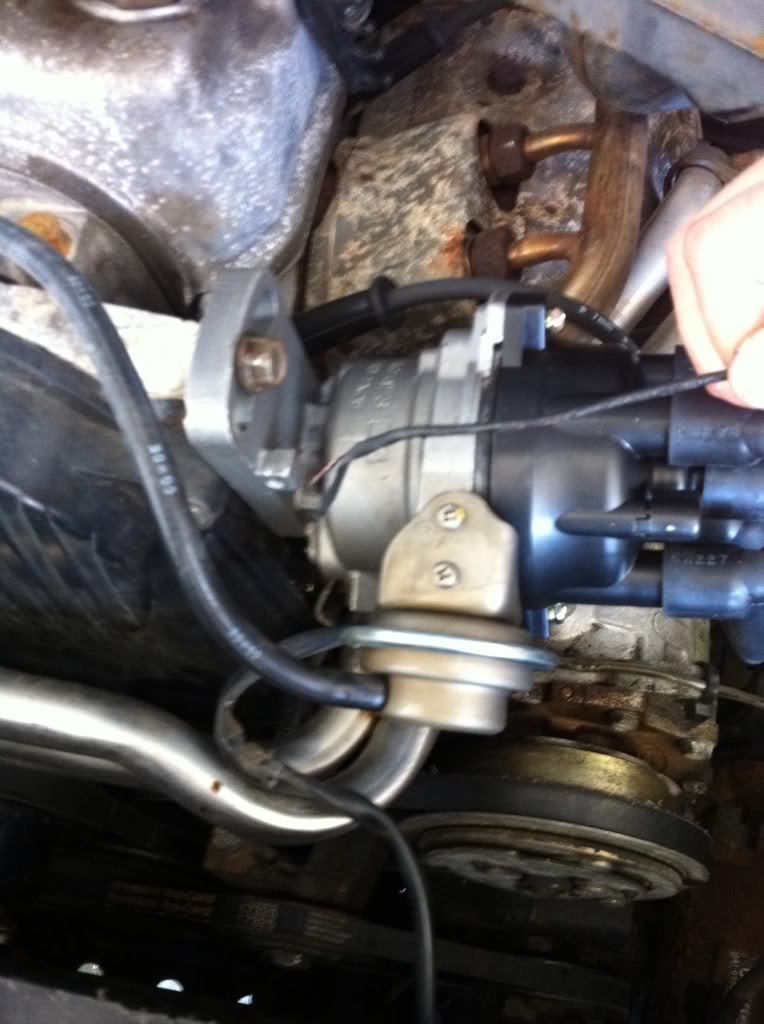

Ok so I got that problem sorted out now I need help with this. What is it? It runs for the ignition coil to the distributor with a little black box on the end...someone please tell me what this is
Cusser's avatar
Cusser
That's a radio noise suppressor, believe it helps more with AM. It's not necessary for the truck to run.
watster9's avatar
watster9
HEY i just had problems with my truck running and that "suppressor" turned out to be the problem. It had a bad connection at the block part that connects to dist. so i carved out some of the rubber part where the wire attaches, resoldered and it pretty much fixed everything, now I just need to clean the carb. PM me if you need more help. Good Luck
