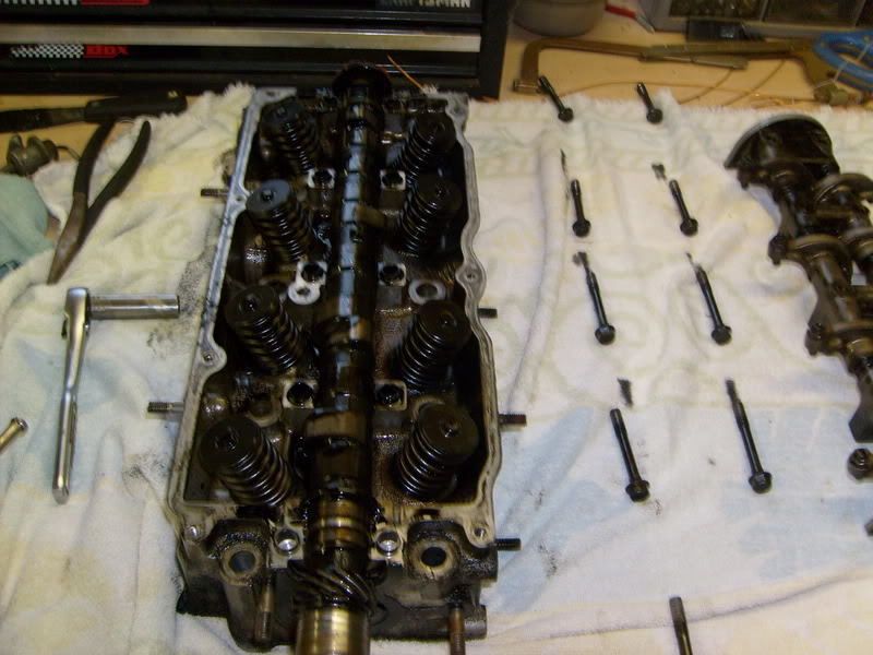

1st step. put your b2000 head on your work bench
2nd step. pull the rocker arm assembly off and lay it to the side

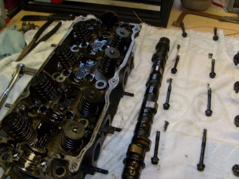

3rd step. pull out the cam.
4th step. inspect the cam and rockers for gouges or deep scratches or things not suitable to put in your engine

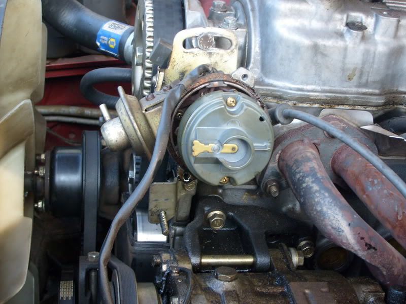

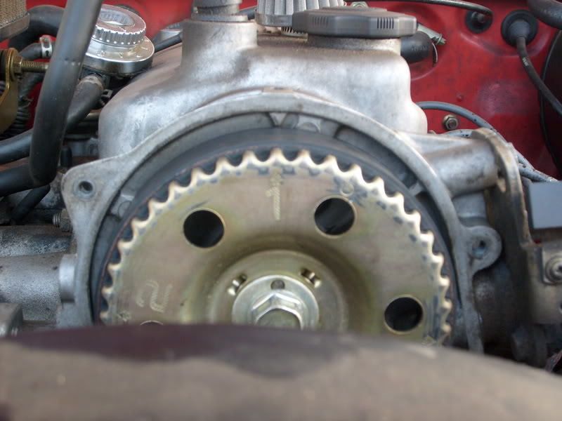

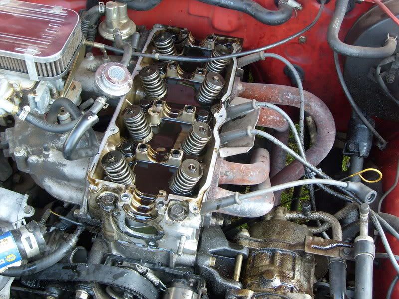

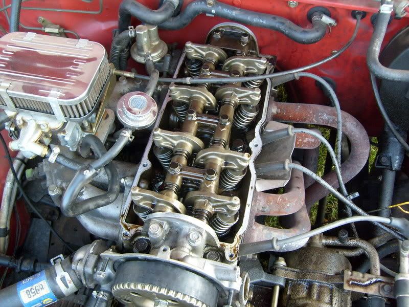

5th step. go out to your 2200 engine and make sure your engine's number one cylinder is sitting at top dead center.
6th step. pull your valve cover off

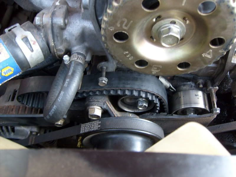

7th step. pull your timing belt off lay it to the side. pull the timing gear off of the cam and unbolt the front housing on the head.
8th step. pull your rocker arm assembly off and cam out. may be a small pain if you have a mechanical fuel pump. but should roll right out.

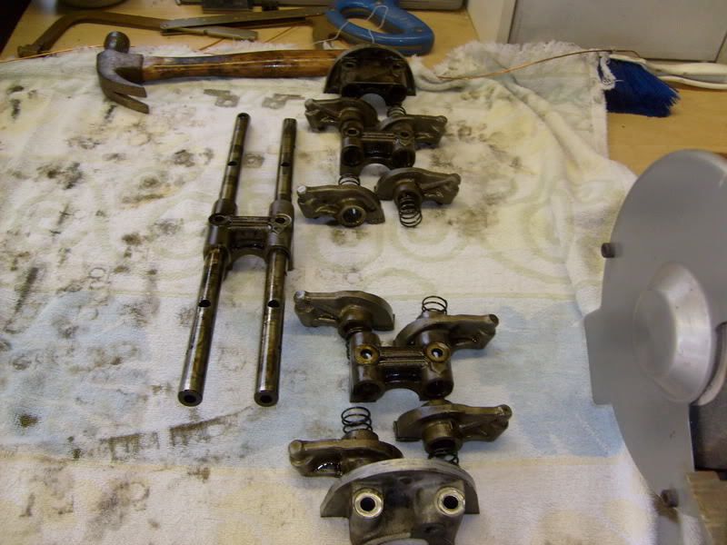

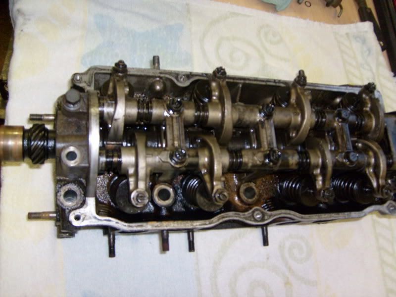

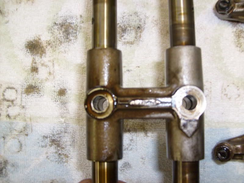

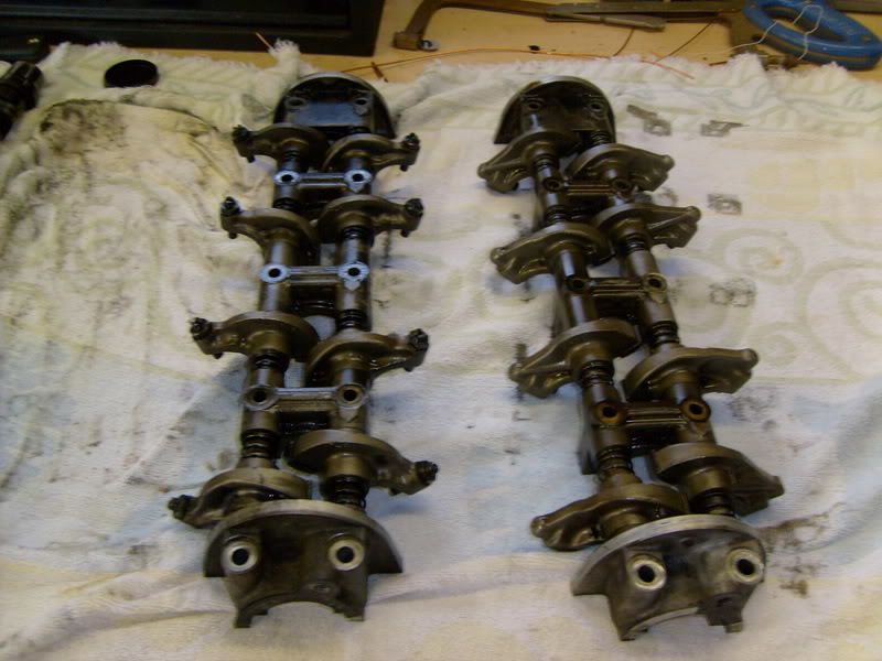

9th step. take the rocker arm assembly in and lay it on the work bench beside the solid assembly. in picture solid on left and hydro on right.

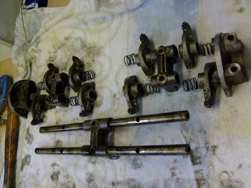

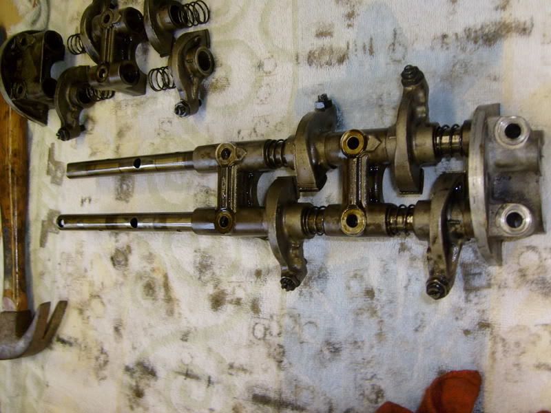

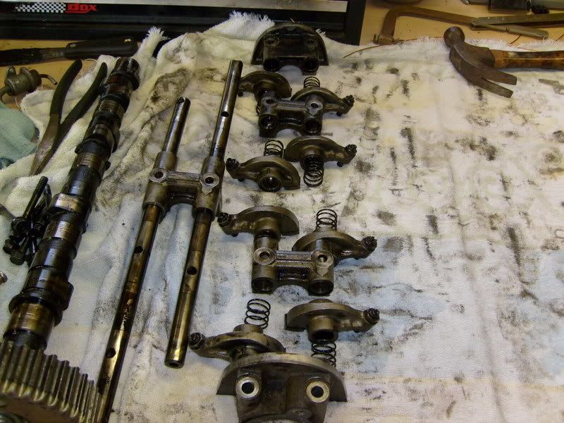

10th step. carefully disassemble the solid assembly and lay it out exactly the way you took it apart. very important you don't mess the order up
11th step. do the same for the hydro setup
12th step. carefully swich the solid rockers with the hydro rockers one at a time. until all of the solid rockers are in order with the caps you took off of the b2200 head. this is important because the caps were machined to fit that head and need to go back the way they came off.
13th step. put the assembly back together. making sure that the holes in the slides are lined up with the caps.

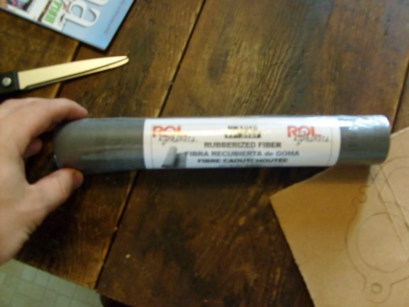

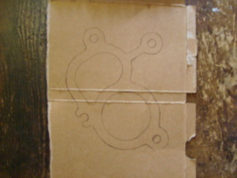

14th step. trace out the gasket that goes between the rocker arm assembly/head and the front housing. the reason i say this is because you cant buy it as a single gasket even through mazda. you can go the local parts store have them pull out a headgasket set pull the gasket out and trace it on a piece of cardboard.
15th step. cut it out exactly the way its traced and lay it on some rubberized fiber that you can pick up at the parts store while your there. trace it out and cut it out. this is now the new gasket. you may want to make a few of them because they tear easily. i got mine for like 5 bucks, and now have plenty left over.

- make sure the cam is pointing at top dead center when reinstalling that way timing is easier.
