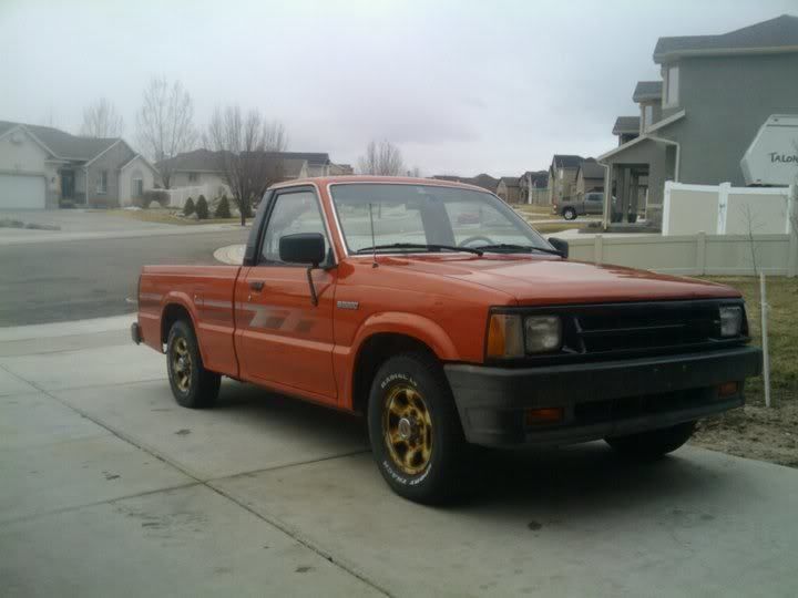

glad to hear man. nice find for 500. post some pics, were all pic whores. lol

next-- gonna start gettin it bagged.
