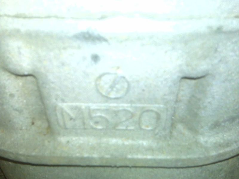

Personally on the gas engine I shifted at around 2800 rpms. anything above 3500 and it sounded like it wanted to grenade. Here's how you can tell what gearbox that you have. Take a look at the center portion of the transmission. The mazdas 86-93 factory came with the M-519 gearbox. The 86 didn't have this stamped on it but the 87-up did. Here's a M520 gearbox (from a bongo) showing where it would be stamped on yours.

I looked under it today, M-519, so i guess they put another of the same tranny in...
