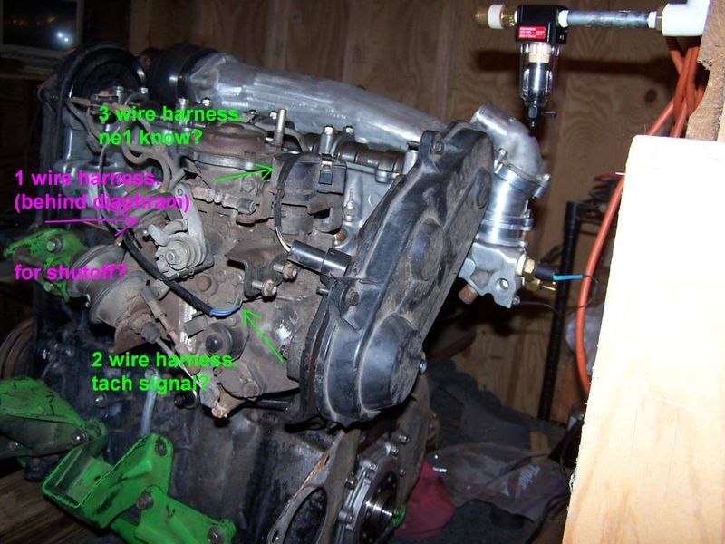

emjay
For the ford escorts there is a sensor on the IP that sends a signal to the tachometer. Since it is a 4 cylinder it is possible (in theory) to wire this sensor into the Mazda factory tach. 84-87 Escorts, 626, topaz, and lynx diesels all had tachs from the factory. Here is a pic of the sensor on the RF IP that I am using in my diesel build:
I'm still working out a lot of bugs in my setup and don't have it running as of yet but if I figure out how to use it then I'll share my answers with y'all.
