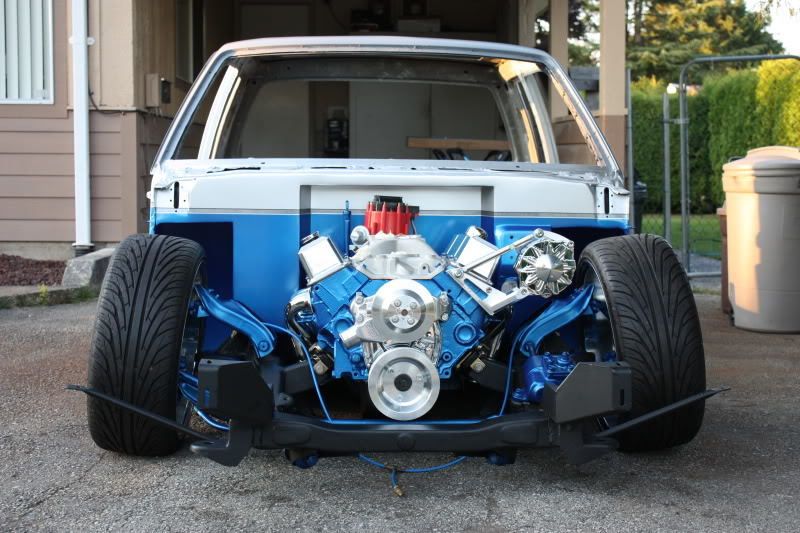

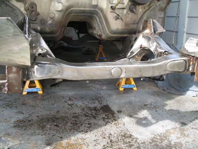

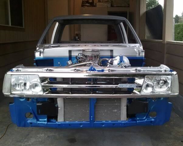

Been working on this for the past couple years, after coming home from a show last year the stock motor started to knock so figured my not stuff a small block in her lol.. My name use to be Bick on here if this looks or sounds familar....

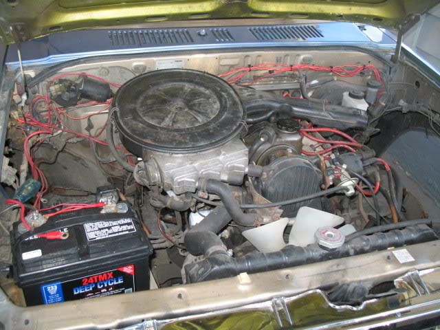

This is my Mazda before stripping her down

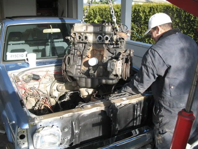

Stock as she comes blown mazda motor

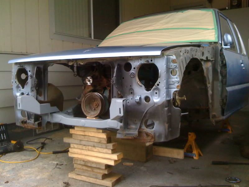

Me and a friend pulled the motor and scrapped it for parts
Looks like theres alot of work ahead for me lol

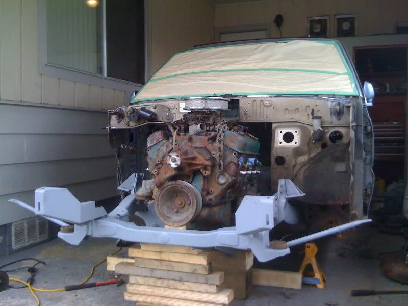

Getting ready to cut the firewall and make room for the 305
The motor ill be using, out of a 80's cutlass.

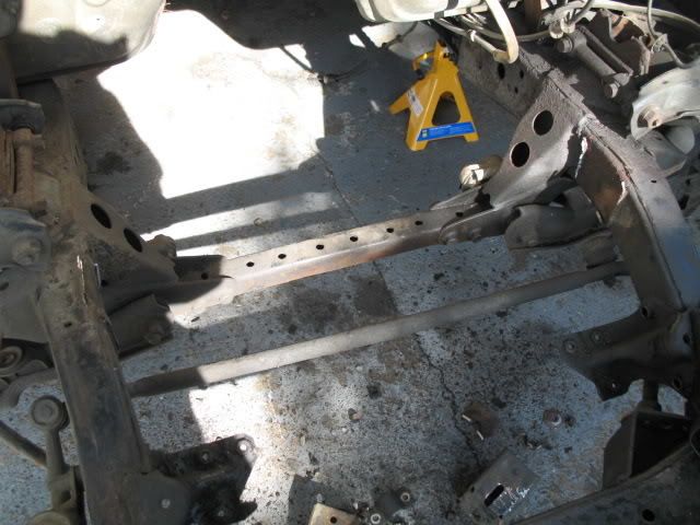

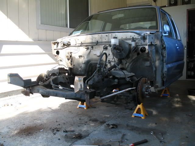

Cut the old motor mounts out
Cleaning up the frame, welding all the factory holes smooth
More smoothing out

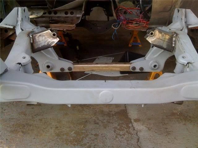

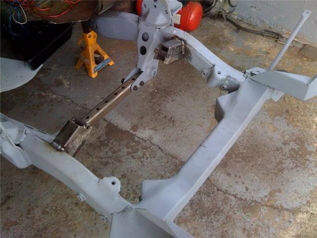

Now time for new motor mounts to hold the V8
In place on blocks doing alittle test fit
Hood still closes looks good here so now time to make the mounts

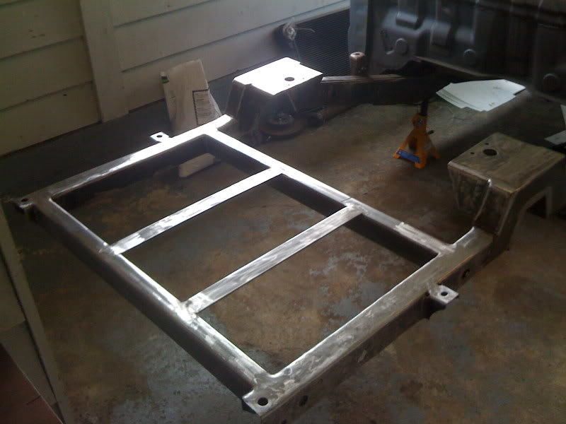

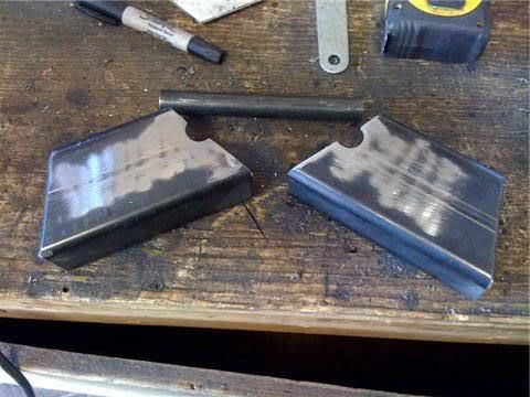

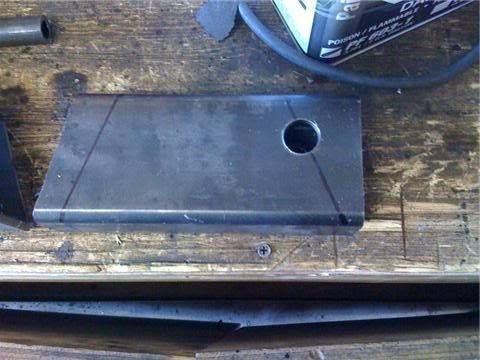

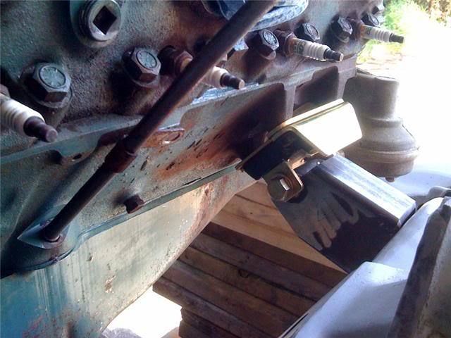

Start of the mounts, pretty basic and will do the job.
Now time to weld in the round tube for the bolts
Energy suspension motor mounts to help with vibration
Welding motor mounts now.
After welding is done ill cap the openings of the mounts

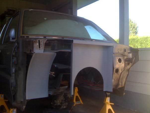

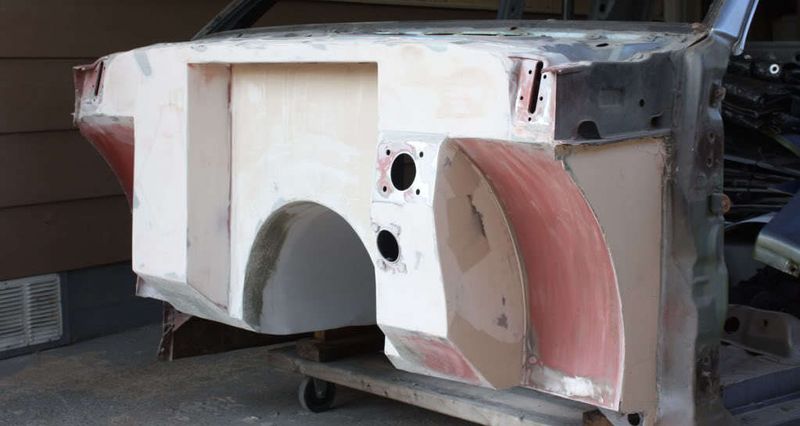

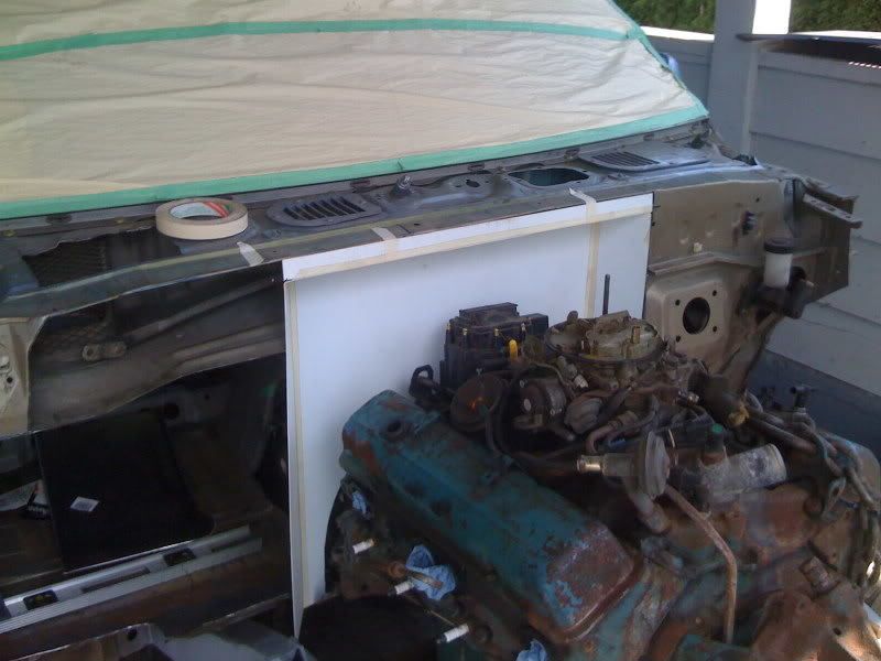

Alittle firewall mock up with plastic sheets that ill use as a template

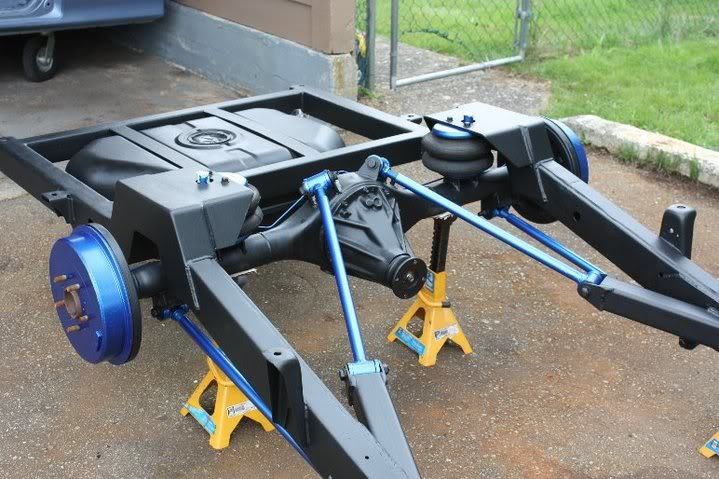

Time for a new gas tank
Using a 90's blazer gas tank that will fit in here now

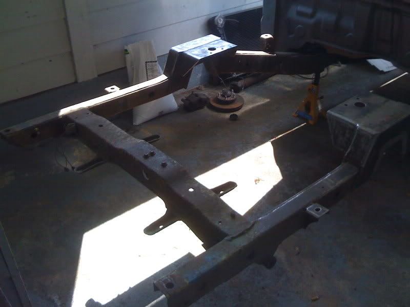

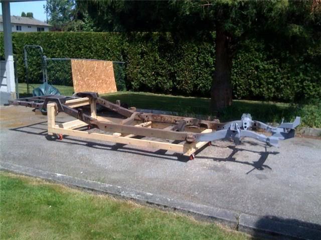

Frame ready for sand blasting and so on lol

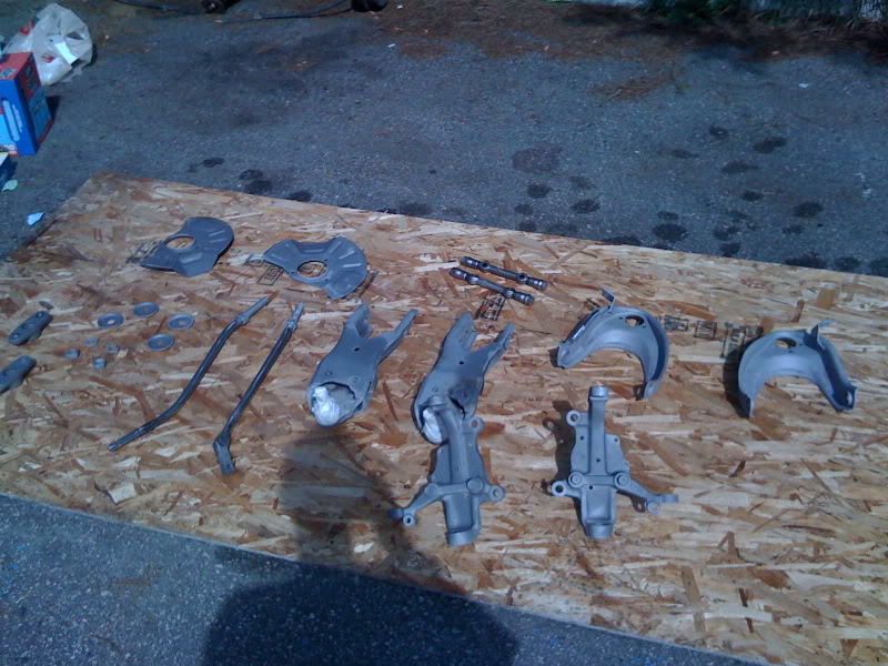

Parts sandblasted ready for high build primmer
In high build ready for paint

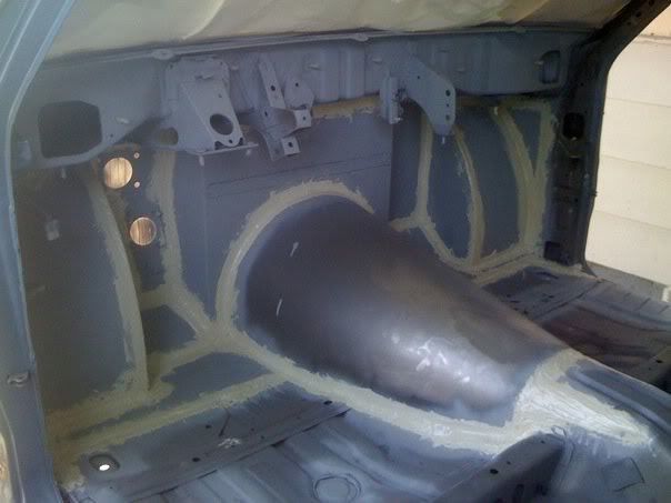

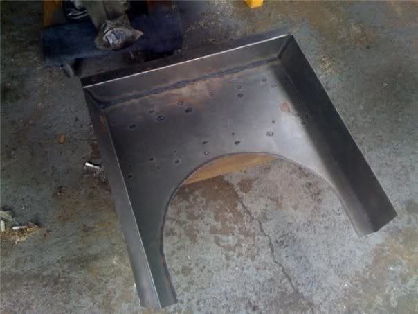

Section of the firewall ready to be tacked into place
Starting the firewall fab

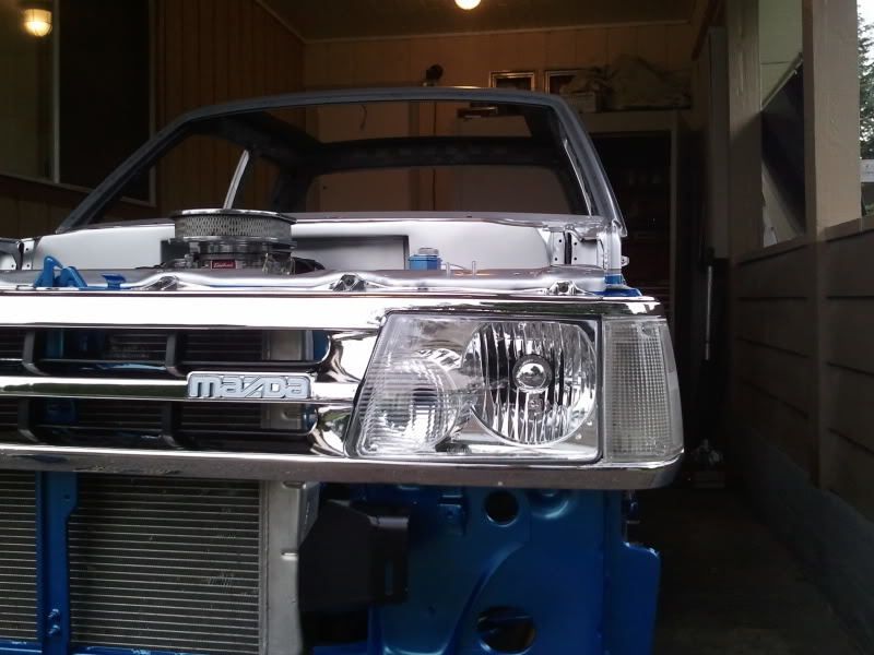

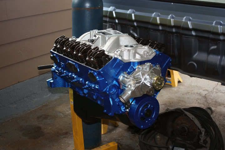

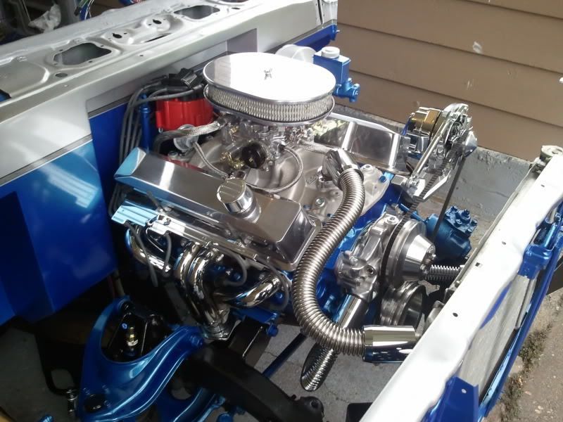

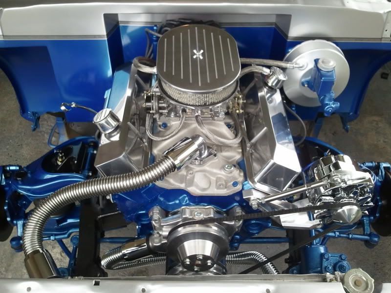

Rebuild the motor and sprayed the block to match the new body colour ill be going with

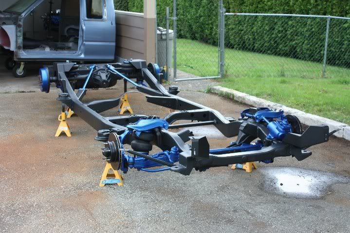

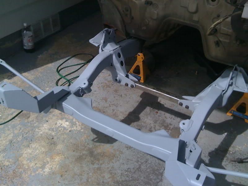

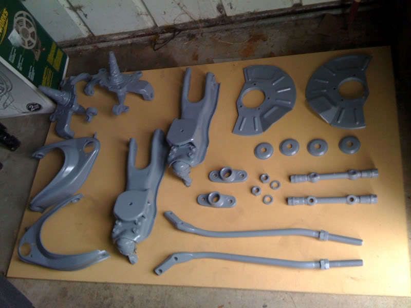

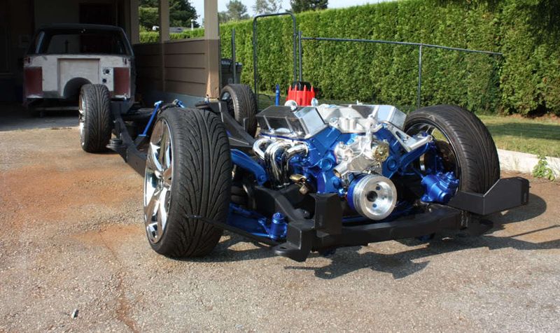

Got the suspension and frame painted and back together
Installed 4 link I fabricated and new tank installed
