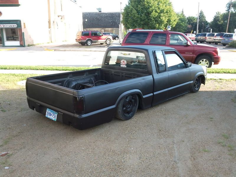

Well I changed the thread title 7/13/10 from project low dailly b2200 only reason is because I changed my mind on a lot of things especially since I was only going with a big static and ended up bagging it.

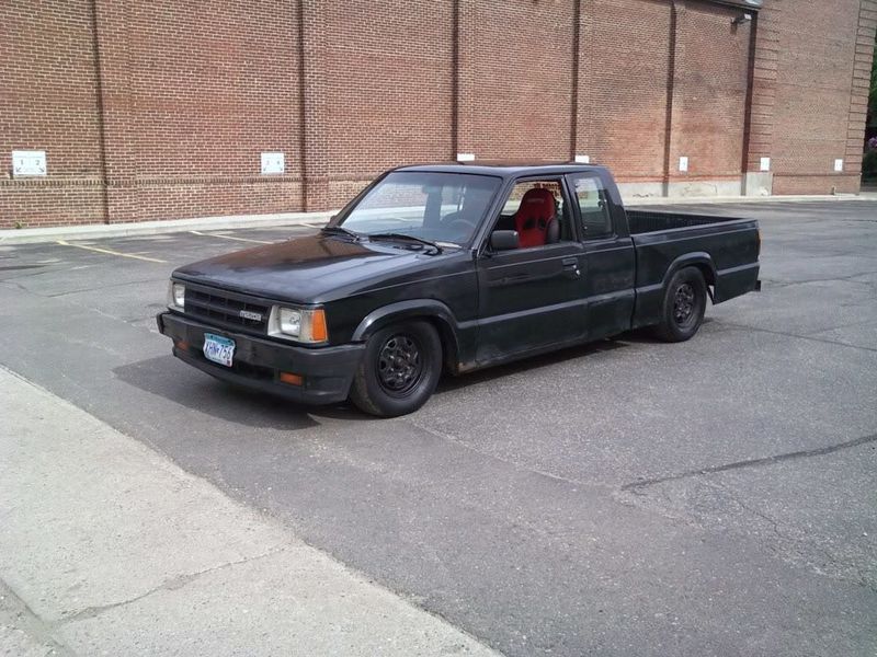

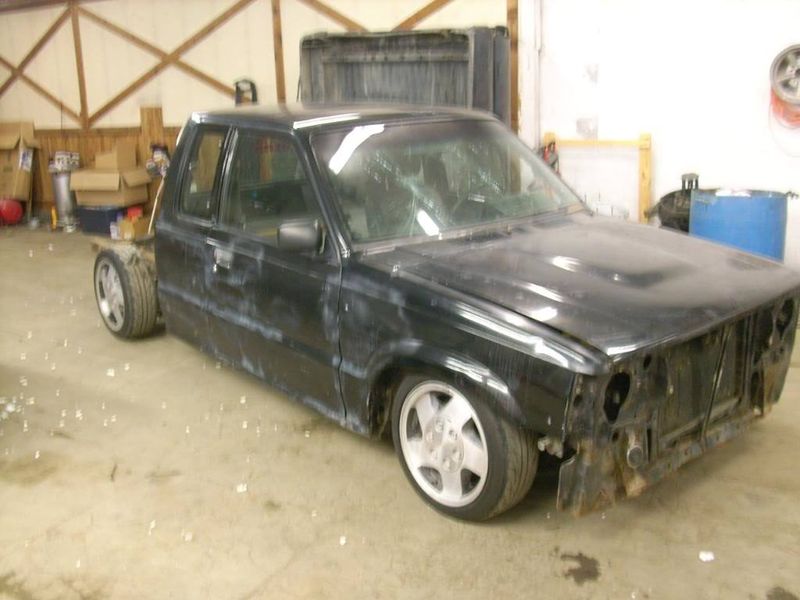

Well I figure I might as well start a small build thread even though its nothing major.

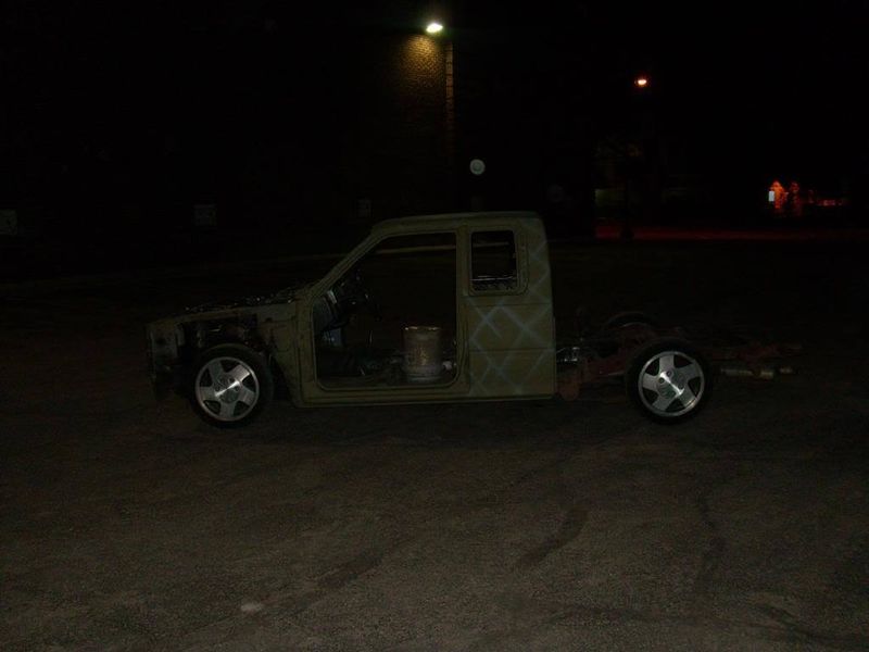

1990 B2200, I dont have any stock pics or pics from lowering it but Ill list whats been done and the plans for it.
Stuff done already
Front removed wheel wells, reindexed torsions, extended shock mounts and chevy luv shocks.
Rear monoleafed with overload, 3" blocks.
Motor has been replaced, all new gaskets and weber carb.
Swapped boxes with a cleaner box from a B2600i 2wd.
Z71 wheels with dunlop tires.
Dyed carpet and rear seats
B2600i hood
Plans are small c notches and 4" block
Change the way the extended shock mounts are
Different wheels eventually
Shaved handles and relocated tailgate handle
Chrome grille with 01 ranger headlights
Toyota bumper with the valance color matched
Roll pan
Painted sapphire blue pearl
Factory chrome trim
Enough talk, everyone loves pics Ill try and get some engine bay pics tomorrow

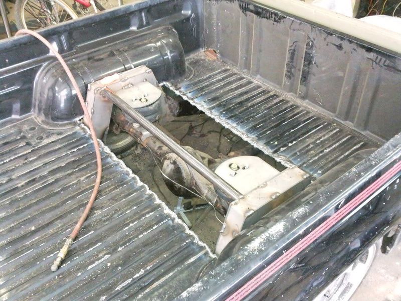

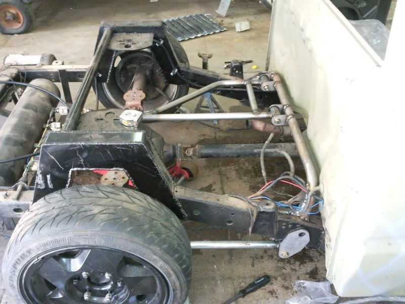

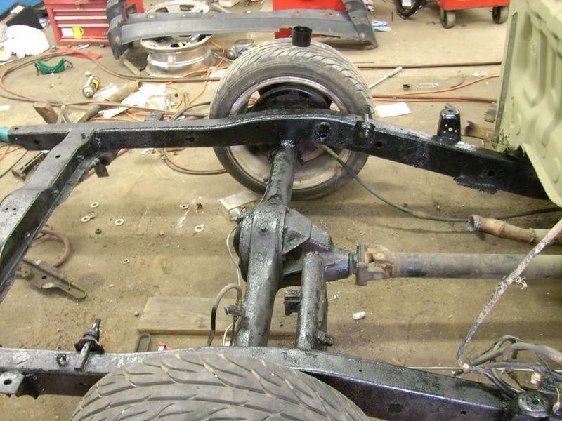

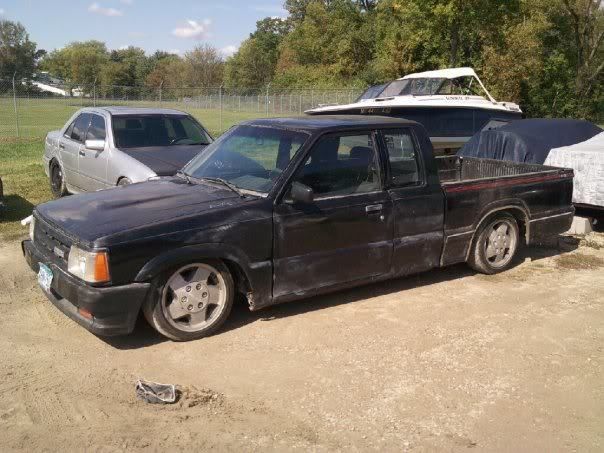

robsgotit

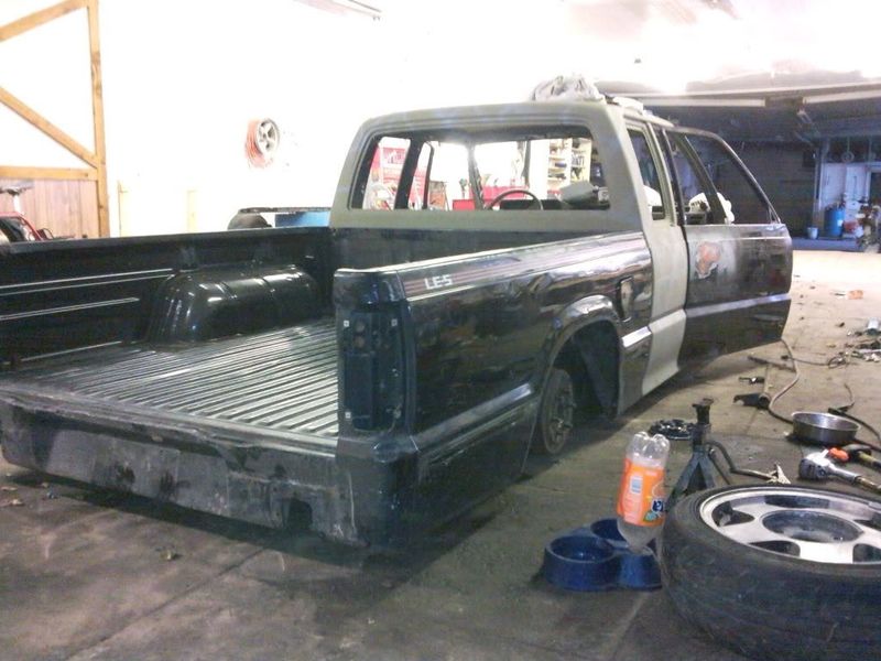

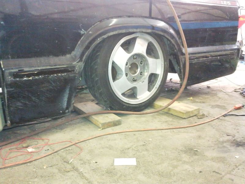

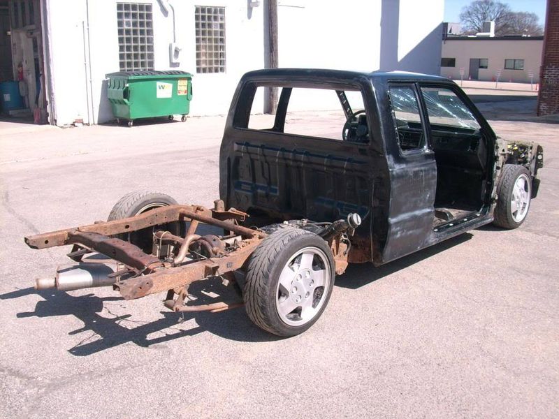

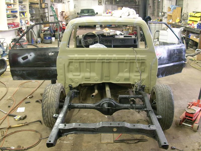

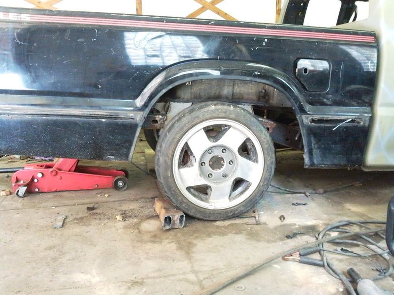

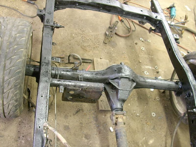

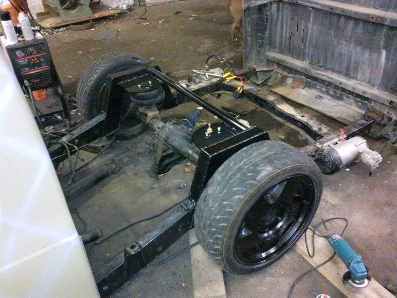

looks good, def gonna need that notch, looks like your axles on the frame.
paparoach1983's avatar
paparoach1983
yeah man nice start.
MJ
mr. jaun durfle
Yep that rear axle probably sits about an inch under your frame. I thought about four inch blocks for my truck until I looked under there and saw how close to the frame the axle would be. Are you going to keep it as a static drop or bags in the future? Looks good so far, keep us posted.
lsonboost
Thanks guys, yes with the box on I have 1" of travel. As for bags I am not sure I guess I will see what the future brings, I love slammed statics though I get asked all the time if im bagged or not.

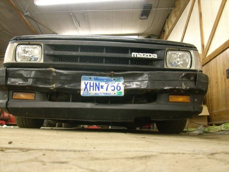

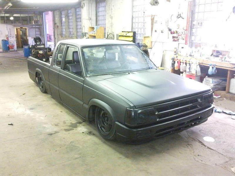

mazdadropped
nice build , looks a little rough tho
skrapinsask's avatar
skrapinsask
little rust, smashed windshield and bumper isnt rough!
It's a work in progress!
GL with the build!
