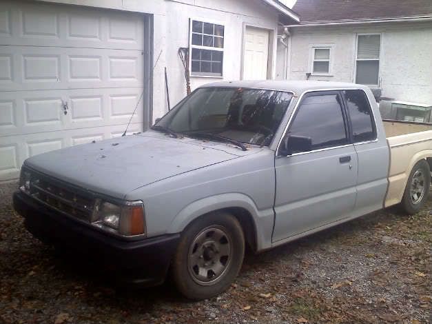

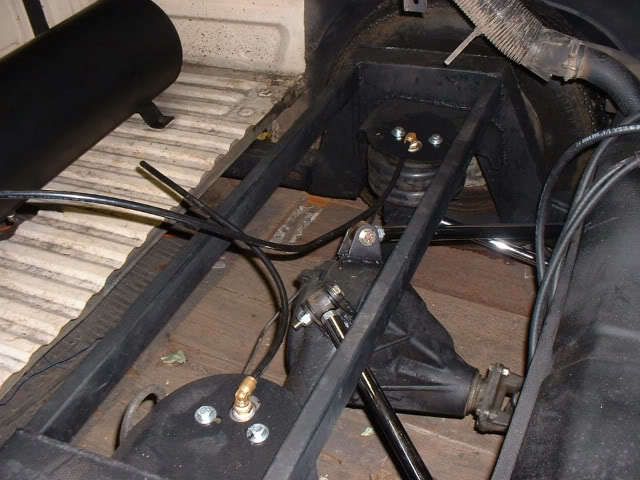

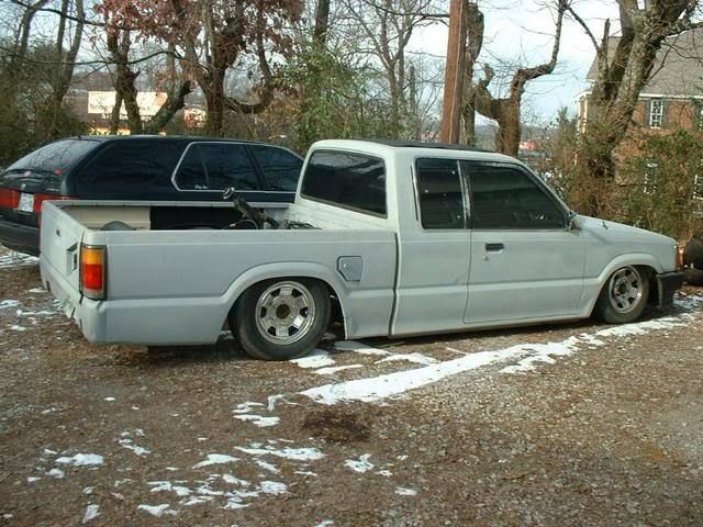

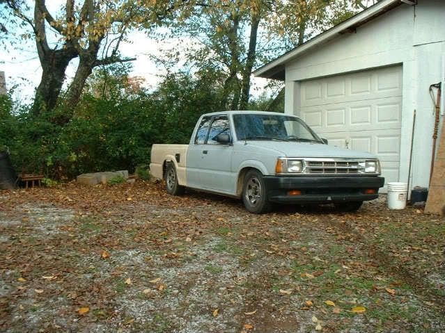

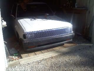

I bought my mazda on oct 3rd, pulled in the garage on oct 10th... Working on bagging it, and shaving will come later... I am going to try to have the back done/and truck back on the road by halloween for some draggin and then back in for the front. I havent even drove the truck yet. besides bringn it home. I'll try to keep this thread updated daily with new pics, or as soon as new things are done...
I will be running re7's in rear, and re6's in the front, chrome FBI 4 link, with bag over axle. I have 8-3/8 valves and 2-1/2 valves, I'm thinkin of buyin 2 more 1/2's and doin 1/2 fill and 3/8 dump. Otherwise I'll prolly use the 1/2 valves on the front with my 3/8 dumps. and the back will be all the 3/8's idk yet. Still need to purchase a couple compressors, I will be getting 2 viair 480's probably. I have a 12 gal tank, that will going in the bed or on the frame, still havent decided.

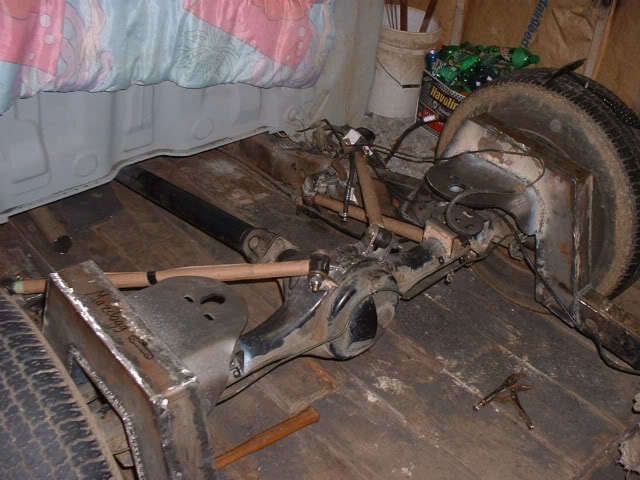

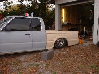

this is what i startd with
Driverside Notch
Passenger Side

Let me know what you think...
BTW this is my first time ever bagging a truck, I have put cylinders on a honda before, but that never involved any cutting, or welding... but i think its coming a long pretty good

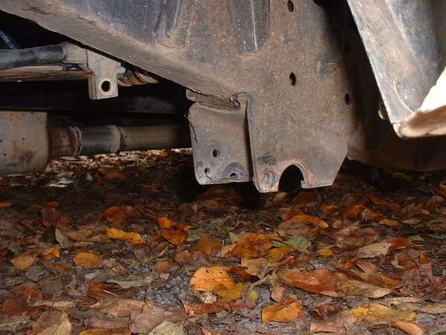

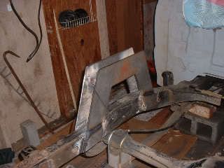

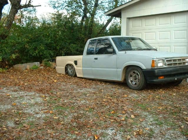

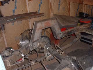

Got the passenger side notch completed today, alls left to do on it is clean the welds up... will be finishing the driverside tmw, before work and starting on the link either tomorow or sunday morning

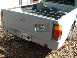

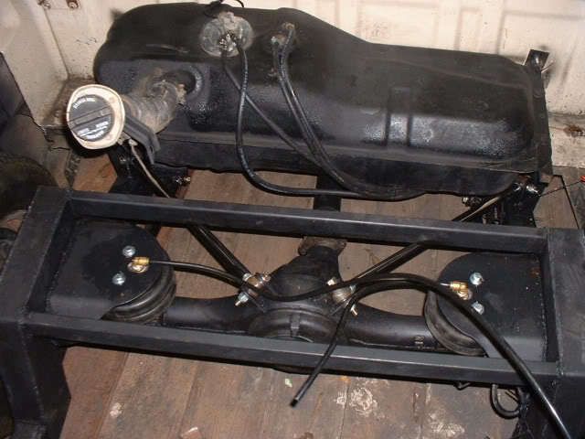

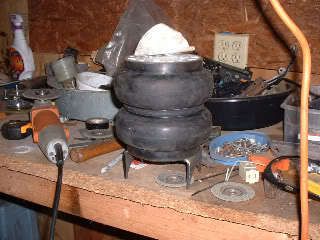

pic time...let me know what you guys think
will be running these in the back

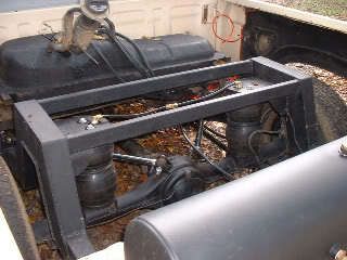

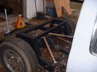

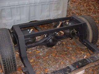

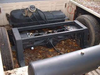

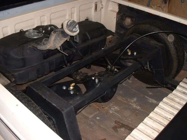

Got my bottom bars tacked up, before work today...gonna put the top bars on tomorow night...
It is an FBI Chrome Triangulated 4 link...

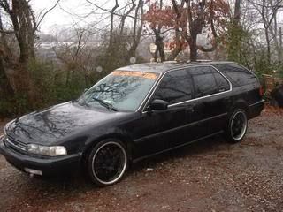

looks like it going good you should post some pics of the accord too
j$c avatar
j$c
thanks man...if i remember correctly I've always seen ur xtra cab, and a nother parked together at shows...one with a suicide tailgate... Really like both the trucks. Actually those 2 are one of the reasons i wanted another mazda.

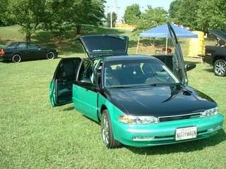

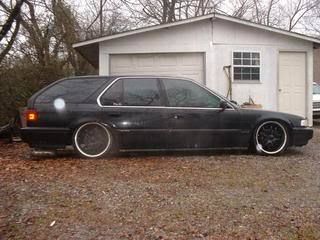

But the Wagon, I had built...I am hoping to the mazda all myself. Paint, Interior, Air, everything...
I'll post up some pics of it tonight when i get back in the house
