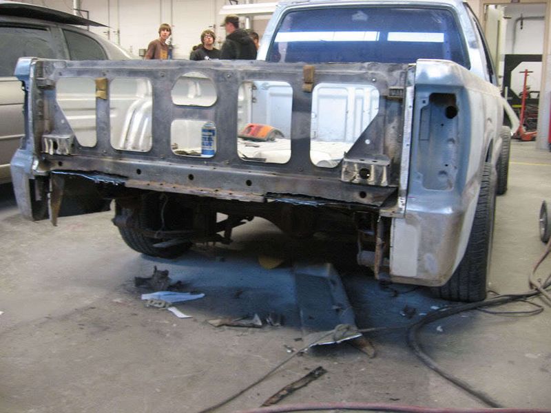

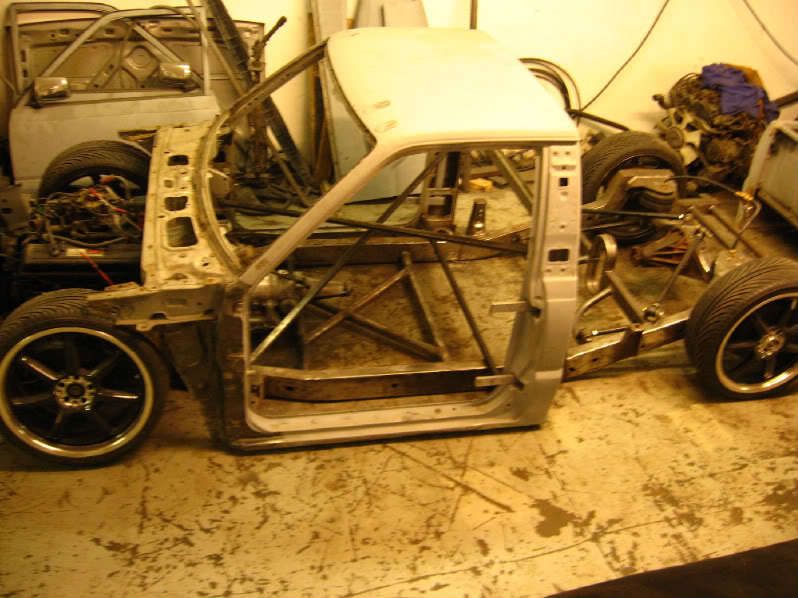

What I've done so far:

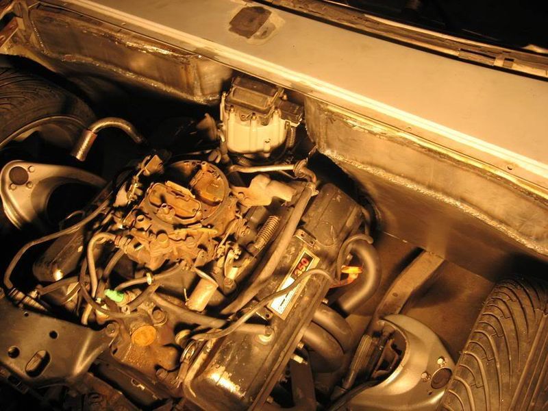

shaved about everything, still a few more body mods i wanna do.
suicide doors
5 lug swap

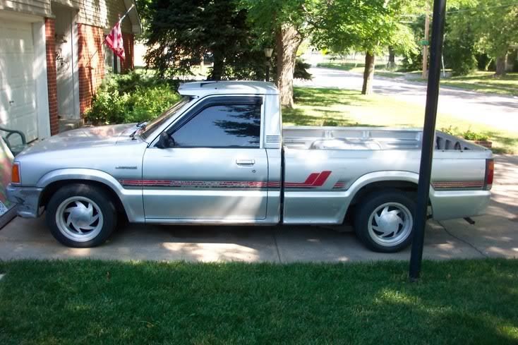

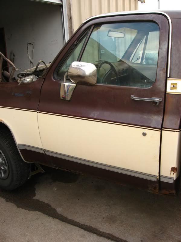

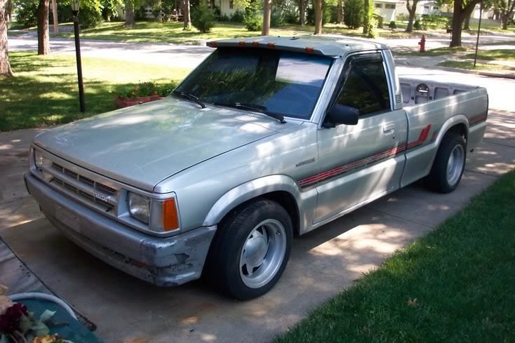

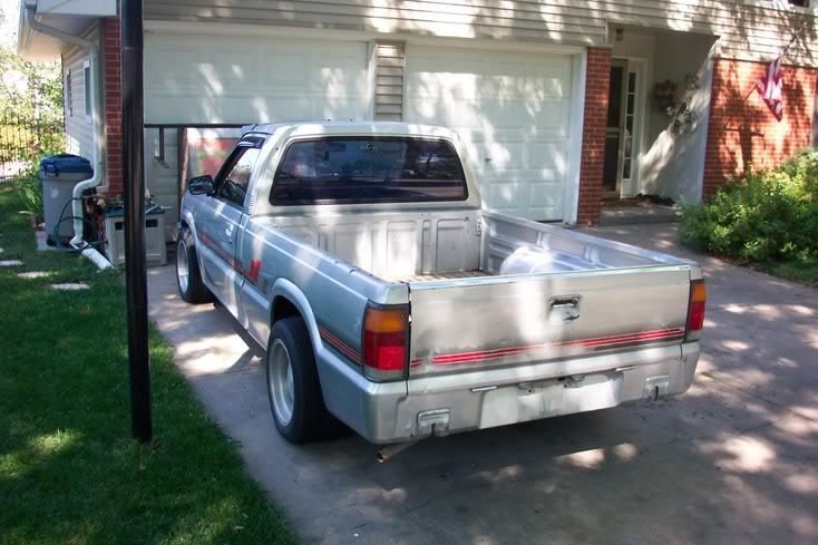

Here's some pics when I first bought it 4 years ago from some mexican:

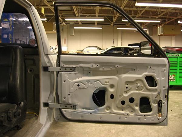

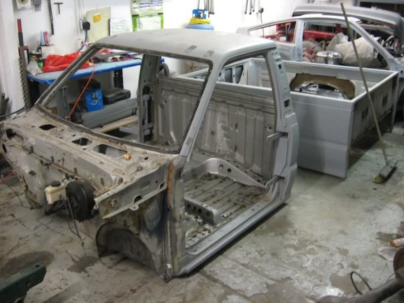

Took it to school where i did some of the body work

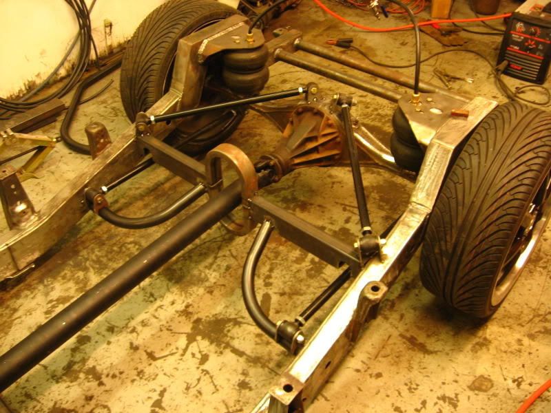

Before & After of the Lower Contol arms.

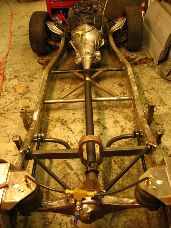

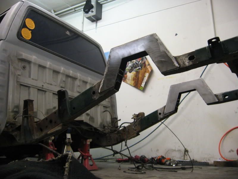

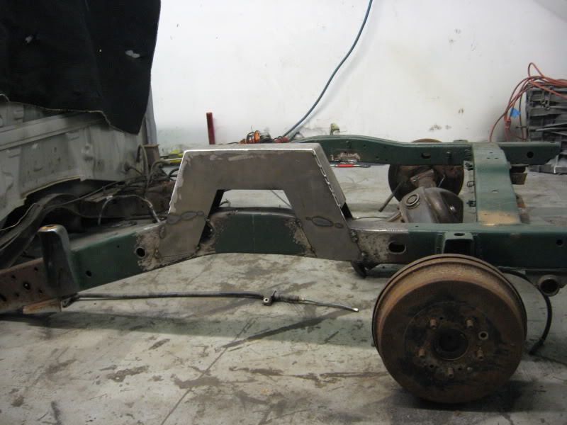

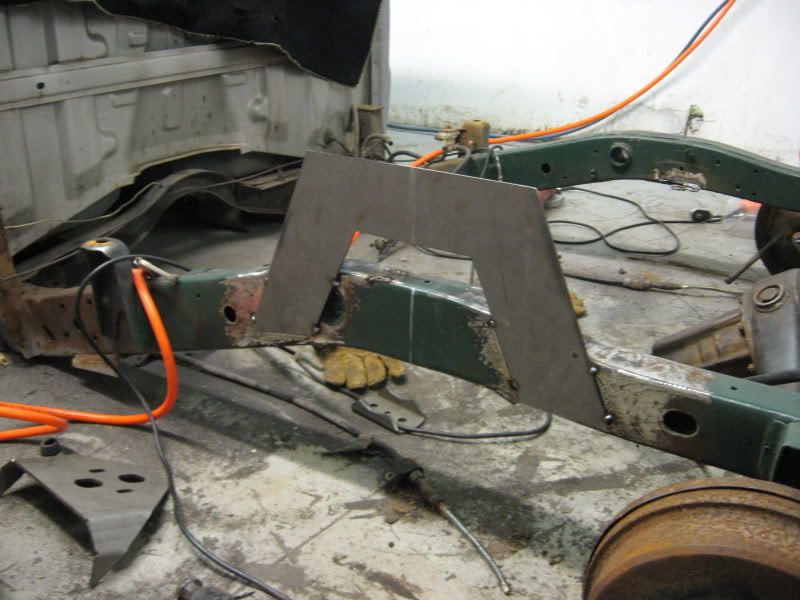

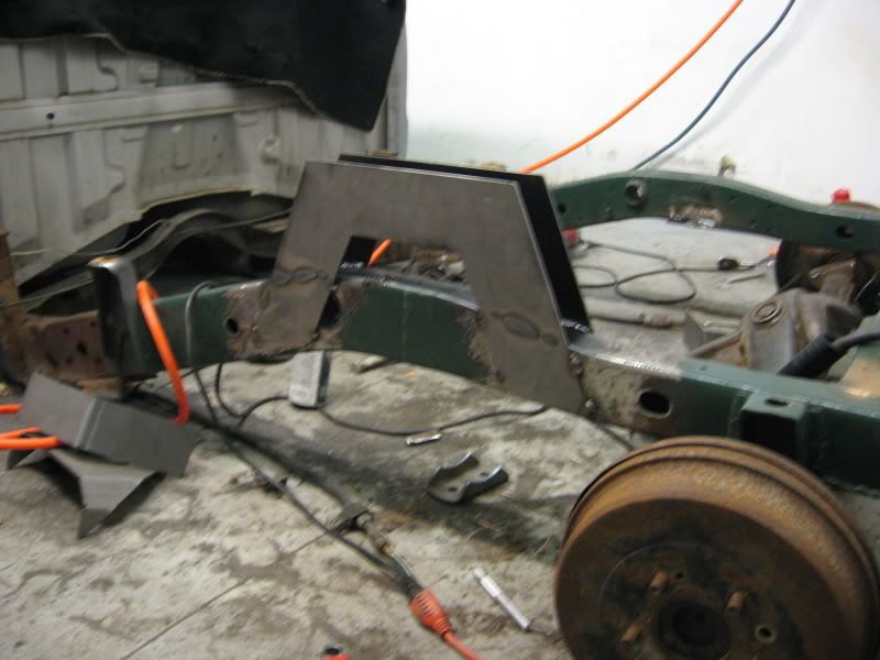

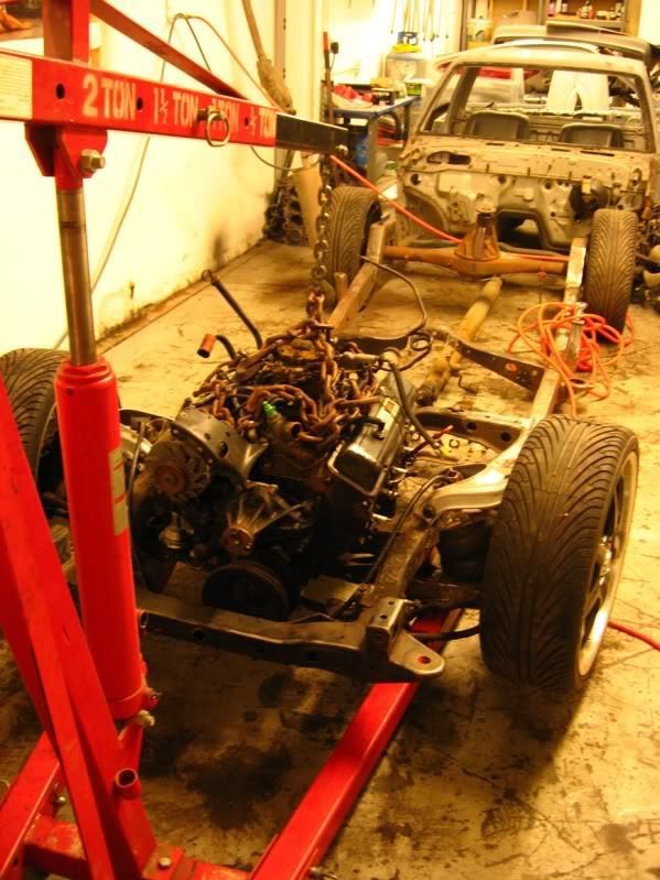

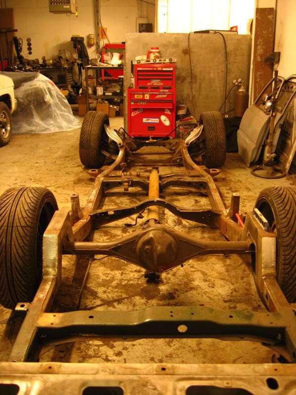

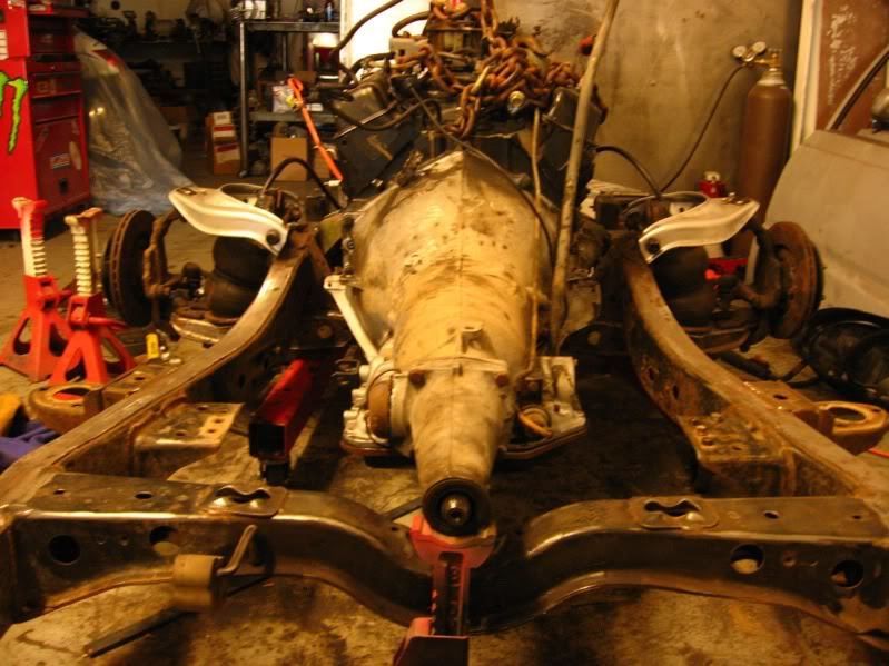

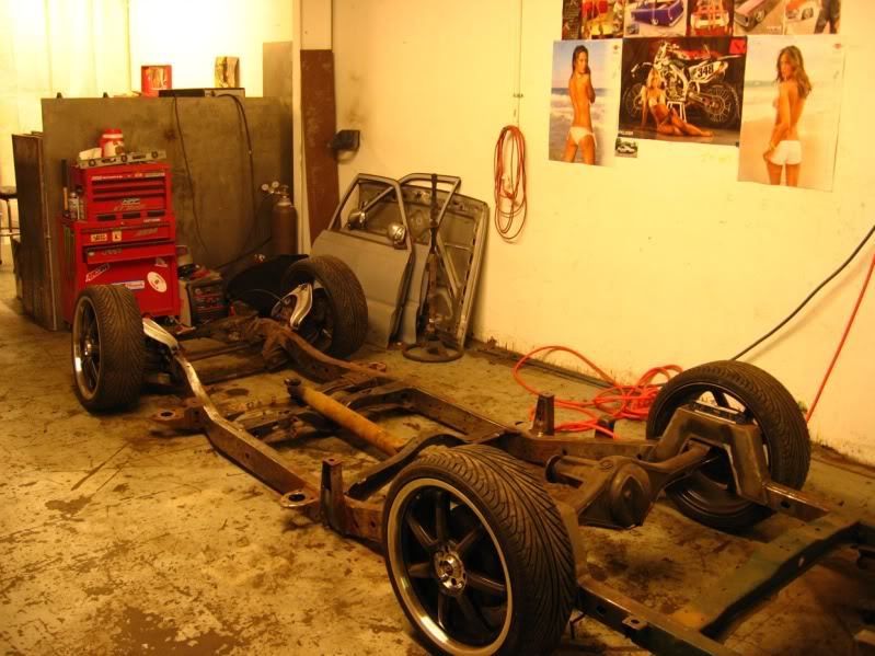

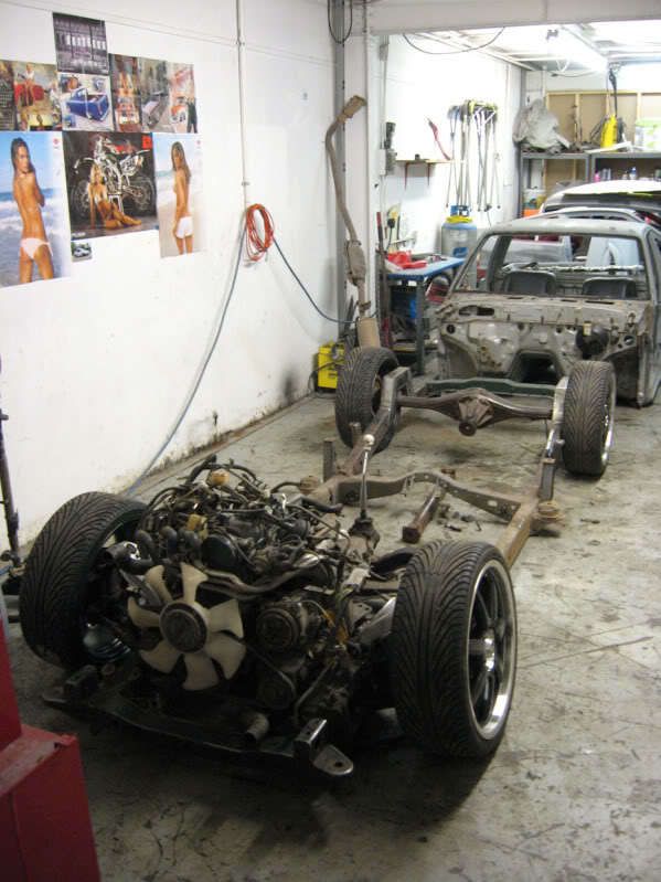

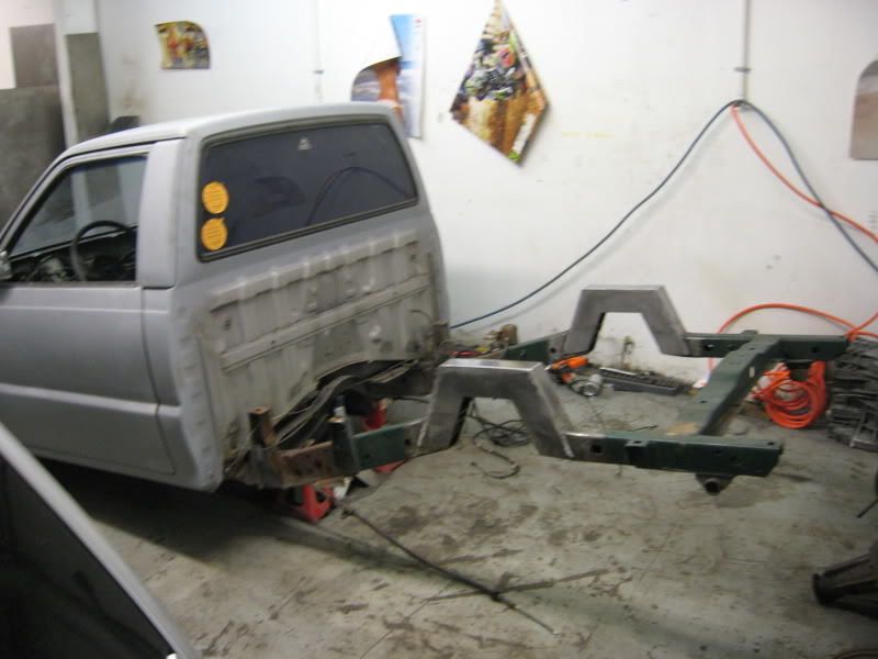

Here's a picture of it 2 days ago. I got it out of my tiny garage with no lighting and pushed it 7 blocks to my friends bigger shop. Today I started c-notching the frame.

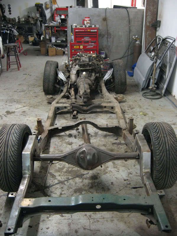

what kind of wheels are those? lug pattern? is that a different rearend cause it looks narrower.
speedster93b's avatar
speedster93b
i hope you kept that sick asss visor!!!
meesh's avatar
meesh

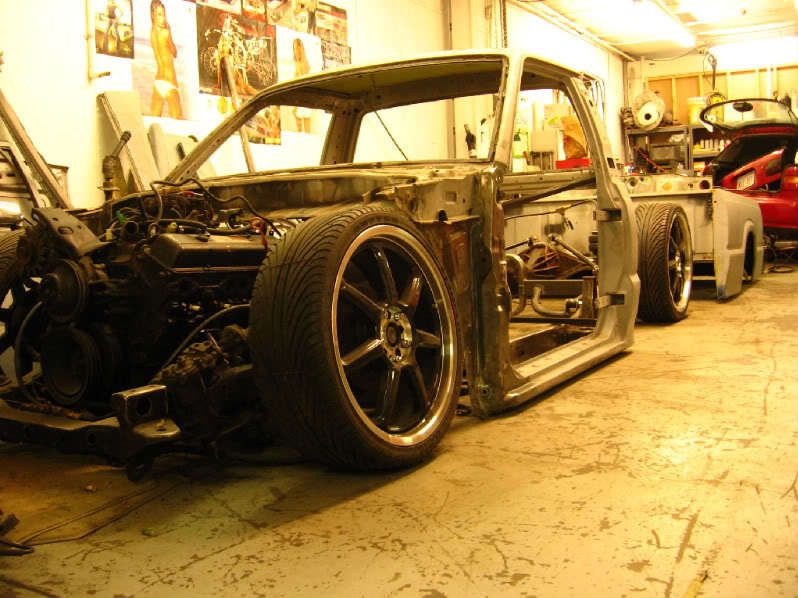

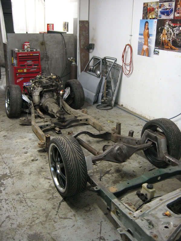

ADR wheels (19x7.5), i got them off ebay brand new and they came with tires and were balanced for really cheap. 5x4.5 lug pattern.
IT's a 1985 toyota rear axle, The '79-85 rear axles are 55" wide. and my wheels have a 40mm offset so there's only about 1/2 clearance on each side of the frame. but the front tuck perfect and I have so much extra room so I think i'm gonna get drop spindles even though the front is all ready laying the crossmember.
