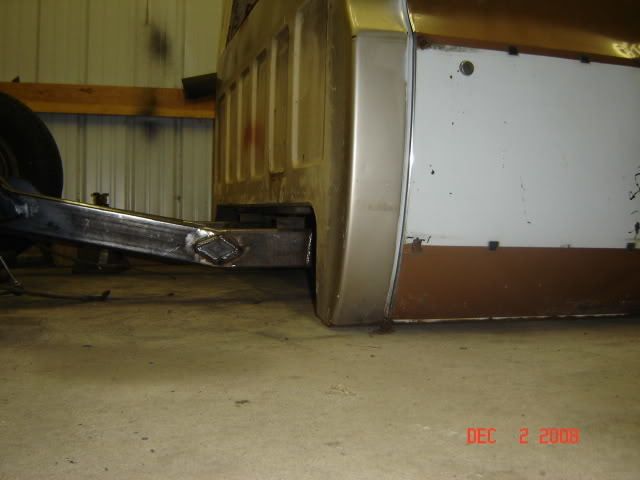

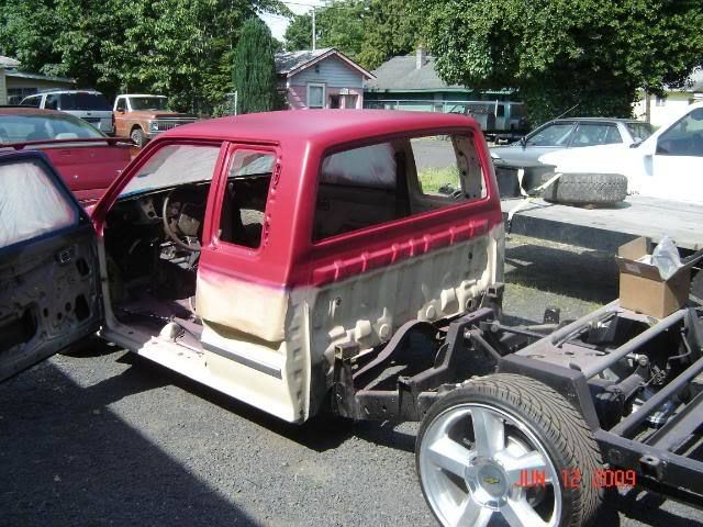

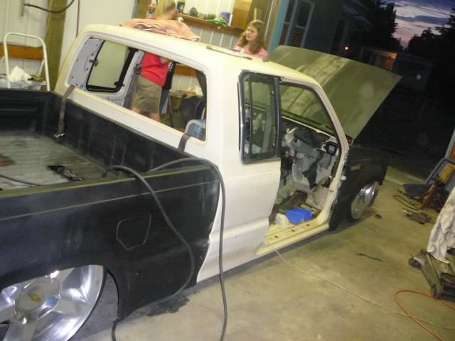

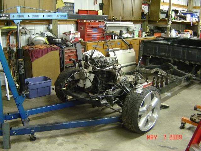

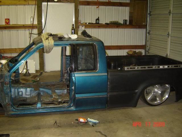

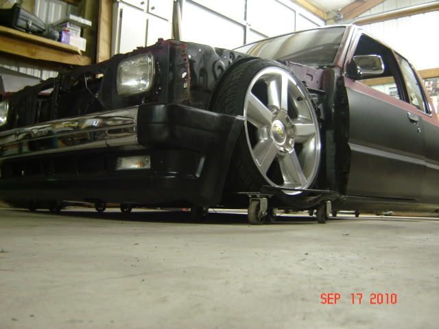

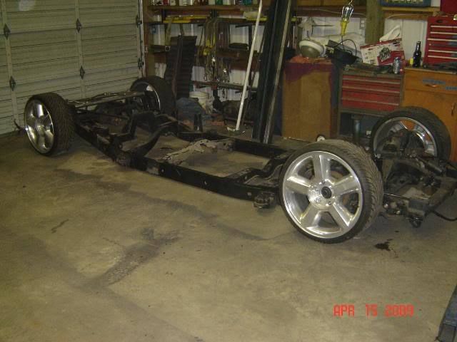

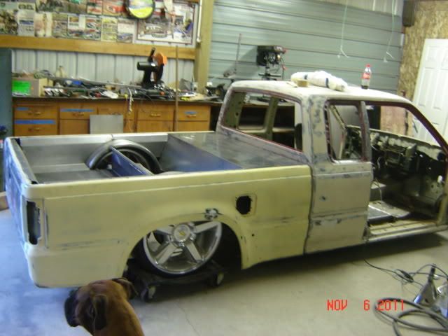

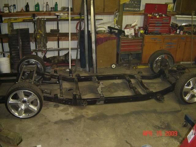

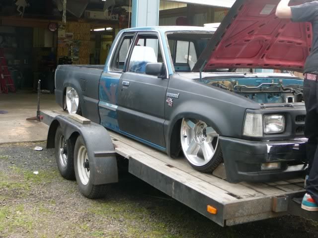

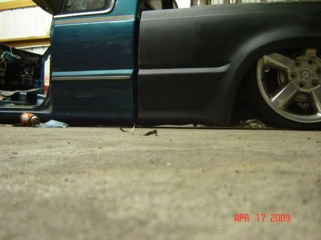

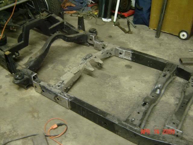

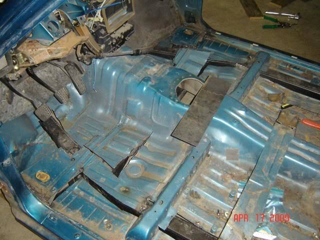

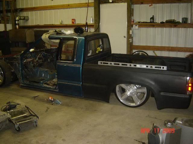

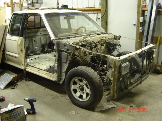

Well crunch time is almost over and I finally got time to post some pics of the stretch. I took a standard cab frame and stretched it 17.5" just before the rear body mount and added in the frame piece that has the carrier bearing bracket from an extra cab frame. Now I have an extra cab truck with a standad cab bed. Also had to Z the front clip 2" to lay frame. Whoever did the BD (not cl chris) on that standard cab just lowered the body PAST the frame to make it sit instead of redoing the suspension.
Well I hope all of you pic whores enjoy and there will be more to come. I started all of this on monday april 13th and am trying to have it fully rolling (not driving) by this sunday the 19th to take to the BBQ in tacoma. See you there!

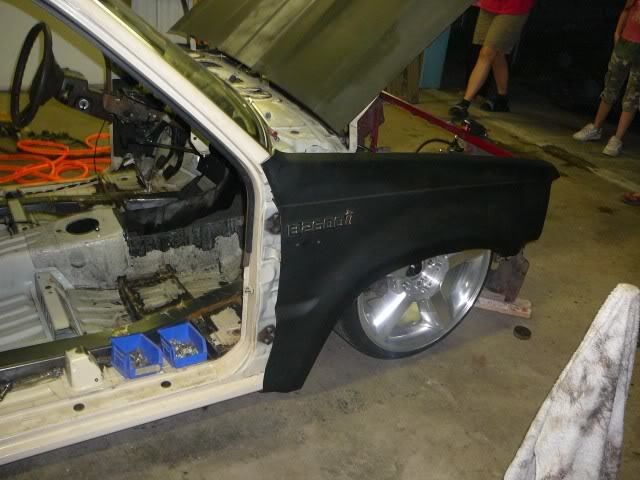

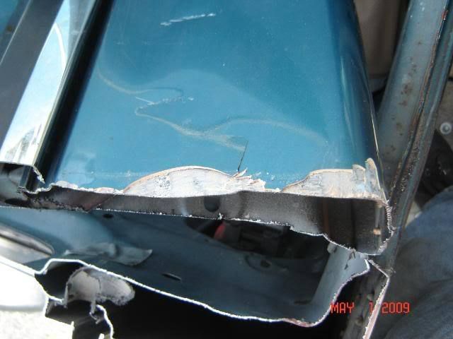

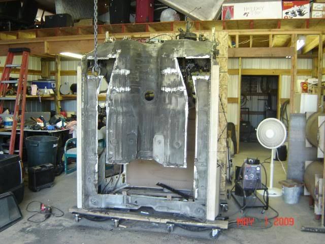

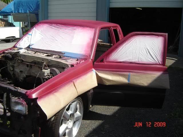

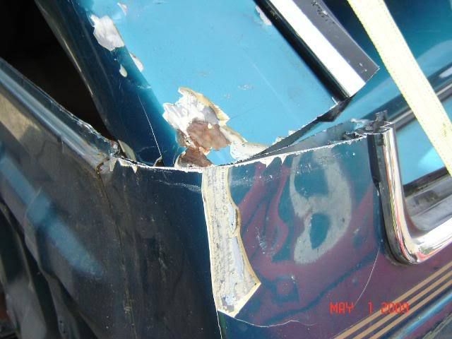

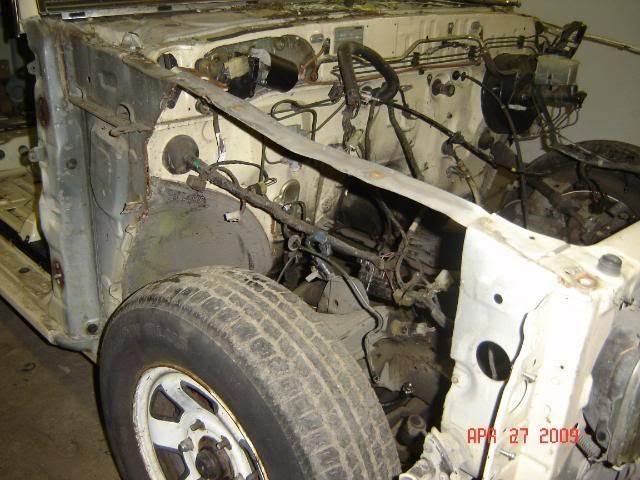

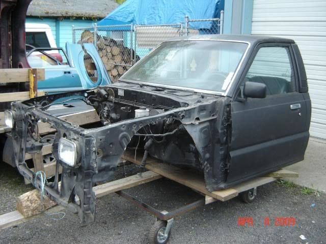

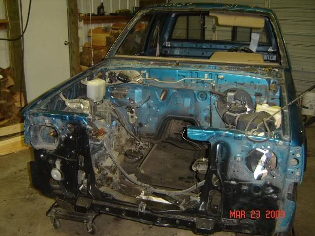

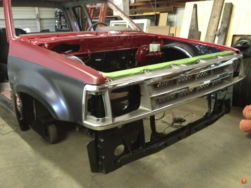

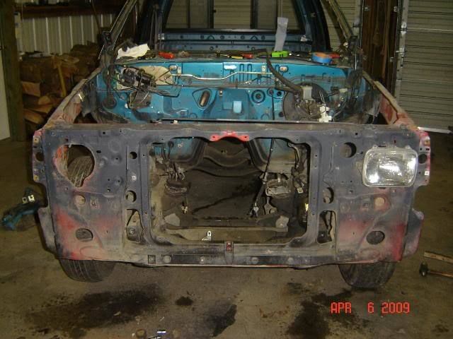

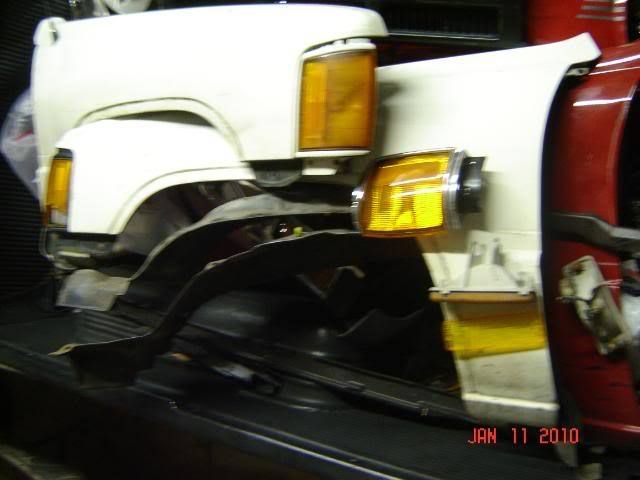

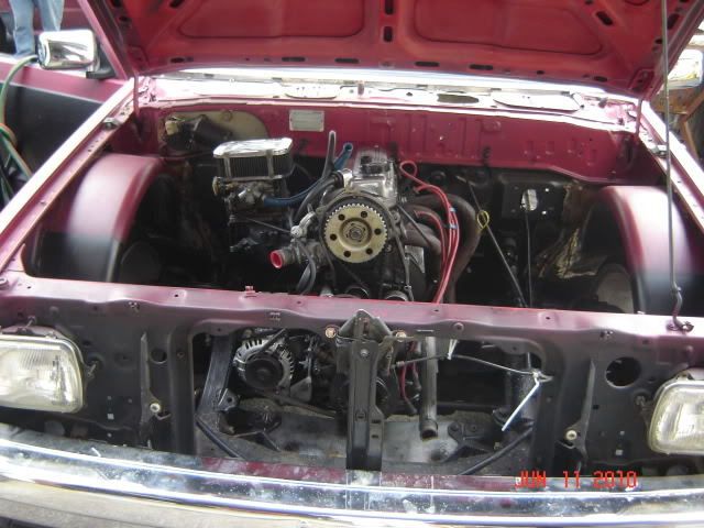

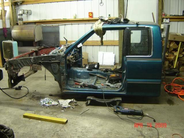

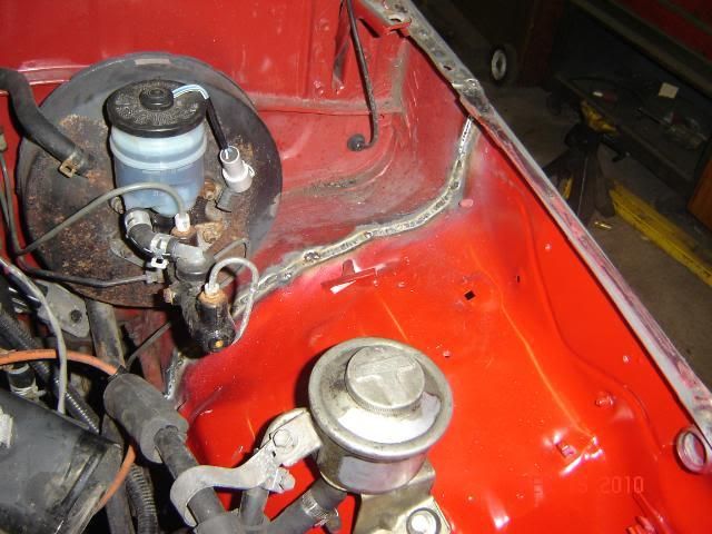

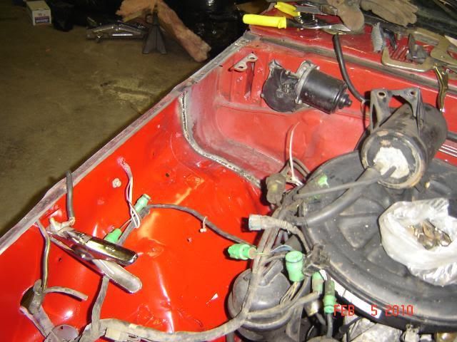

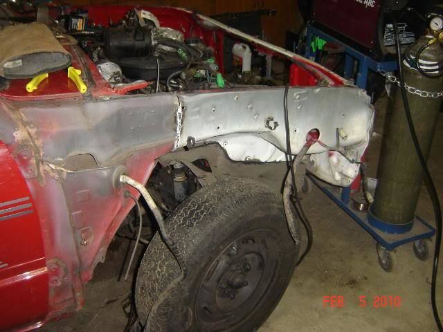

old core support
new core support

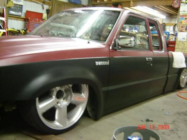

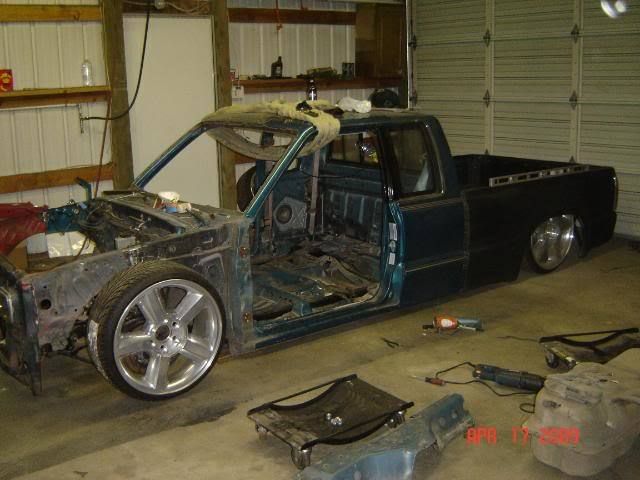

Before

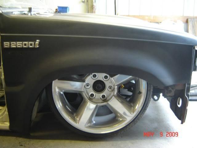

After
cool cool man the core support looks familiar...looks great cant wait to see it

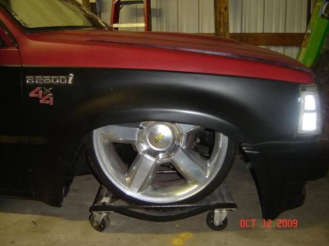

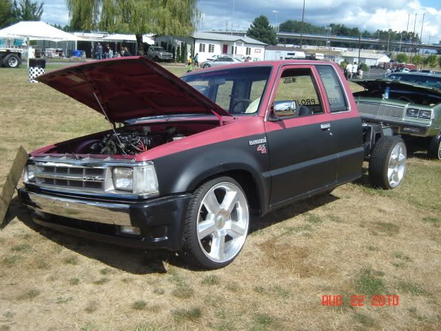

dig them wheels. Chevy SS? 20's?

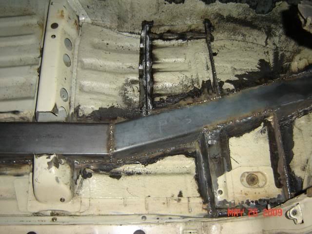

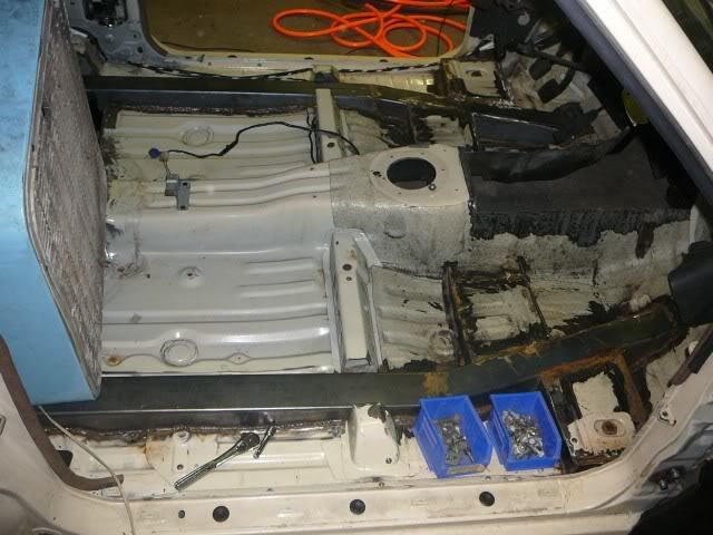

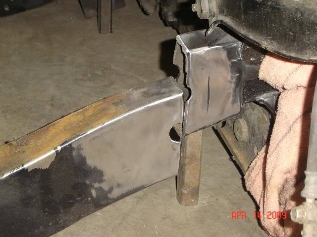

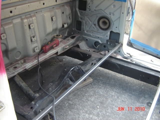

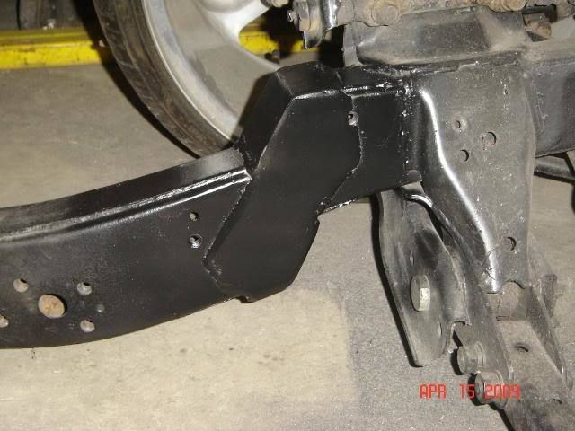

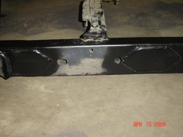

front Z

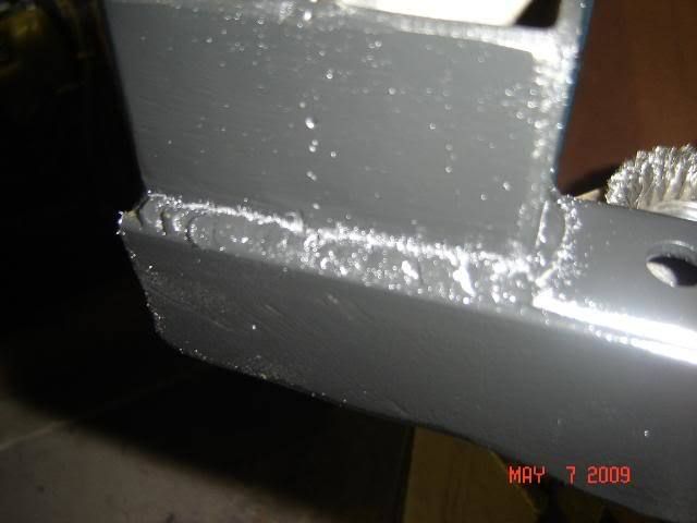

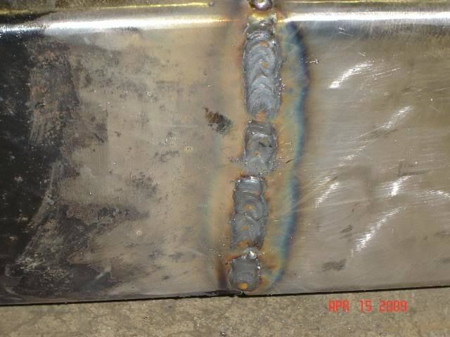

front all boxed in

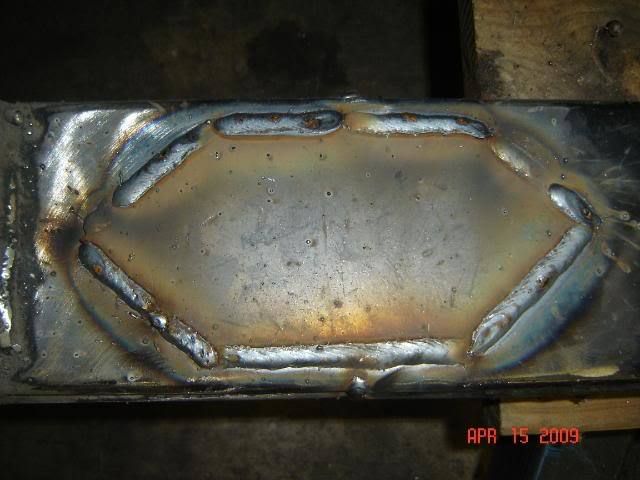

dont weld with you clamp still holding!! DUH

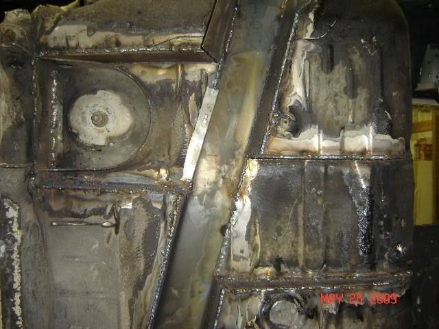

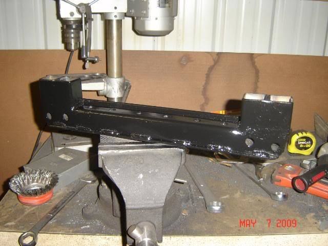

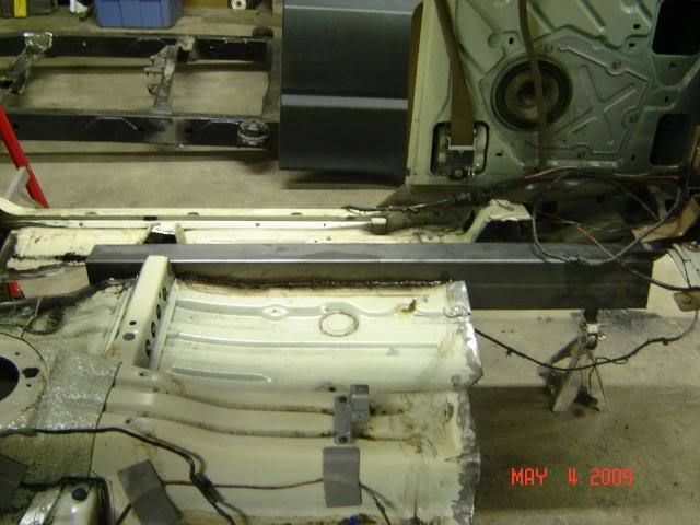

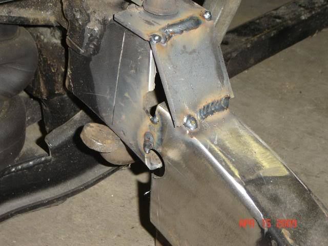

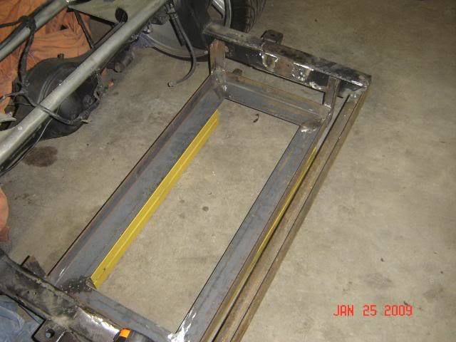

boxing plates for stretch

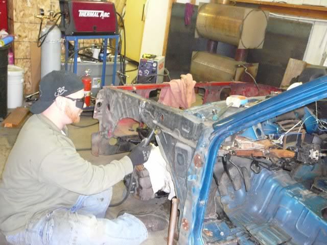

My two helpers!!

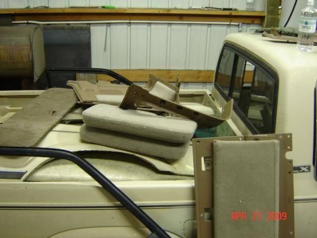

looks great are those car parts on your couch?...grills maybe?...lol

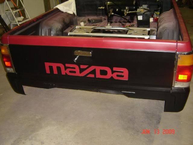

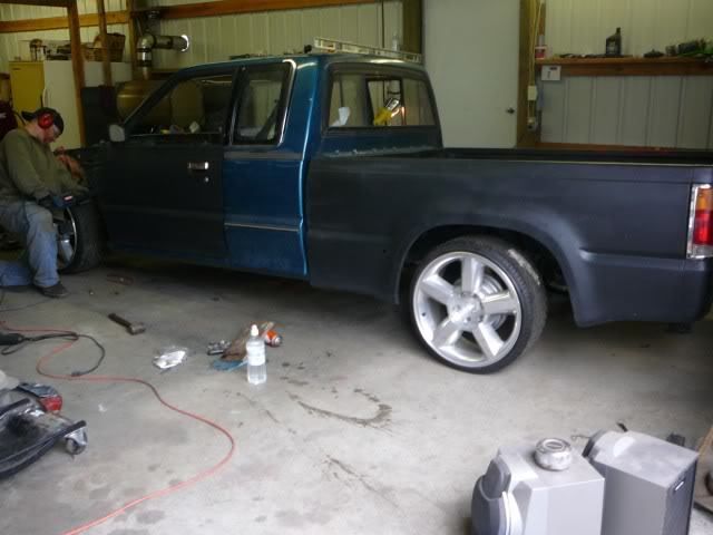

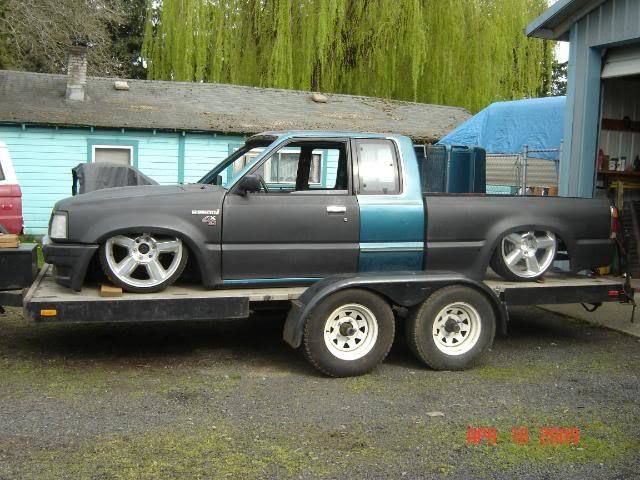

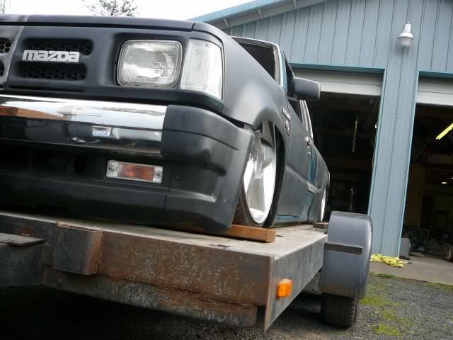

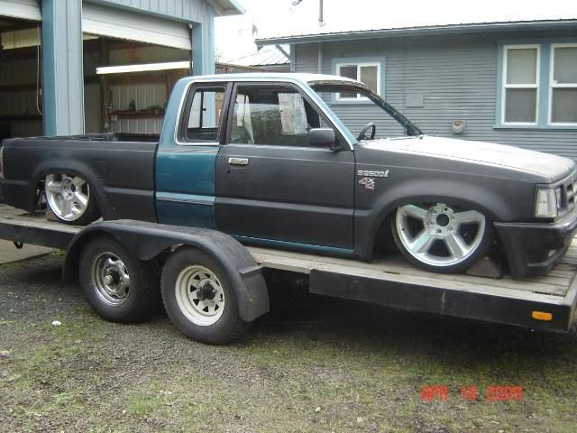

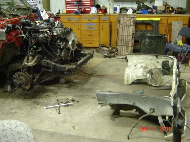

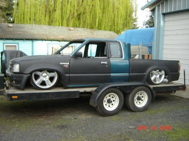

Working on the mazda and seeing this pic with my chevy in the back ground REALLY makes me want to get back to work on the chevy. This mazda was suppose to be my daily driver!!! Damn snowball effect
Never would have got it done without these guys!! LOL

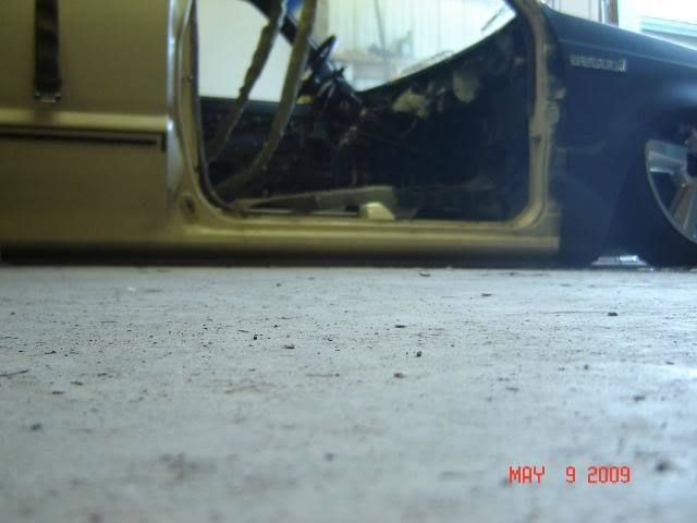

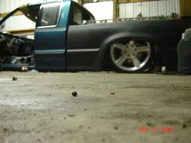

How is that for some side to side? This is when I was welding in the boxing plates

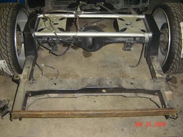

Fuel tank cradle

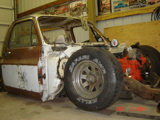

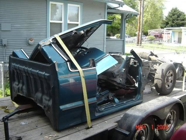

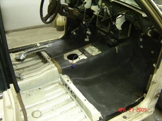

Todds new BD cab. Will go good with his blue truck since no one wanted it!!!
Here is some motivation for you TODD!

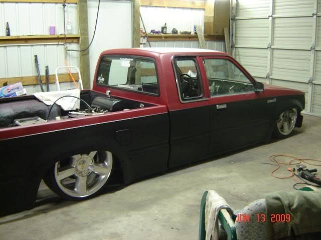

tuckin20s

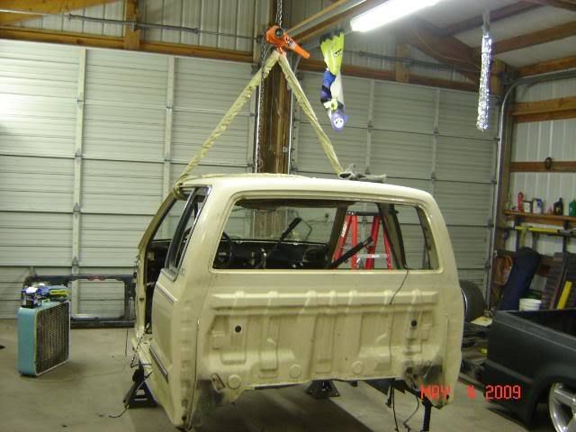

Time to go put the body on and start the BD!!!
