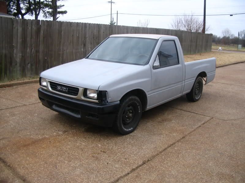

cool man thanks now a pick of the pup dunno if ive seen it
bodied b2600zx (josh)
Once the holidays are over and money smooths out, I'm gonna do a few things to it to make it look better, I jus want a slick lil daily. . .
