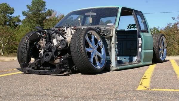

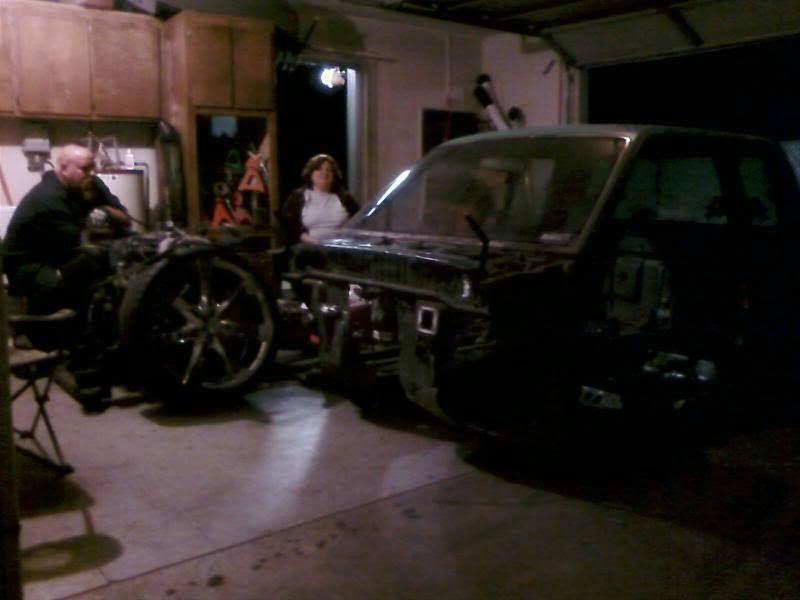

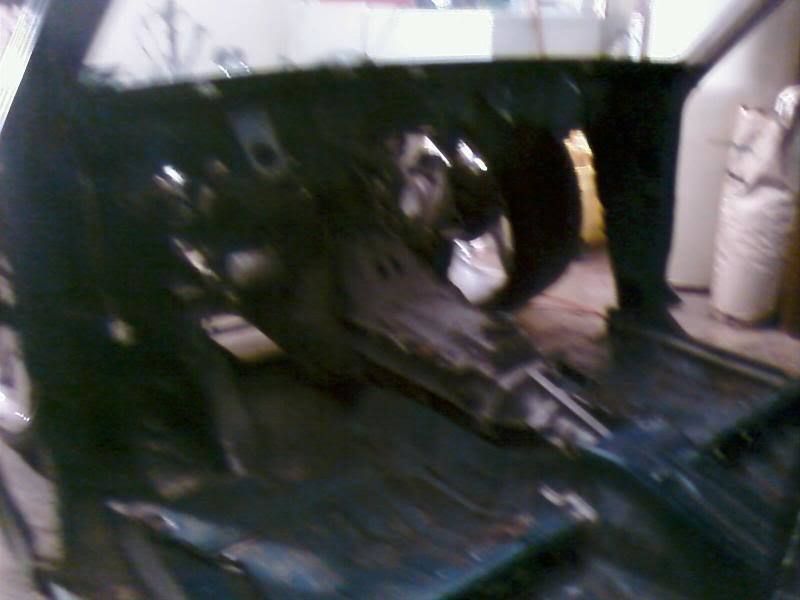

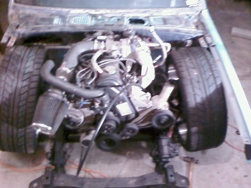

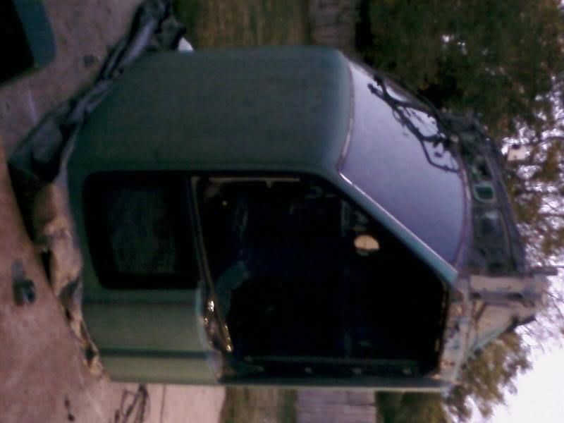

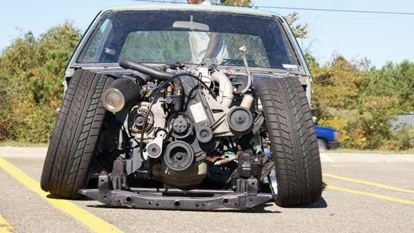

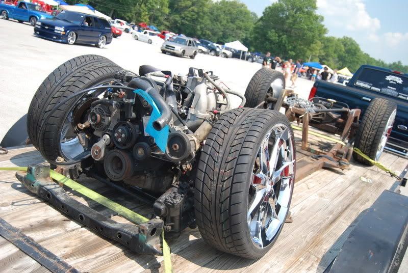

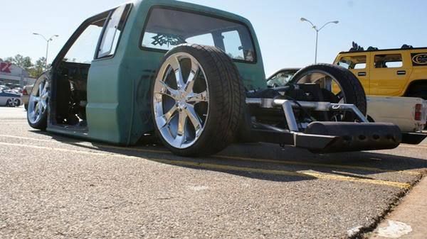

My 1990 ext. cab mazda. stockfloored on 22's. full tube chassis built by a guy in our florida chapter. cantilevered rear setup. toyota 5 lug conversion. 2.5 liter fuel injected '99 ranger engine and tranny. getting started on the cab. hella cutting done. hella cutting left to do. just thought id post some pics of the progress.

daaauuuum uuhhh i want it, did u have to narrow the front end on it or not i want 22s but i dont want to narrow the front end awesome truck so far my favorite bro more pics

just fyi, i am a female, hence the username lol. no the front end has not been narrowed. the wheels have a +35mm offset and there isnt much in the turn radius department but they do the job. i may end up notching the front end to help with the turn radius issue just gotta wait til i can drive it to see how much of an issue there really is. i will post more pics as the build progresses. checkout summer showdown coverage on drop jaw and hot rides mag to see pics of the frame before the cab was cut and fitted. there are 2 frames in those pics. my frame is not the one with the star wishbone setup, but the one with the freaks plaque attached to it.

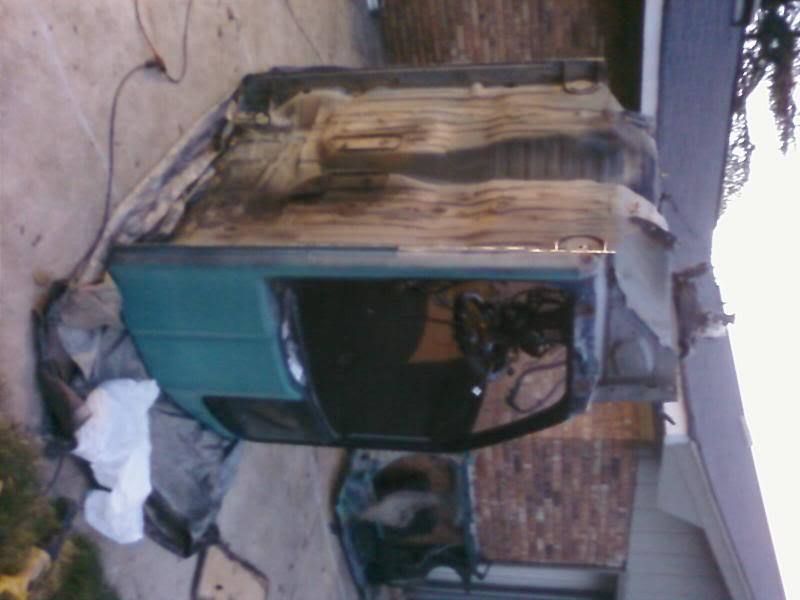

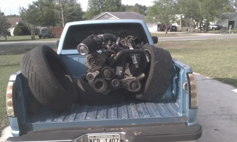

that is me in the third pic, the female
