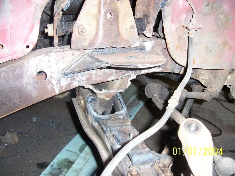

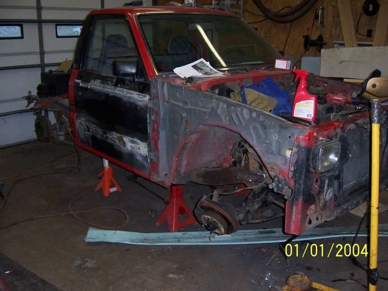

i finally found the camera so i can put some pics on here of my progress its moving slower than i wanted it too but its because my dad doesnt feel like welding on it everyday but the front is almost finished on it

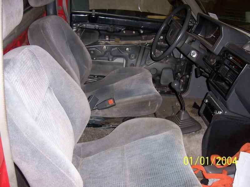

the new seats
hoping to get the fron finished tomorrow and then start on the back

those upper bag brackets dont look like they are angled upwards enough to me...i could be wrong tho.....anyways, hope to see some pics of it finished and dragging soon!

nice honda seats

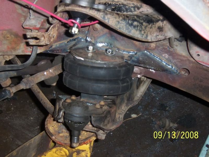

this was our first time bagging a truck and we werent really sure how to angle the upper plates they are actually straight out from the frame so do you think they need to be angled upwards because when we put the wheel on it didnt look like it was gonna lay out if the brackets are andgled will it then go up farther or can someone get me pics of theirs to show the amount of angle on the bracket any help will be appreciated

it it's straight out from the frame, it isnt going to lay. they need to be angled up some so that when the controll arm comes up it collapses the bag even all the way around...the way you have it now, its going to collapse the bag on one side and bottom out on the internal bumpstops in the bag.
looks good keep the pics comming

will have new pics tomorrow we reworked the front bag plates
lowb2200

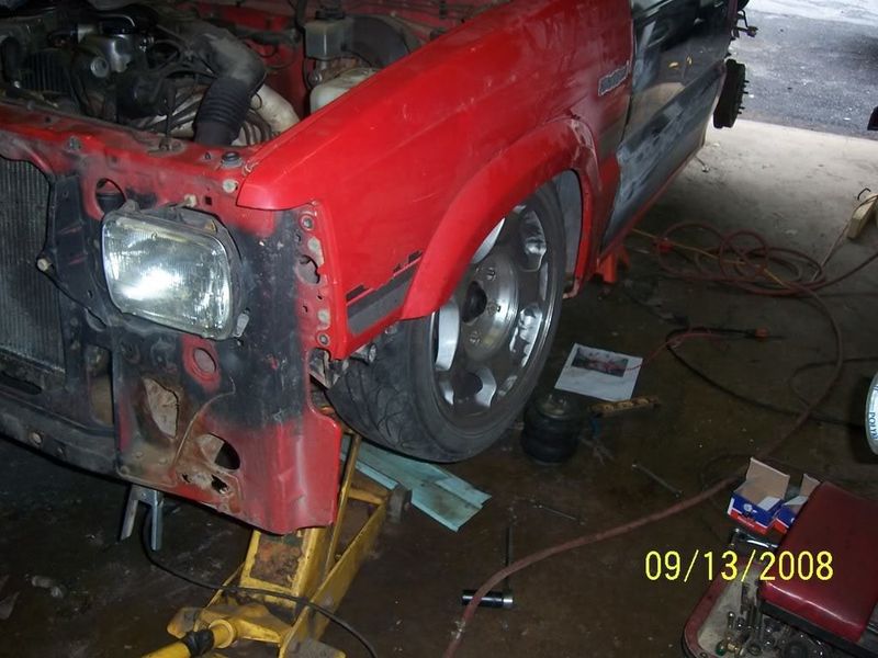

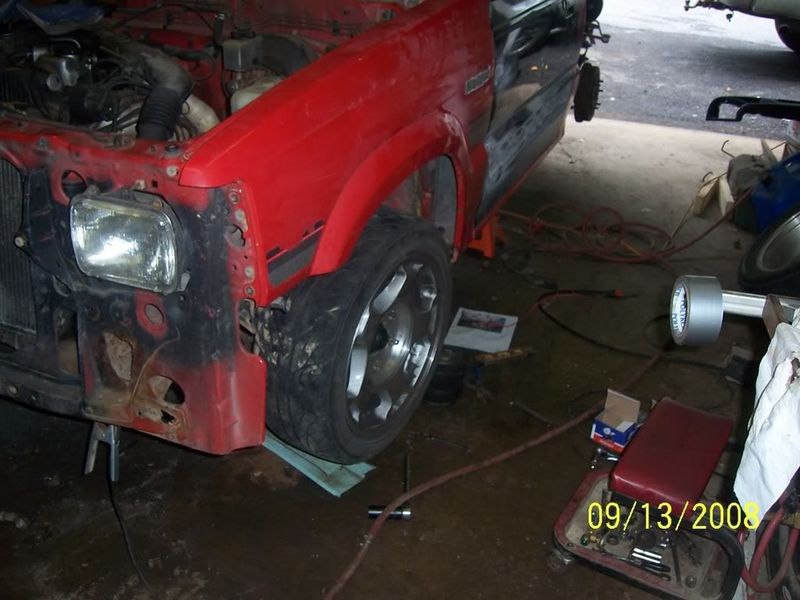

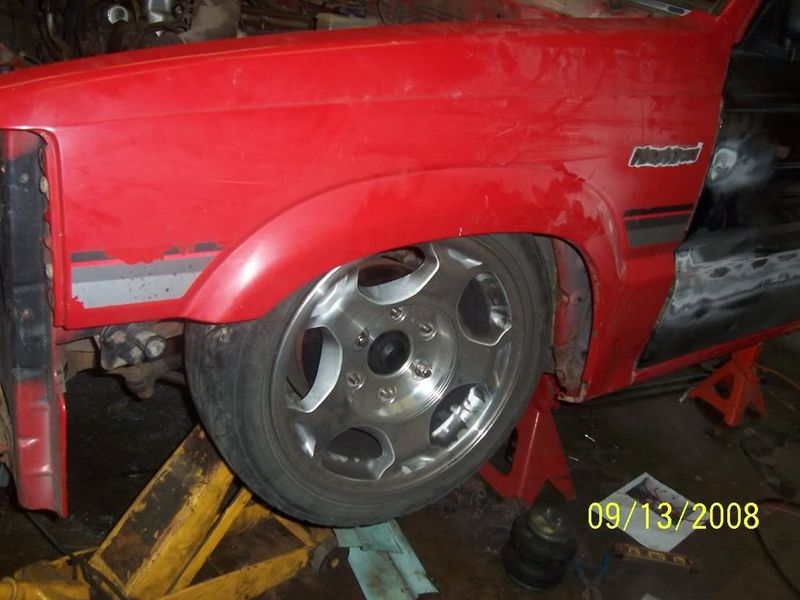

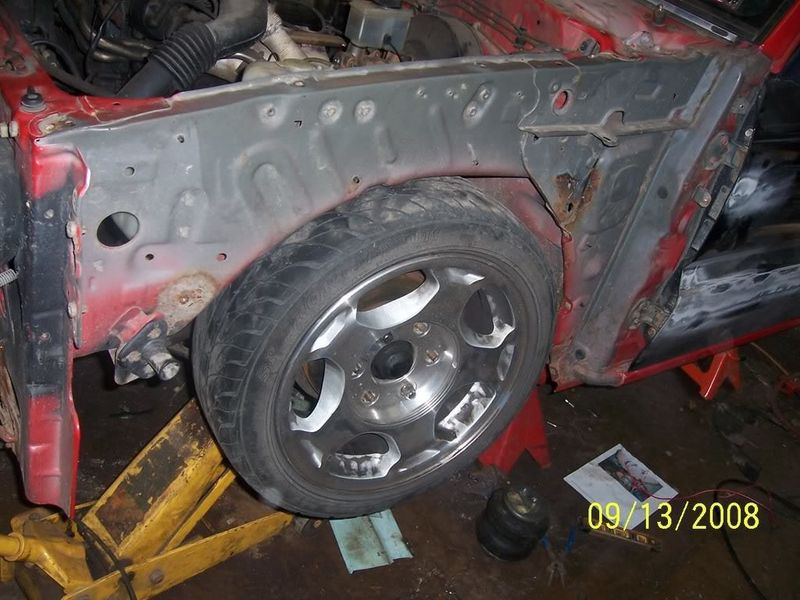

i finally got some pictures taken, we re made all the front bag brackets but it still doesnt look like it is gonna gu up far enough and the bag is up as far as it will go and the bracket is up jst about as far as it will go

Nice! Youre going to wanna cut the inner fenderwell, Youll never lay without em gone! Looks great though man! good job!

drop spindles.....
