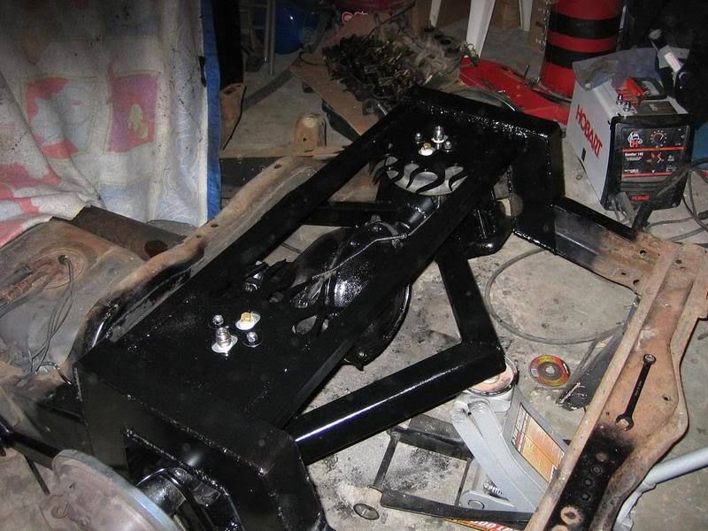

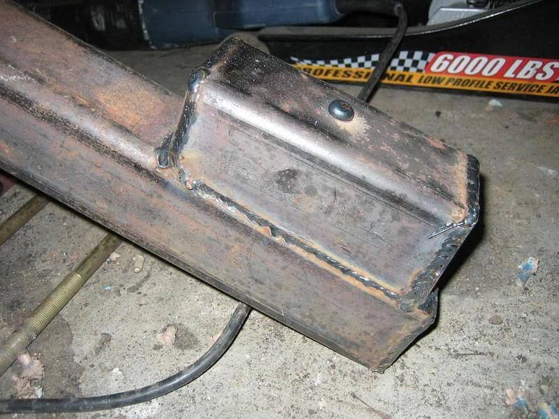

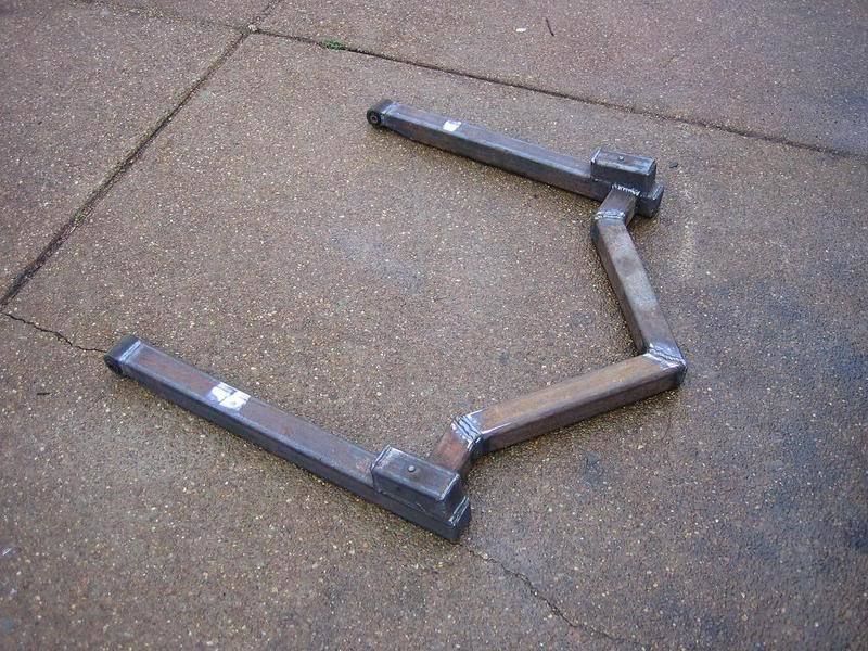

ya i'm not a big mono leaf fan, you could prolly get some metal for as cheap as anything else you would have to try and make a 2 link
This is one i made for my buddies s10... He got the metal from his uncle. Jus ask around, see if you can find someone with some scrap metal you could have

One things that sucks about that style 2 link is you dont get any articulation and can get stuck in driveways. I'v done the same concept, but insted of bolting the link directly to the axl, I used two bushings per side(one in front and one in back of the axl)to allow for flex. You also need a panhard bar for this type.
