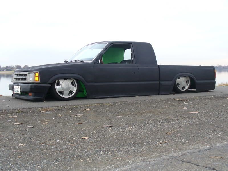

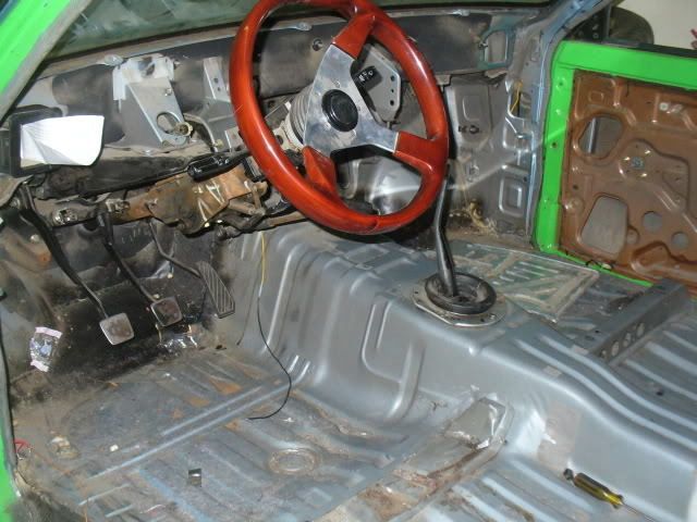

heres a pic from 3 years ago

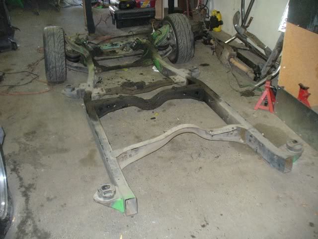

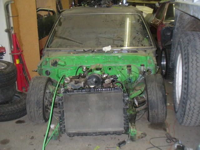

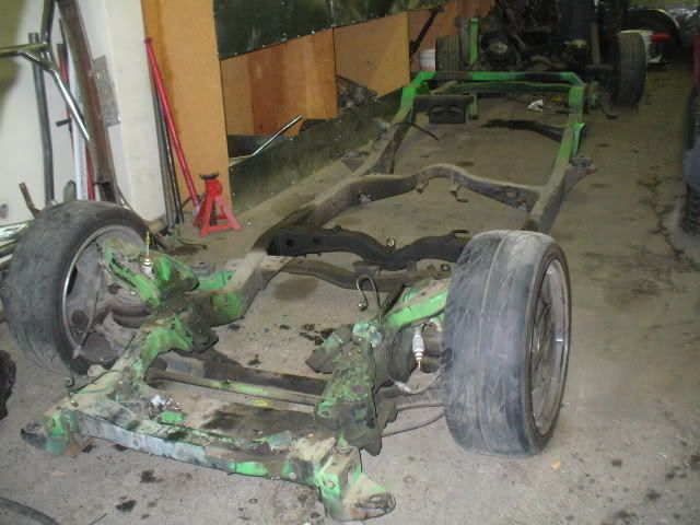

heres after about a few hours of work of stripping it down

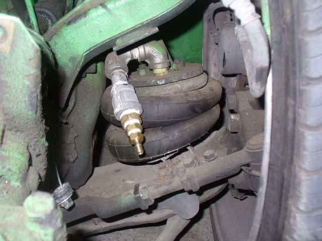

all the suspension is real nasty and hacked up by previous owner back when i bought it from him in pieces. those fittings are only to get a schrader valve in there. it sucks running an engine driven compressor when you motor blows up.

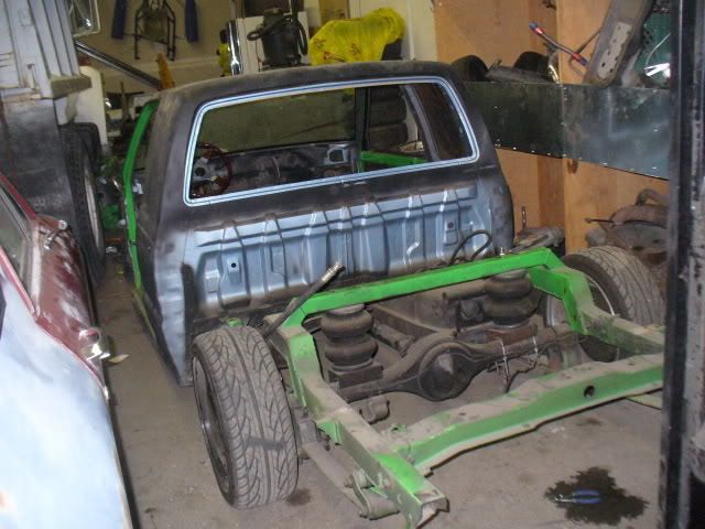

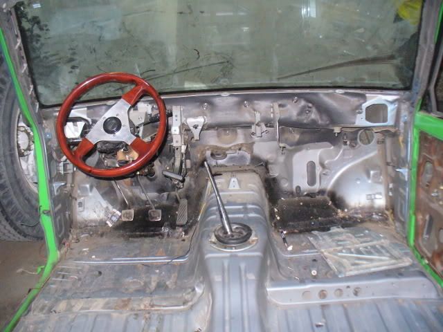

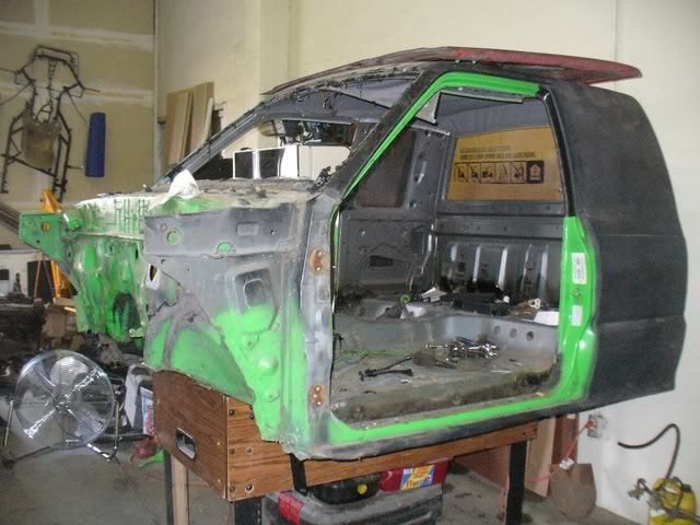

i got it the rest of the way stripped down and made the first cut. i should be gettin some metal soon and start on the stock floor bd. i am using the original frame rails and sleeve it with 2x3 to shorten it. i still have to put it up on stands and get it level and plumb bob it to check for straightness. if i have problems with that, i have a line on a frame table to do the work.
here is what it looked like as of yesterday.

Damn that pic of the cab on the foos ball table made me laugh!
