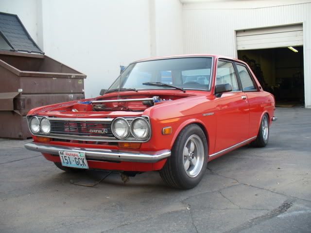

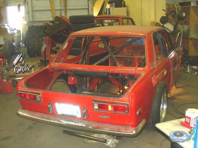

i figured you guys would like to see the other project my dad and i been working on. its about 2 years into the build because it started out as a simple build with a full cage and a crazy high compression z/l series datsun motor. then we got ahold of the sawzall and started cutting. we are building it as a great all around car. it will be street legal but built for the track and hill climbs. we are also putting a full stereo in it and taking it to car shows.
current and future plans:
AWD SR20DET out of a Nssan Pulsar GTI-R(dynoed 450hp at the wheels, front clip is at the docks in AU)
alot of motor work has been done but to be on the safe side the motor and tranny will be fully torn down when recieved and gone through(new parts, flow benched, cryo treated, knife edged, etc...
17x10 5zigen FC01RC wheels w/ falken azenis 275/40/17

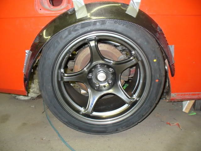

7" was cut out of the quarter panel to fit the wheels and carbon flares will go in place
hybrid z32/s13 rear suspension with Battle Option arms
Q45 LSD in the back
full tube frame and cage

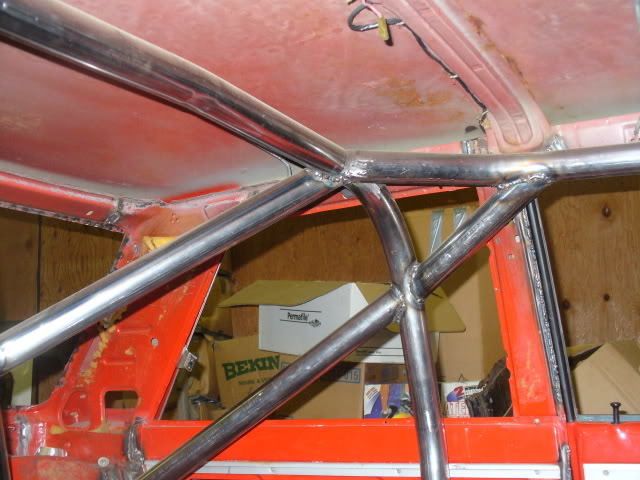

full cell
full plumbed halon system(fire supression system with jets over cell, under seats, and over motor)
recaro seats w/ 5 point harnesses
eclipse head unit
kicker l5 8"
mb quart components
jl audio amps
and many more.....
what we started with
this had to go

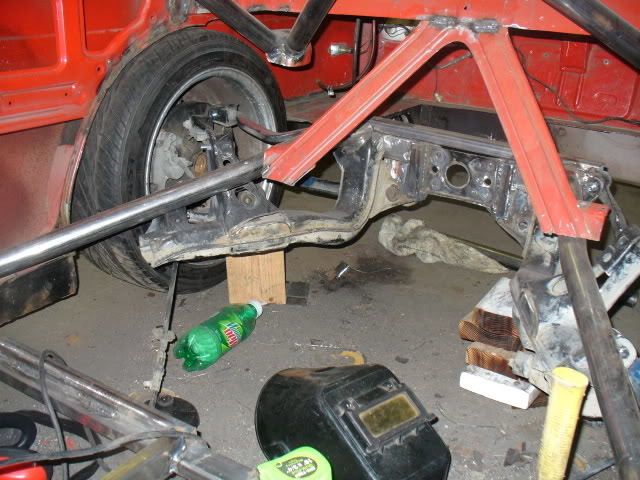

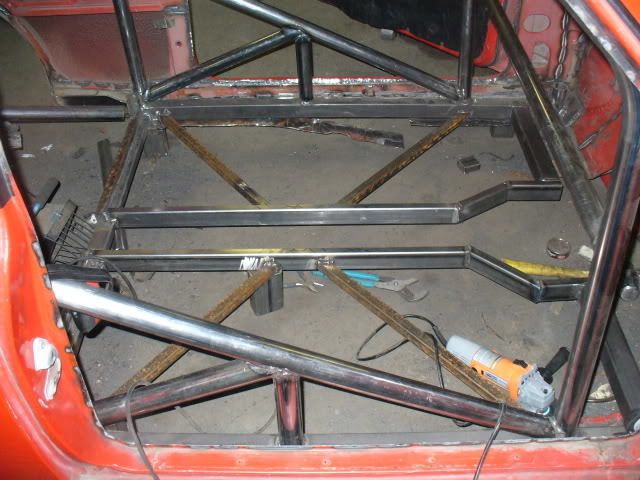

fitting subframe out of Q45 to build tubular mounts.
pass. side before gussets
driver side while locating mount locations

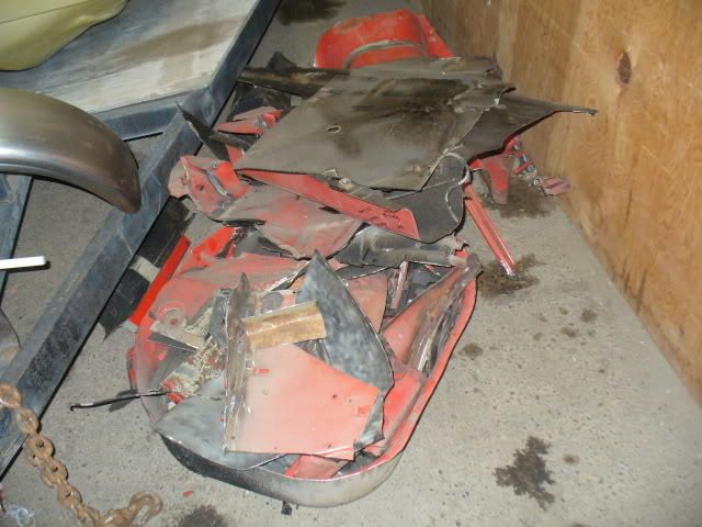

old floor, we didnt like it so its cut out now.

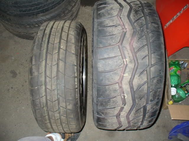

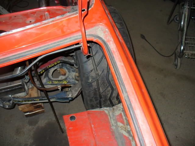

new rubber
compared to old rubber

shilaeli huggr (burdaddy)
[quote="LAYEDOUTB2K"]
new rubber
DUCK TAPE FTW!!! true redneckkin. i'd leave it on when your done just for shits and giggles
layedoutb2k (chase)'s avatar
layedoutb2k (chase)
the duct tape was there to hold the flare on while we figured out the width for the mounting points on the arms. we had to narrow the new setup a bunch but still made the track width 10" wider on the car.
