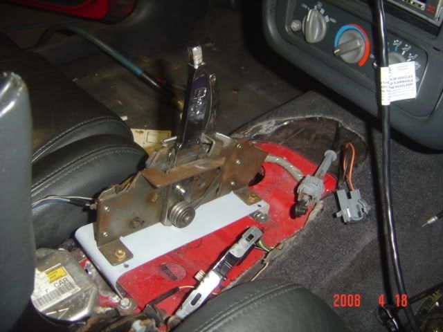

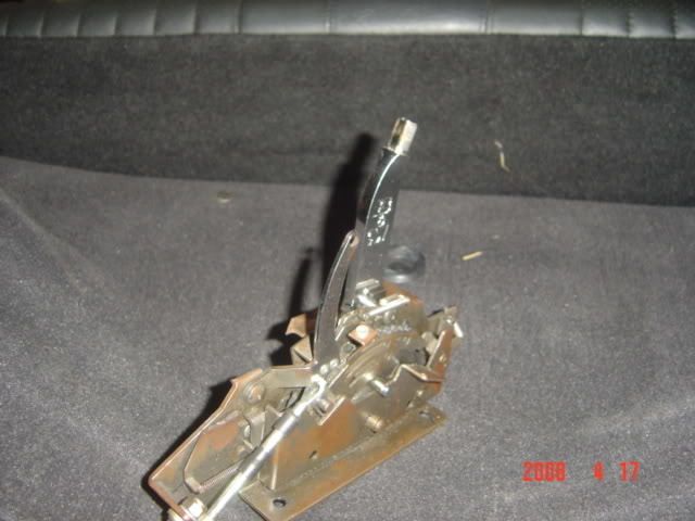

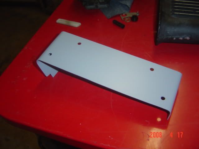

tonight we made the new mount for the new shifter. it sits higher than the stock shifter so i just had to make a new bracket. pretty easy. just had to keep cutting on the center console and fit checking. took a little while but it turned out very nice and he is extremely happy with it. i am taking the mount to work tomorrow to install some nut plates and then we will be welding it in tomorrow night and then moving on to the trunk.

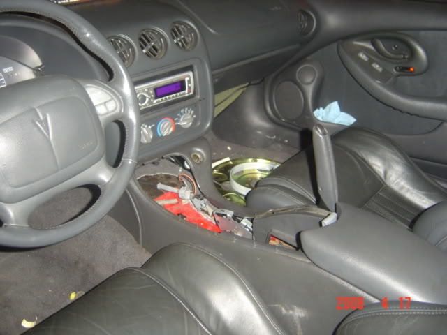

here are a few updates...we pulled the engine and installed a new oilpan because the other one was leaking everywhere. i got a nice big hole in the trunk floor to install the new fuel pump for the nitrous upgrade. woot woot. and i got the mount welded in for the shifter and all the interior back in. here is the only pick i have right now. i may take some more tonight.

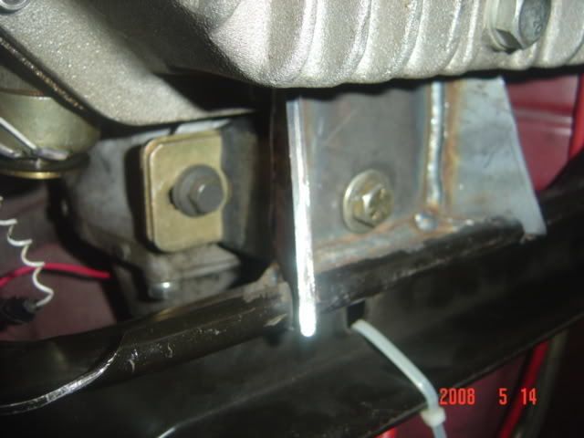

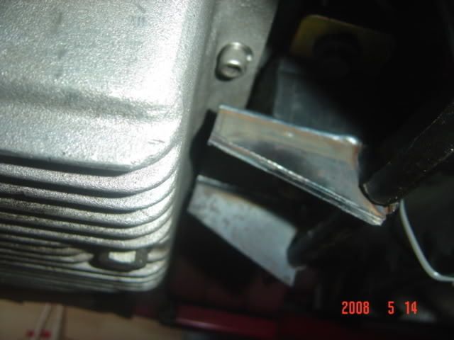

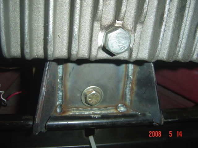

got some more work done, and got it cranked up the other day. sounds bitchin but it doesn't have the exhaust hooked up either. haha. i had to modify the tranny crossmember to mount the turbo 350 tranny. and i found out the other day that it is an lt1 block, but the heads got trashed. didn't ask what heads he has on it now. here are some pics of the tranny crossmember for the pic whores. haha. i will get a video of cranking it up and stuff on monday. the starter quit working so he has to go get a new one. always something.
and i welded everything up on both sides before we mounted it but forgot to take pics until it was already mounted...
