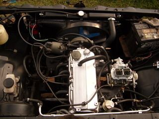

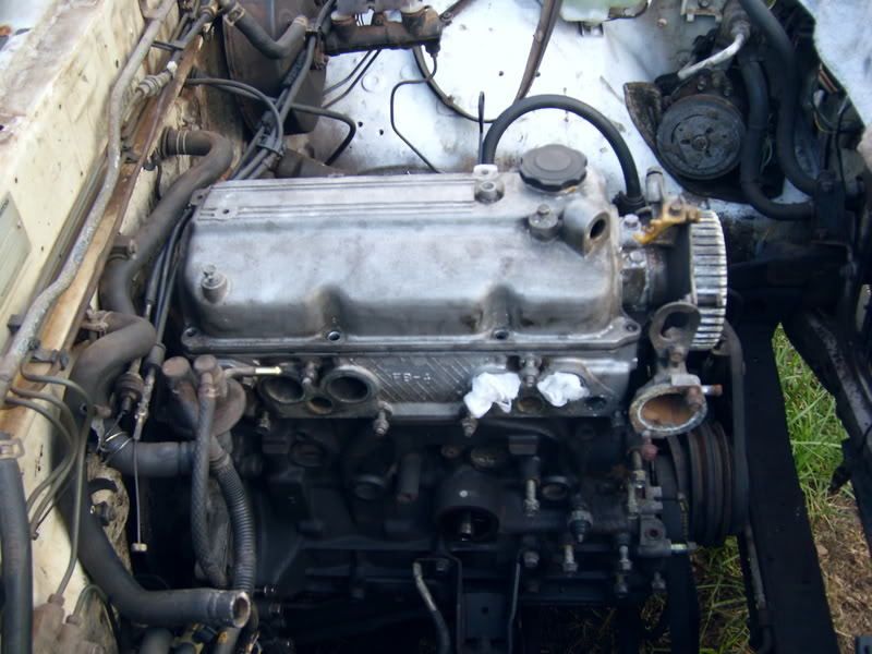

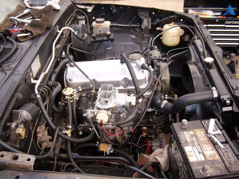

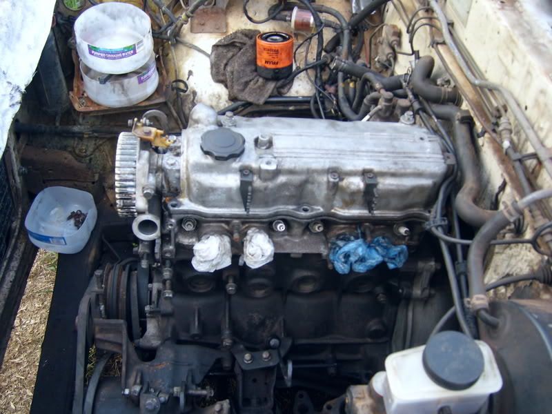

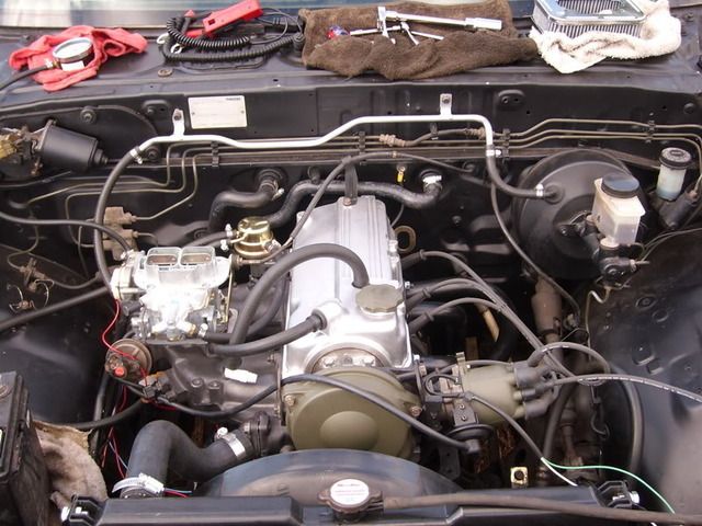

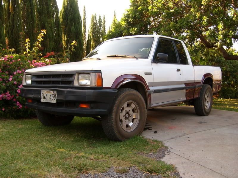

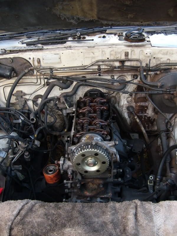

today was a good day, i spent all weekend putting my motor back together. i've just been saving, buying parts, and rebuilding this truck for so long. its also my daily that hasnt been a daily for 6 months. im stoked , it started right up, simple carb tuning, and then timed it, adjusted valves, and its tits.
before:
after:

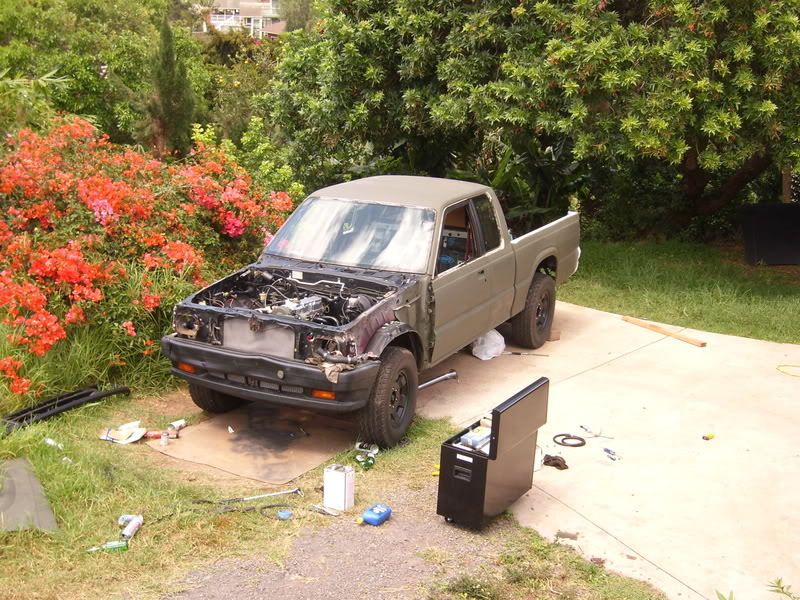

looks like the jungle with out that house, those are banana trees right over my bed
its been a lot of work, and on the first drive, i knowticed a knocking sound by the front tire, it knocks going straight, harder when i turn right, stops when i turn left and stops when i push the brakes, so i get to pull off the tire tomorrow to see whats the deal, but my trucks a cruiser!

man youe engine bay is super clean congrats on getting it going

good job man what size tires didu say u have? i think i mightve asked u before

bet its the ball joint that is bad .. man hella clean up job on the engine area looks like it just rolled out the assembly line its so clean.
862000 avatar
862000
yeah i spent a lot of time cleanin' when there was nothing else to do.
i kinda wish i got an electric fan, that flex fan's holes had to be drilled wider to fit the stock pulley wheel, and spaced to clear the bumps on the wheel too. its so loud too, always on, but it will never overheat on me again, i guess i went over kill because of that reason.
i have 30's on it

nice clean up..... which carb is that?

weber 32/36 k675

very clean man, did a hell of a job! I wish i had weather like that to work on my truck in.
