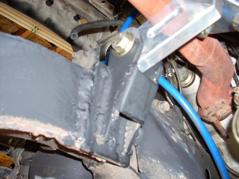

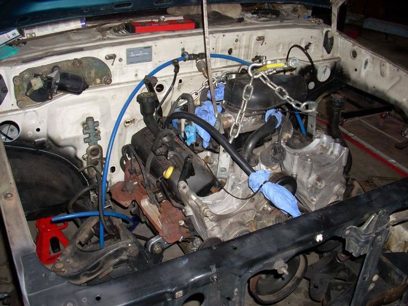

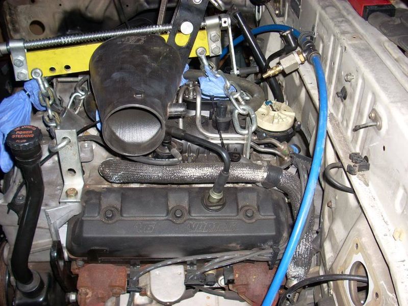

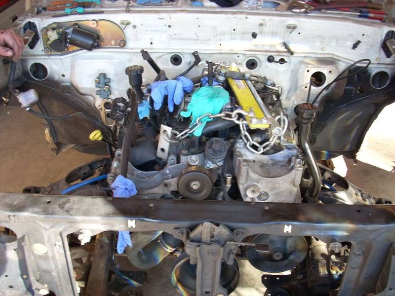

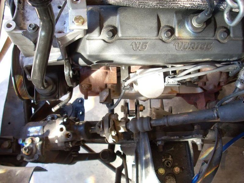

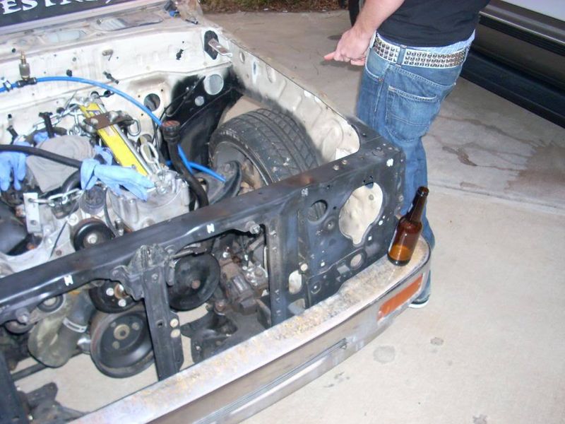

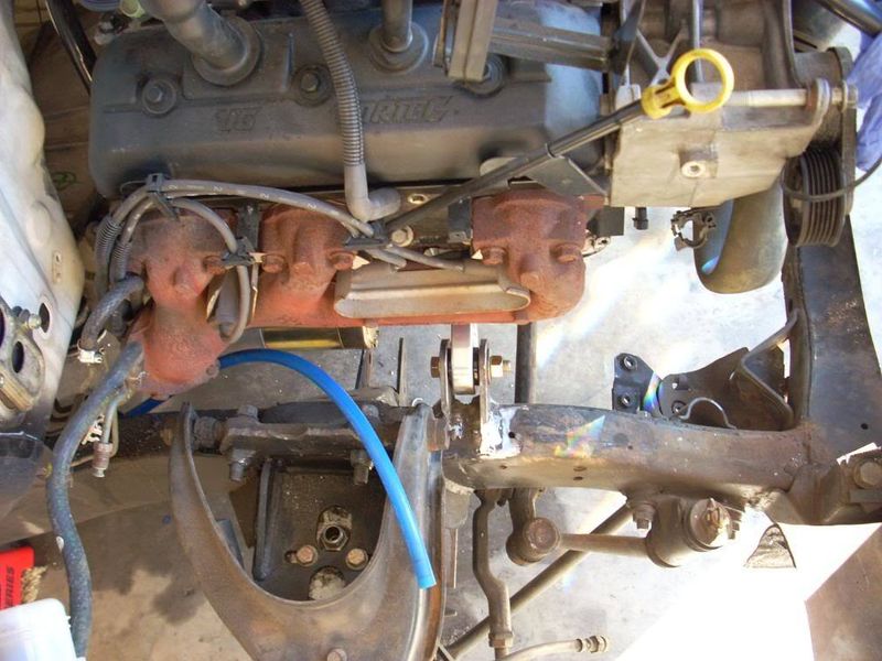

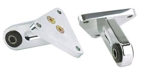

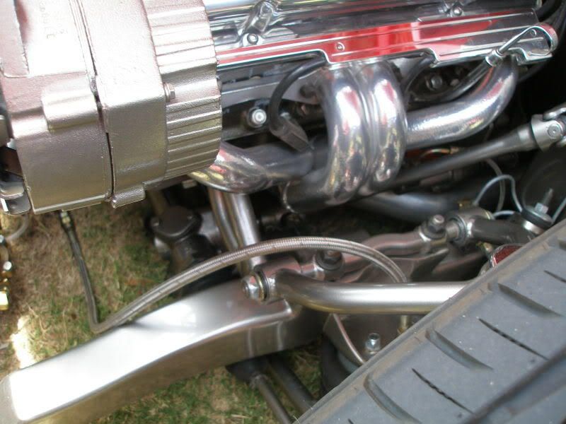

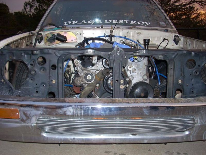

here is the motor finally mounted in the truck with billet universal 350 mounts from

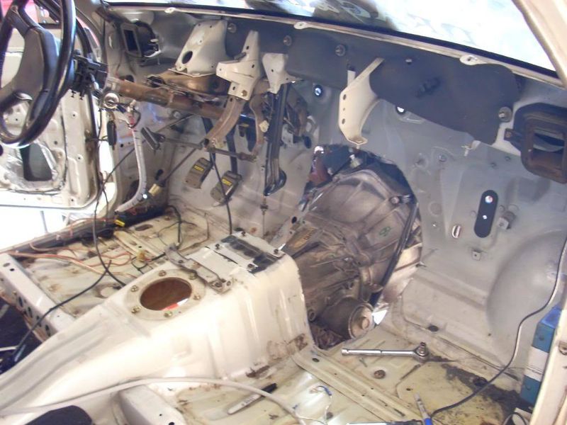

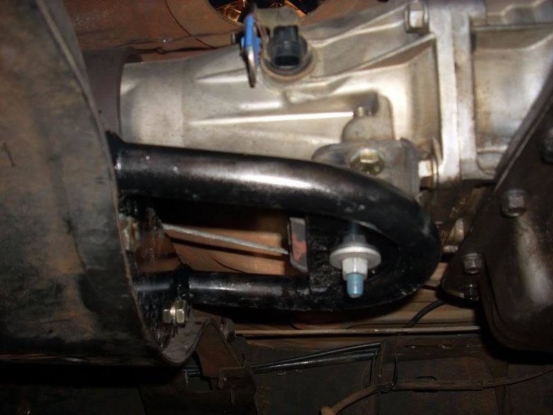

I have heard that you don't have to cut the tranny tunnel for this swap but dam this 4l60e is f'n huge compared to the mazda tranny. First i did some messaging but it was still hittin so i just decided it would be easier just to cut it out and build a cover and weld it back up. Plus if will make it easier when im running my fuel lines and Lokar floor shifter!!

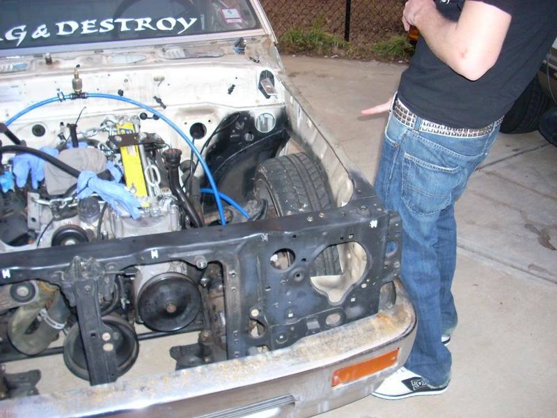

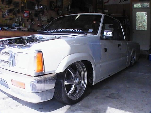

This is the first time my truck has seen sunlight in over a year!!
haha i thought these were funny and my friend will probably hate me but oh well! lol

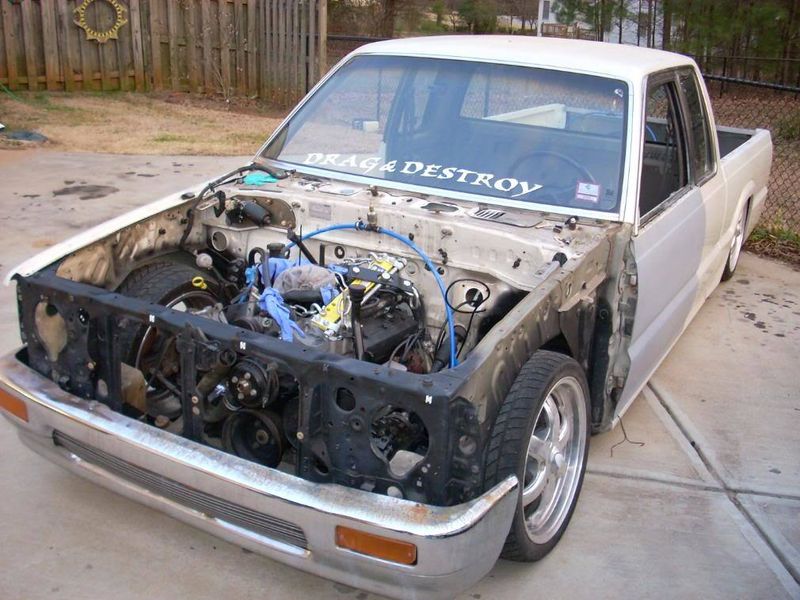

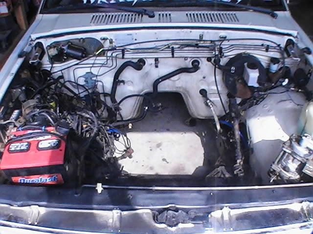

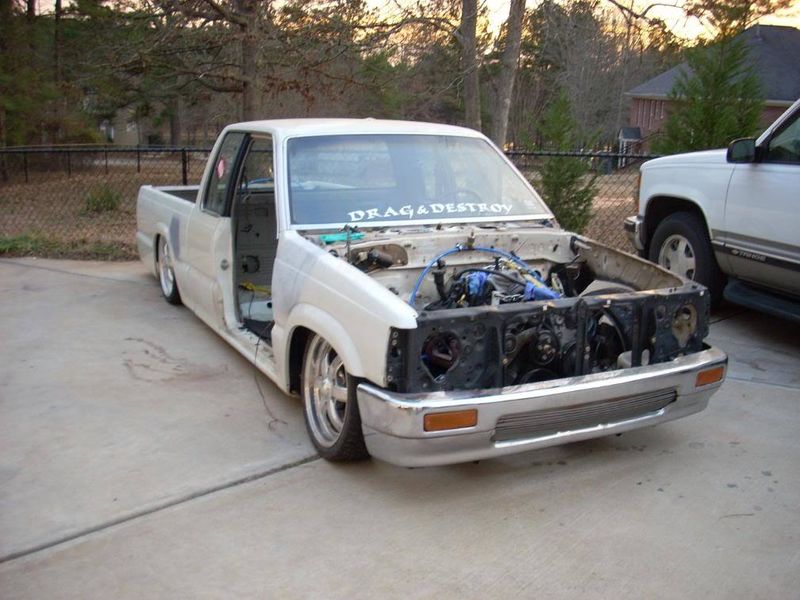

here are some pics of what the truck looked like before the swap started.
As soon as i can get a new bed everything is going under the bed!

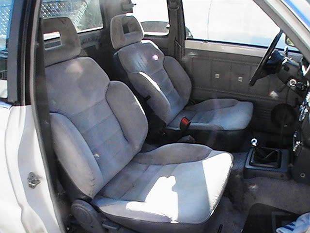

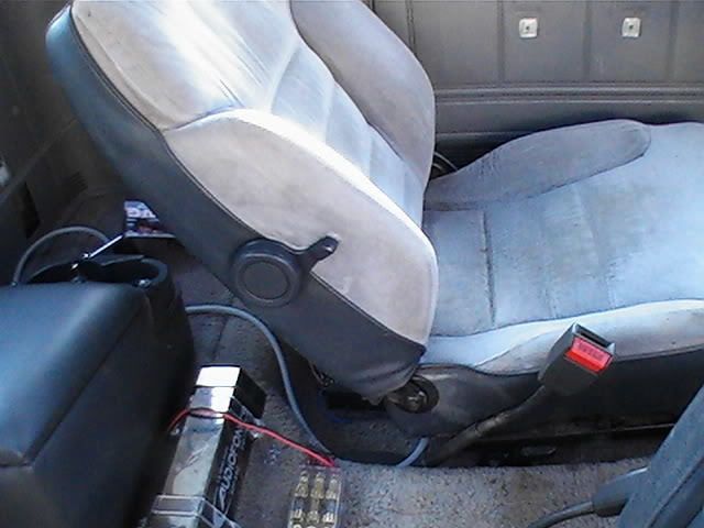

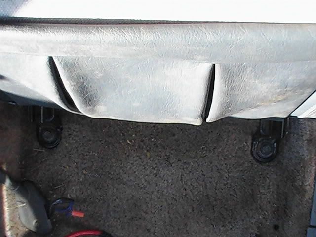

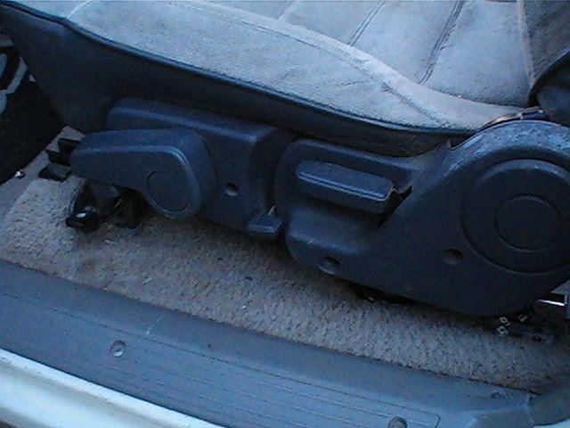

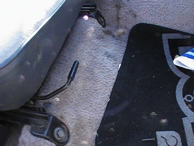

These are 86 626 buckets. If anyone is looking for an easy bucket swap this is it!! I only had to drill 2 holes on the drivers side to mount the b2200 bucket tracks. The passenger bolted on. These seats are really commfy and have so many adjustments for the drivers seat.

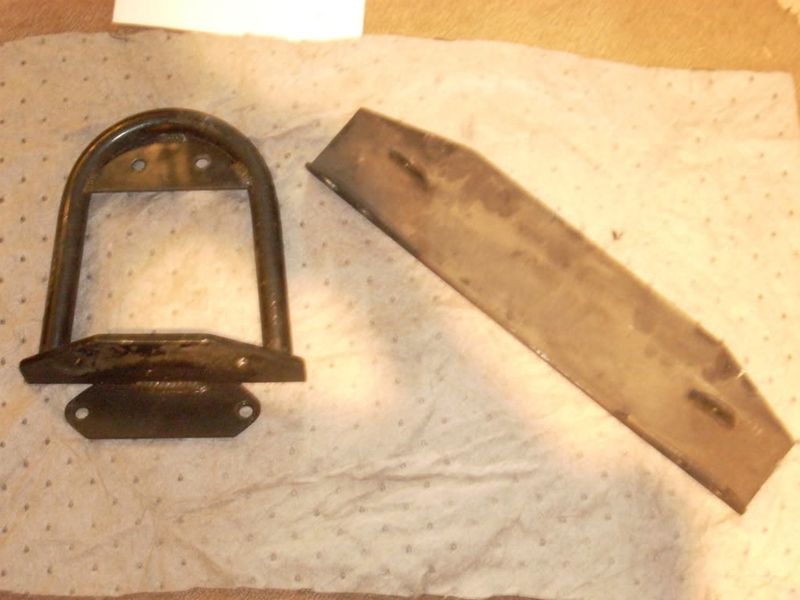

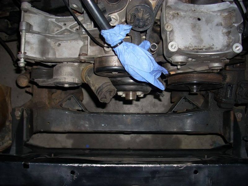

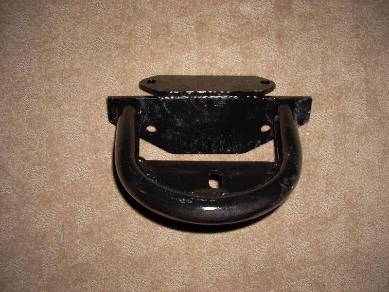

well lookie what came in 5 mins after i posted...

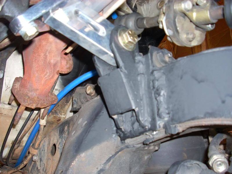

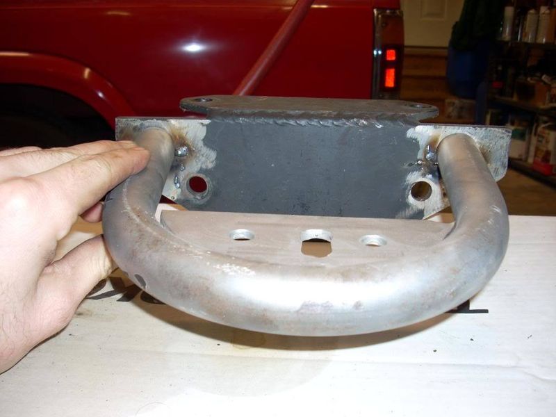

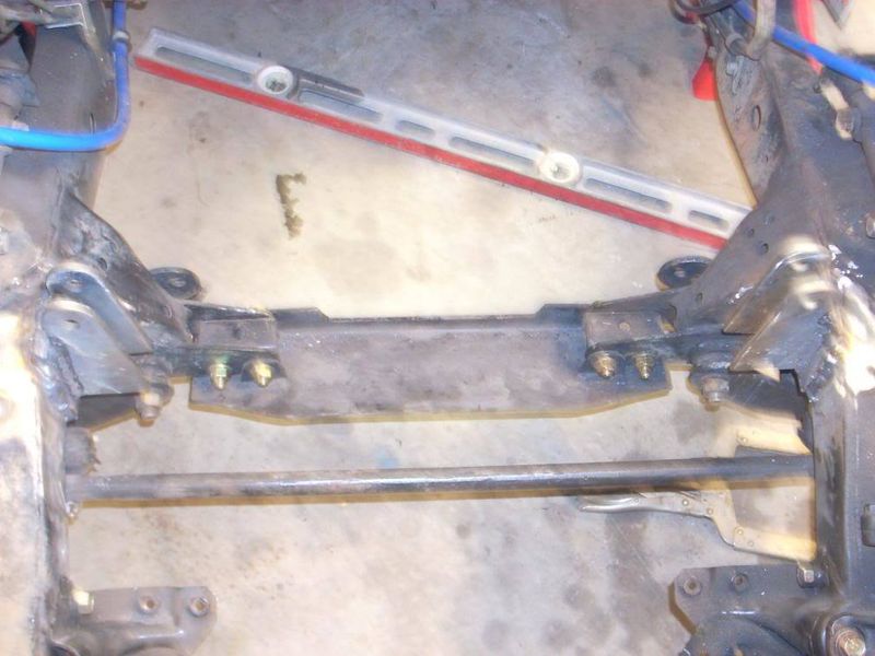

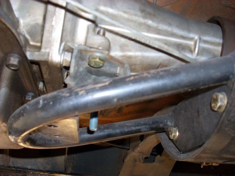

It's a used ultimate customs 302 swap kit minus the motor mounts but i don't see why i couldn't make it work. I sat the tranny member up to where it would bolt to the factor cross member and it looks like all i go to do is drill a single hole in the center of the mounting plate. The front member doesn't fit cause i guess i mounted the motor too low....f*ck! Well i was planning on running Cando arms anyways so i won't even need that anymore but i only paid $50 for the whole kit so im not to disappointed. I would have used a factory automatic trans mount for the mazda but went to 8 junk yards and couldn't find a single automatic!! So instead of waiting to find one i found this and knew i could make it work.

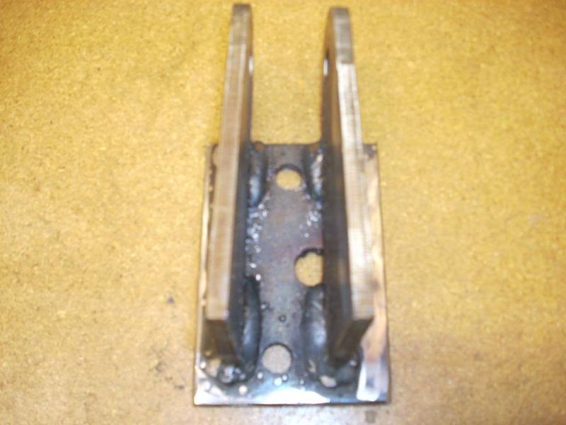

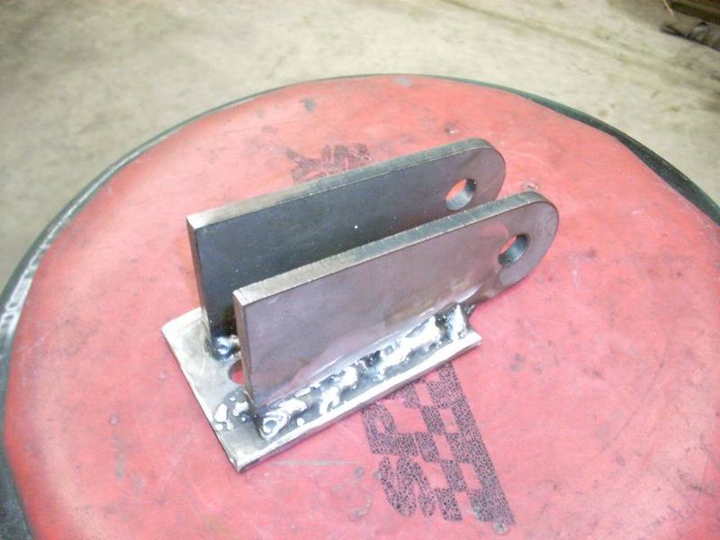

the only snag i have run into so far is the tranny mount and what i found out today that my motor sits to low which i already stated earlier. I'm ordering some new tabs to raise it up like 1/2 inch...what a bitch.

Ya the tranny bracket is the same for both kits and yes all you have to do is drill a hole in the center . You will find that you will still need to have a crossmember under your motor for frame support bro. I do like those motor mounts though they are sweet. oh ya for the mount on the back of the tranny make sure that the bracket you use has some hieght to it or you will find that the tranny will hit.
