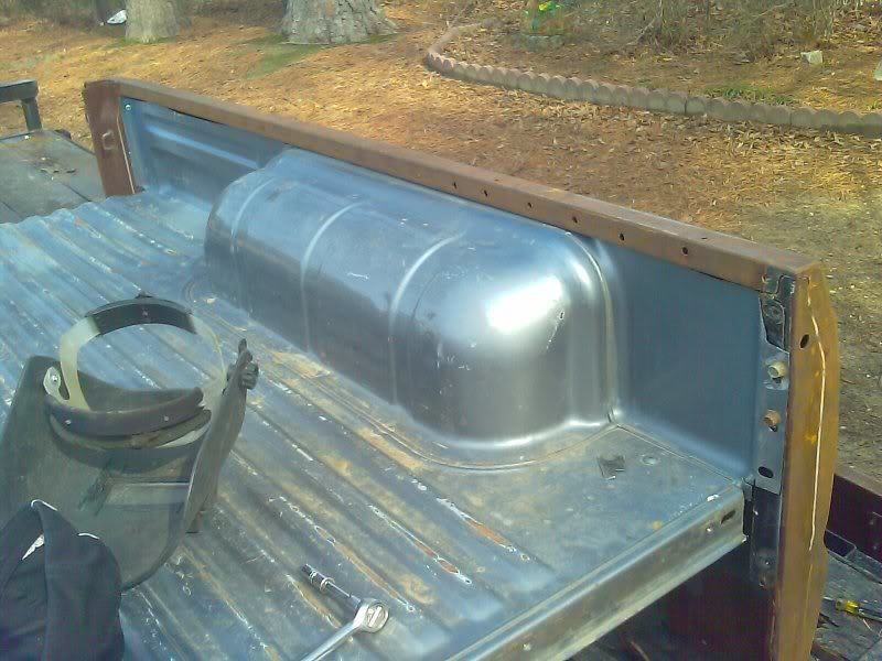

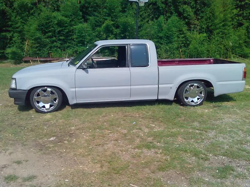

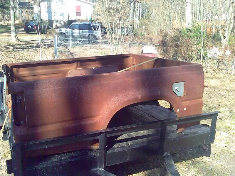

well im just getting started but here are a few pics
the day i got it
free 4x4 bed i picked up
5in body drop on bed for no holes when its bagged
about as close as i could get it to the way we are planning on painting it ill post some interior pics later

Looks killer. I like the way you are doing the bed BD.
outkastdawg's avatar
outkastdawg
thanks. yeah i much rather do the bed this way so i dont have any holes when i gets bagged and i can keep the tank and all hidden

those pics really explains how to the bd on the bed. i like that. thanks.

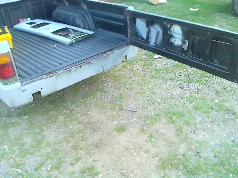

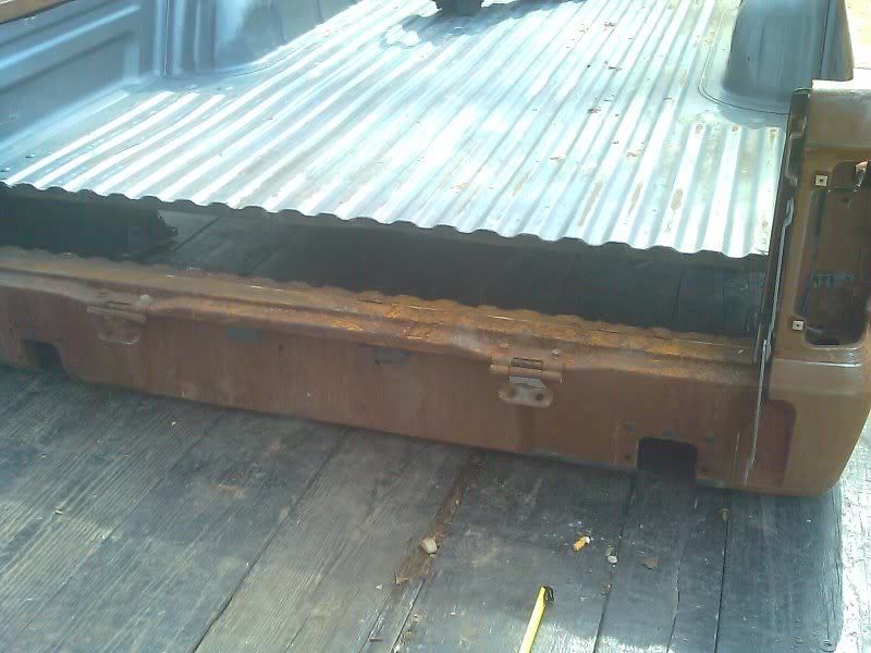

well it was my first time doing it but it turned out pretty good i think the only real trouble i had was drilling the new bolt holes where the floor bolted to the bed sides. i just cut it even with the top of the fender well and about three inches from the tailgate. not thinking though i got it up in place i realized i should have cut out the extra metal between the fender well and bed rail when i do it again i will cut out the side wall between the fender well and bed rail it should make it easier to line up
outkastdawg
i got my new bed home and decided to go ahead and put it on since its gonna be 3 weeks before i can get it into the shop to have the dents fixed and the floor had no holes in it
