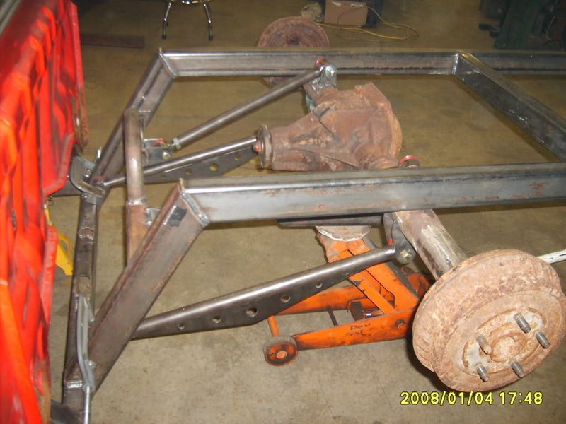

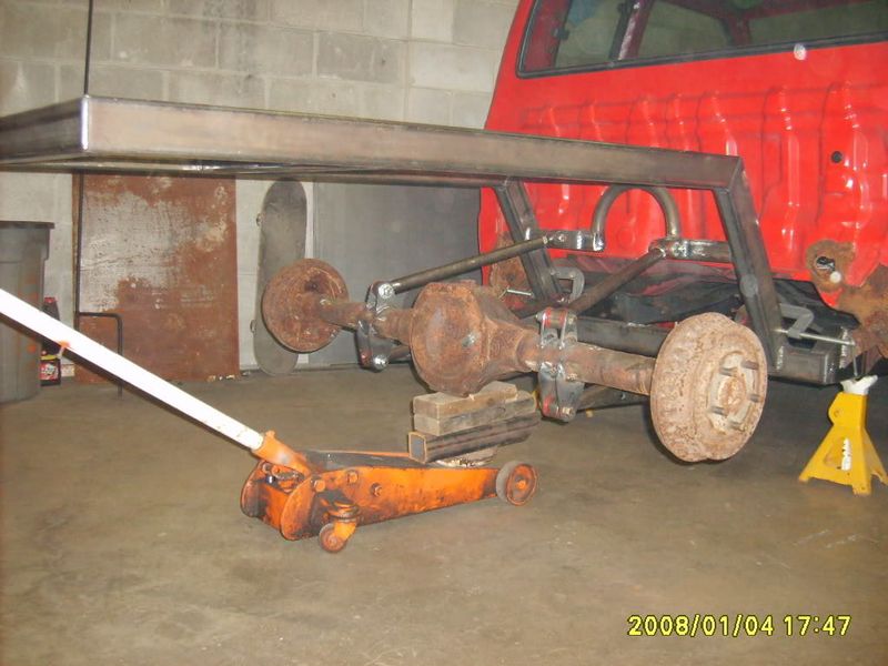

Here is a Mazda I jus finished at the shop, it came in for a back half a Twisted Metals 4 link and rear bag install...
Whoops!!!
elbine69's avatar
elbine69
Nice looks like a real good start on it. What kind of rearend is that?
bagged_87
Wow...that first picture looks ROUGH!!!
bodydropranger's avatar
bodydropranger
its a Ranger rear end and it looked rough but it was jus rusty on the rear section, surprisingly under the cab was still factory black and still had some weaties left in it to handle the 8 cylinders under the hood
bagged_87
Yea..you can kinda see were the rust stops.
Good start though, cant wait to see it finished.

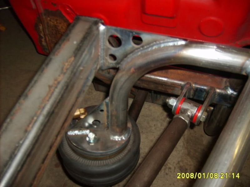

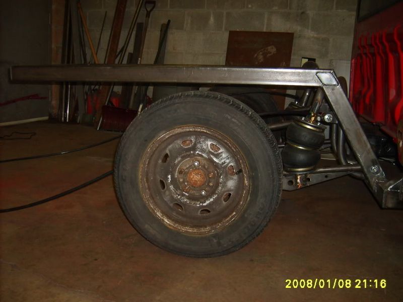

heres some more pics with the 4 link installed and a revised drive shaft hoop...

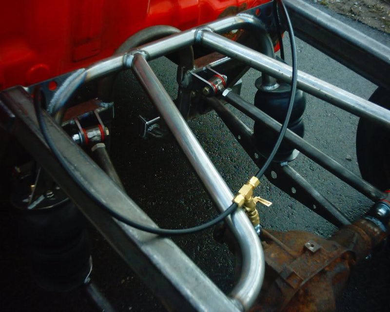

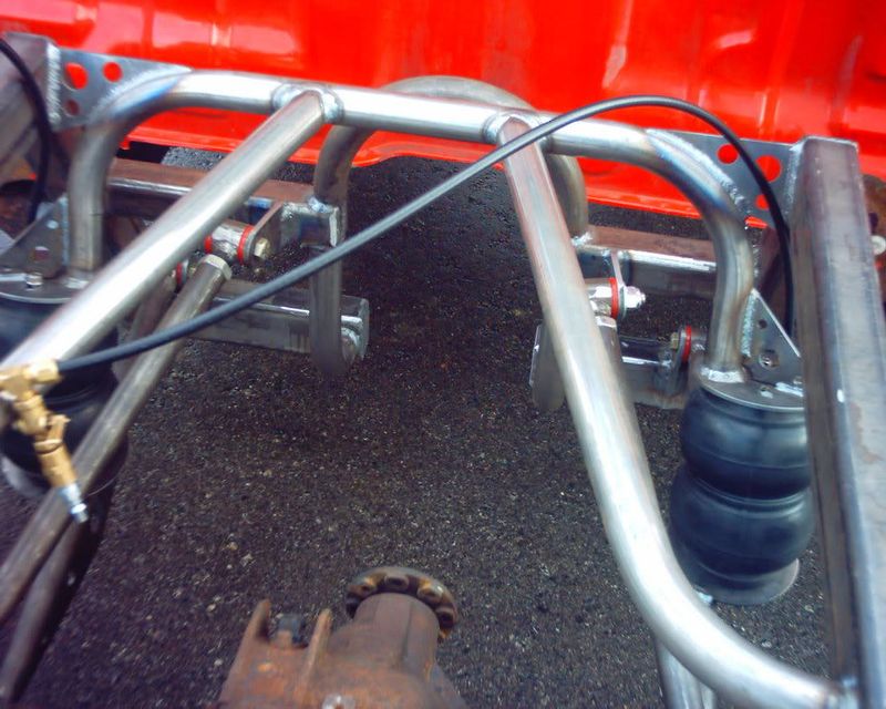

The pinion angle only changes 2 degrees thru 14 inchs of travel and it tucks waaaaay up there...
