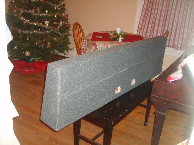

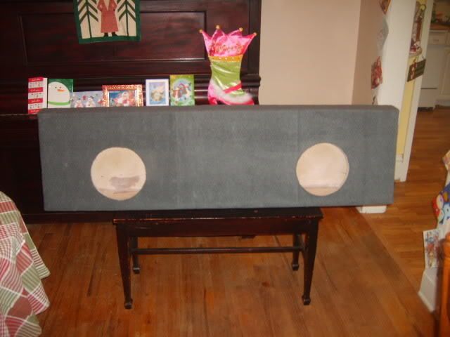

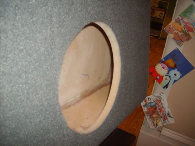

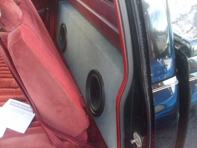

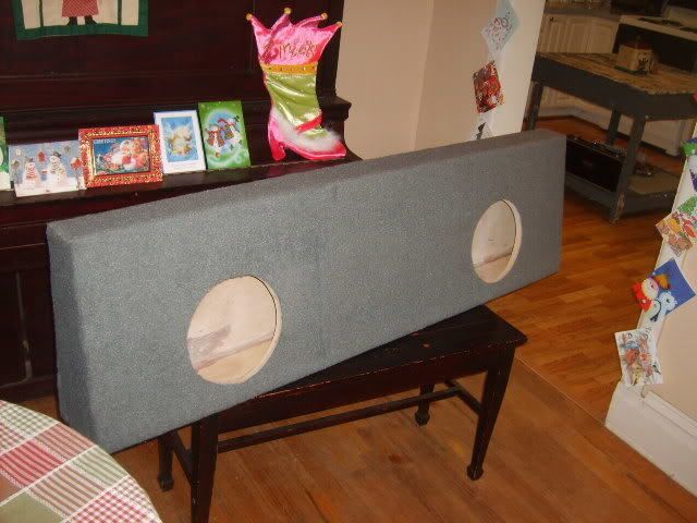

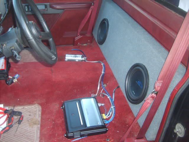

Ok guys i no its not mazda related but its still a lowrider I just wanted to post some pics and see what everyone thinks,this is the first mdf box i have ever made i just wanted something clean and simple for the daily. So i really didn't wanna spend the time to glass one for it... Anyways its built for a 92 GMC Seirra Sport single cab, it was built to hold 2 10" Alpine sws-1043d's since the box is so shallow i had to built it the full way across the rear cab wall to get the right cubic ft. on each side... I will get some more pics of the setup once the sub gets here to show u guys how tight the room actually is the amp & capacitor had to go under the seat... Anyways here they are let me no what u think!

Cool man, looks like it will work!
Are you going to get some terminal cups for the back for wiring?

yeap i have them i just haven't put them in yet, oh yea i forgot to mention its 3/4" mdf sealed with 1.20cb ft on each side with a center divider..

3/4 is fairly standard for a sub enclosure!
Should work fine...can't wait to see the install!

thats a really good looking box for your first time!!!!sure you haven't done that before?!!as long as you got the right amount of space inside it should sound pretty good!!

ok guys just tracked my order and it looks like it should be here by tuesday so once i get them in i will post pics with the seat out...

Looks good, keep us posted. Although, what did that cost you to make. Can't you buy them build cheaper?
baggedb22
cost $22.00 for a 4'x8' peice of 3/4" mdf, about $4.00 bucks for caulk, $10.00 on the wire connector things for the back of the box, and $10.00 for the material to wrap it so i have about $46.00's in the hole box, I didn't want a prefabbed box b/c i wanted it to fit prefect, and not look out of place like most do, also its impossible to find a box for a single cab that u can still slid the seat the holeway back, and alot of the cheap boxes are built out of 5/8" mdf...
