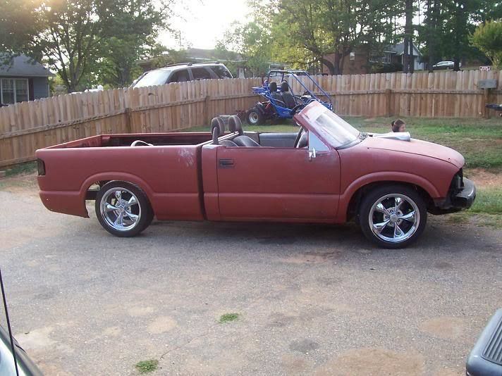

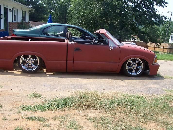

I just thought id share a few pics of my S-10 and my buddys B2200 we've been working on lately.
88' B2200...as of right now
bagged all 4 corners...front has RE6's and rear has RE7's

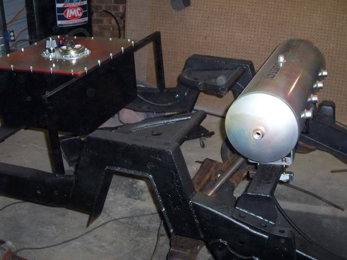

(2) Viair 460 comps
3/8 SMC valves
(2) 5gallon SS tanks (not on yet)
4linked
next few days:
tanks and valves will be plumbed
shaving door handles
shaving antenna
finish cutting bed and putting back on
cleaning all the brake lines and shit up so it dont look like shit

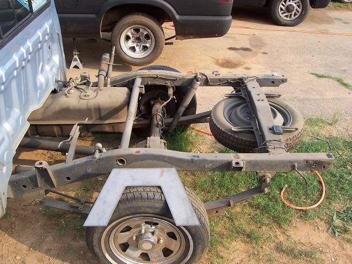

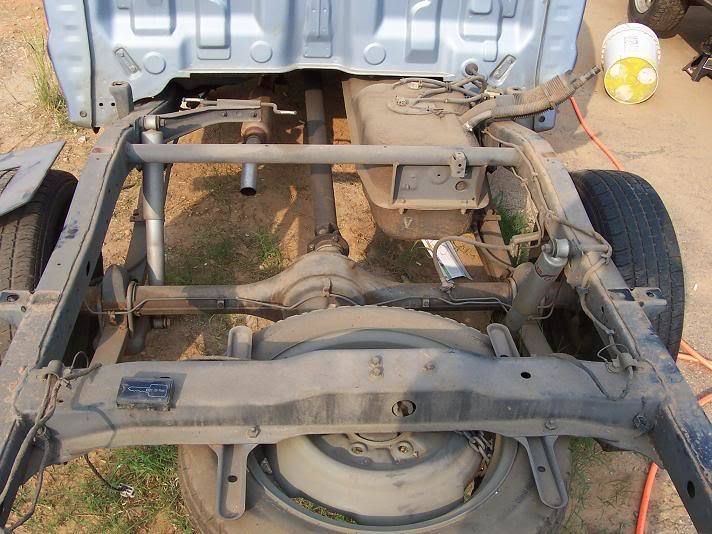

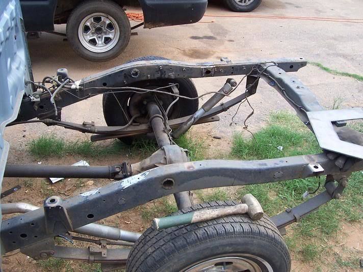

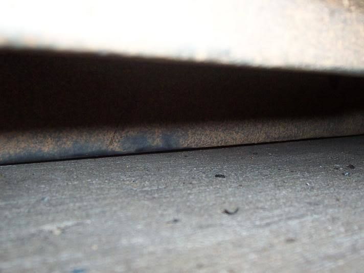

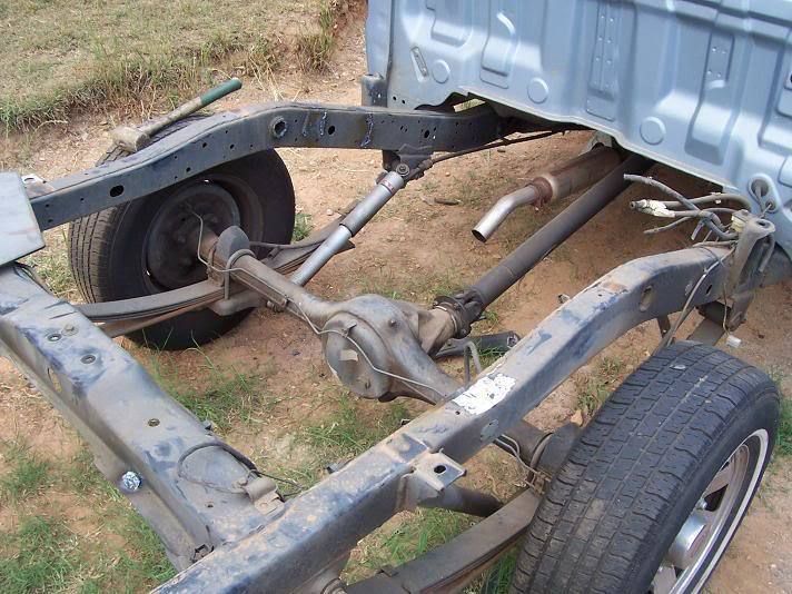

all together we have about 40 hours of work in the whole bagging process, it took a little longer than i expected because this was my first import truck ive bagged and all i had to go off of was some pics we found on this site (and 3 of the 5 pics i had to go by were wrong...the front brackets were welded in wrong and when i did these the same way, it wouldnt lay) anyways, we finally figured it out and it lays frame front to back now...heres a few pics
this is what we started with
a little cutting
these were from a few mins ago

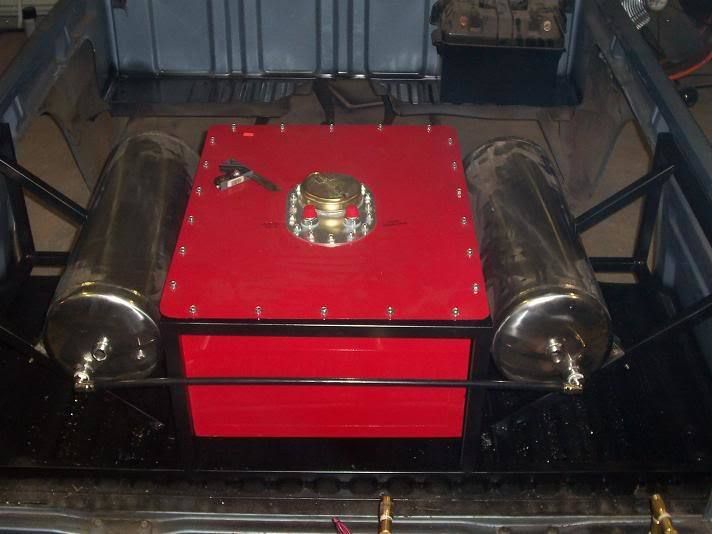

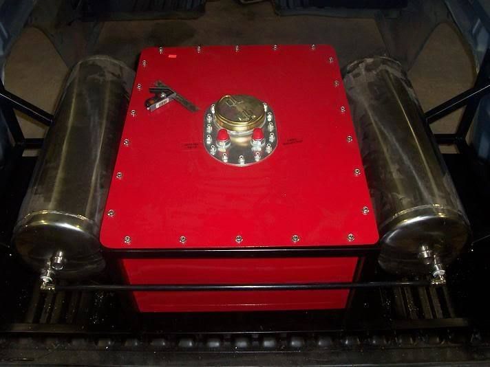

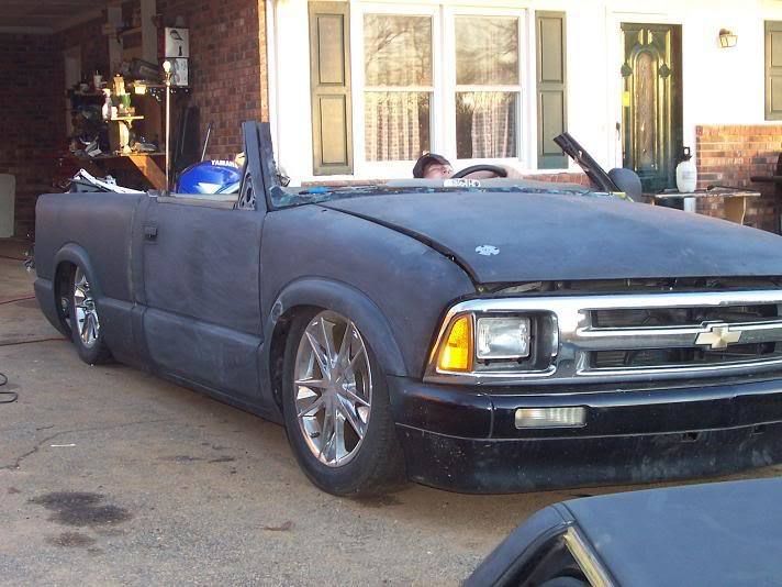

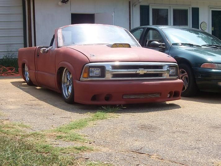

mine:
94 S-10
2.2 ditched for an early model chevy 350 (mildly built and leaks oil)
T5 tranny

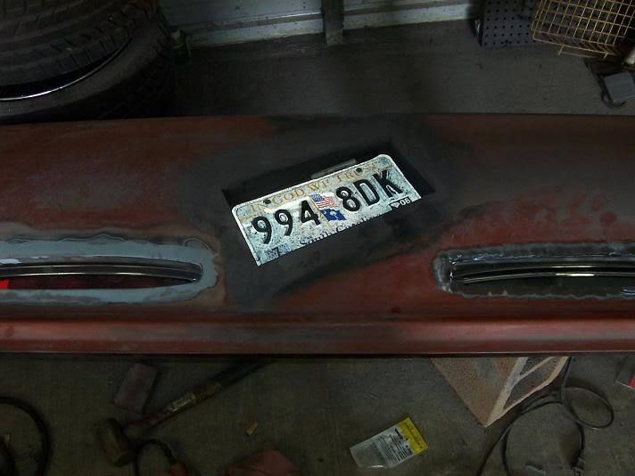

shaved tailgate
fulltime convertible

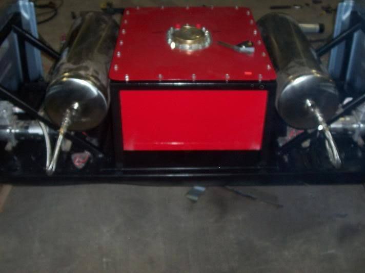

dakota digital pressure gauges
(2)Viair 450's
1/2" SMC valves
RE6 up front RE8 out back

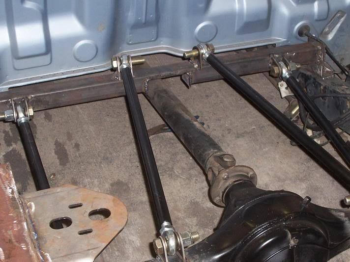

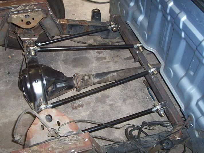

wishbone 3link
15 gallon fuel cell
modded controll arms
17" Crager S/S wheels
Honda Civic seats
motorcycle mirrors
suicide hood
to come over the next month:
get caddy tails put in
finish sheet metal work inside
get headers to stop leaking like hell
cut headrest off the seats
finish shaving the doors
finish the body work ive already started (windshield frame mostly)
make and weld in a tag box
weld on a rollpan so i can rip it off again
and finally paint

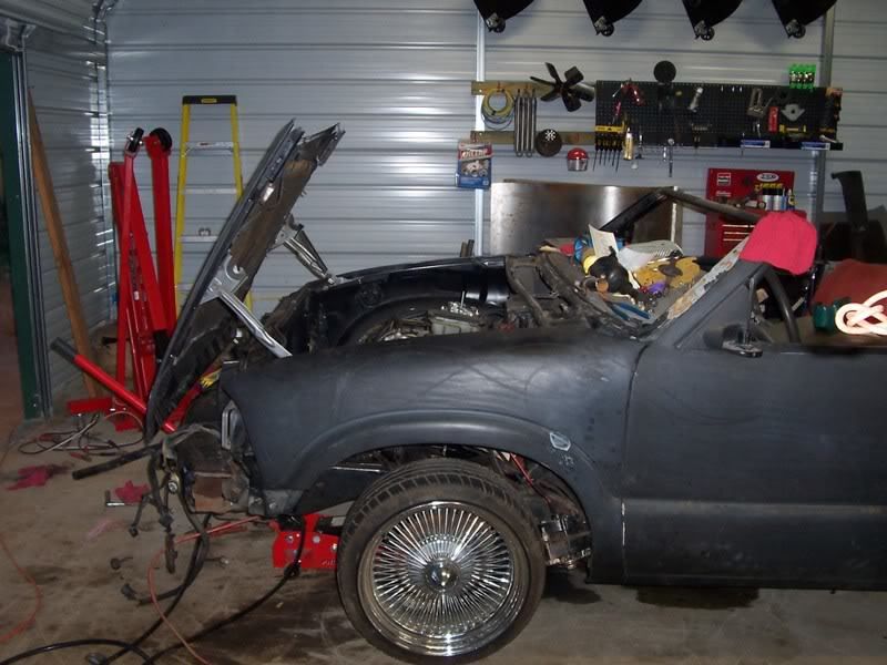

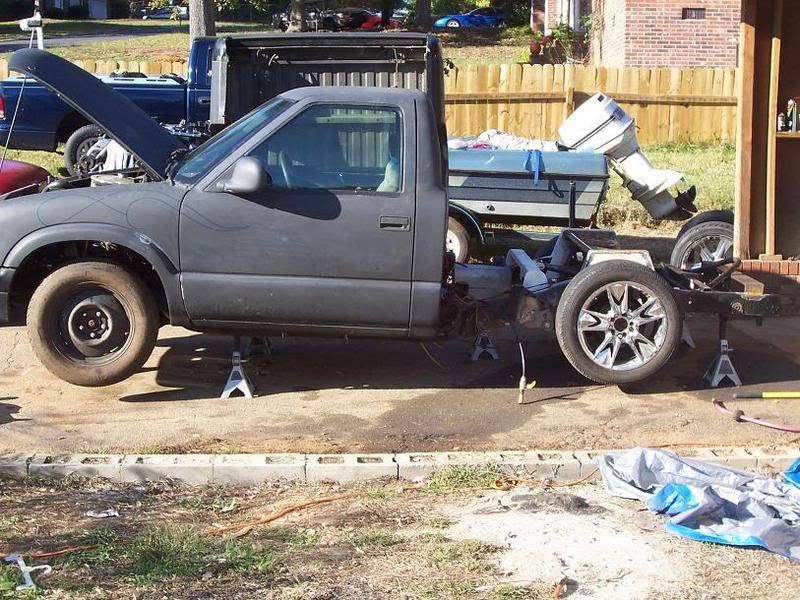

heres what i started with:

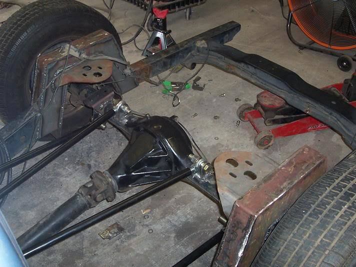

when i first welded the notch in
bridge welded in

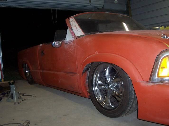

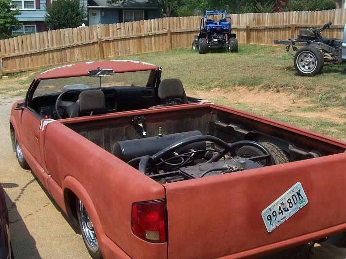

got bored one night and cut the roof off

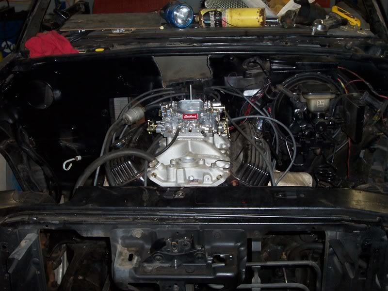

engine bay
suicided the hood

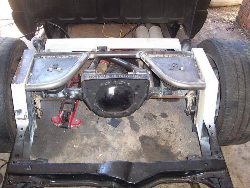

cut part of the bridge back out and started working on the rear again
rearend looking half ass decent here
pulled it outside...fully aired up
aired out
A few random pics ive taken here and there

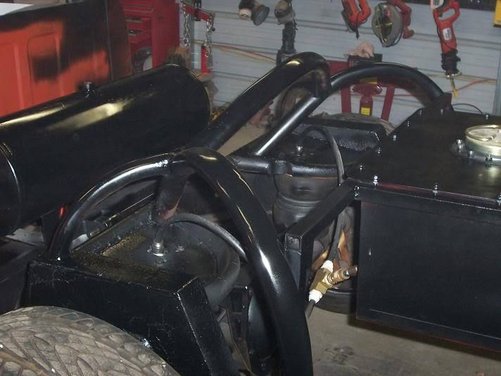

The upper bars on the Mazda need more triangulation.
lost_b2200
Just the pic or are the bag mounts on the axel angled forward?

will it hurt for them to be like they are? i thought they needed more triangulation too but i saw an assload on the web that were about where mine are.
I talked to you on the S-10forum a while back i think... about bagging the front...the 2 pics you sent me are the ones that helped me so much when we had to cut all that shit out and weld the brackets in at an angle to get it to lay.
_
_juice_
they do look angled forward in the pic but i walked outside and they look straight to me and i havent been drinking tonight yet....dunno man but they for sure looked screwed up in the pic
