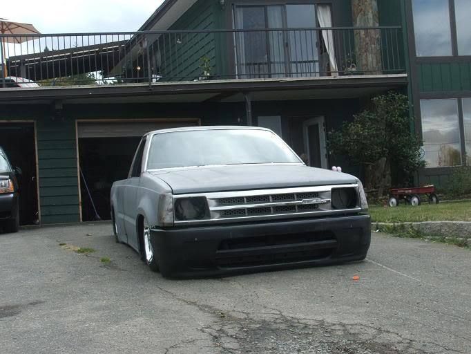

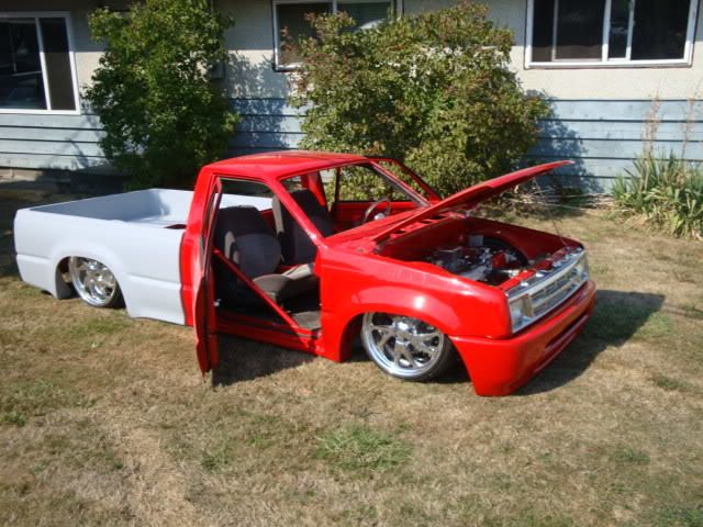

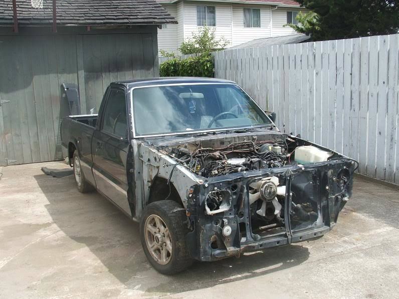

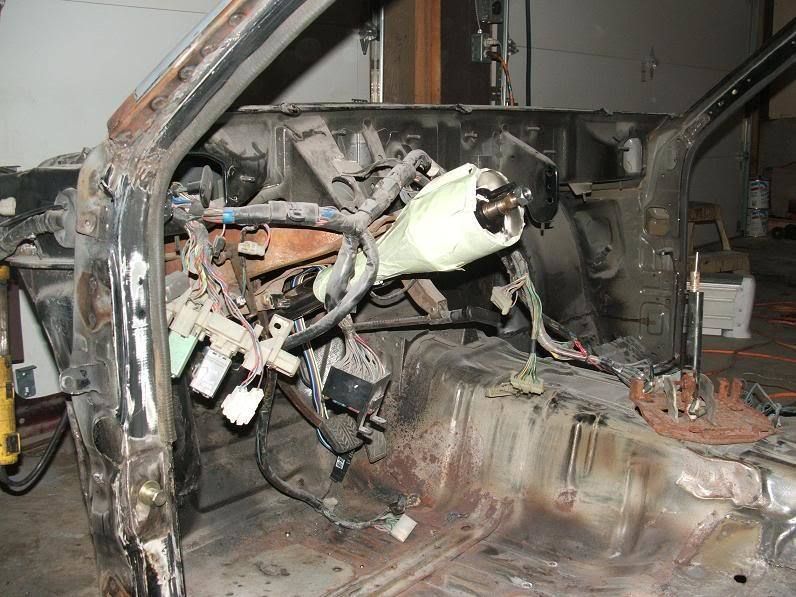

Hey, ok some off u on here might know me and have seen my truck which is currently being built. It's kinda a little late for this but o well. I'm sure lots off you would like to see the build off my truck .
1991 Mazda b2200 that i picked up for 400$ off a guys front lawn back in june of 2005
Here are a few pics the first day i got it

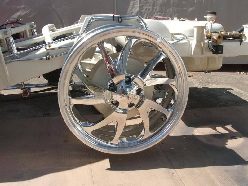

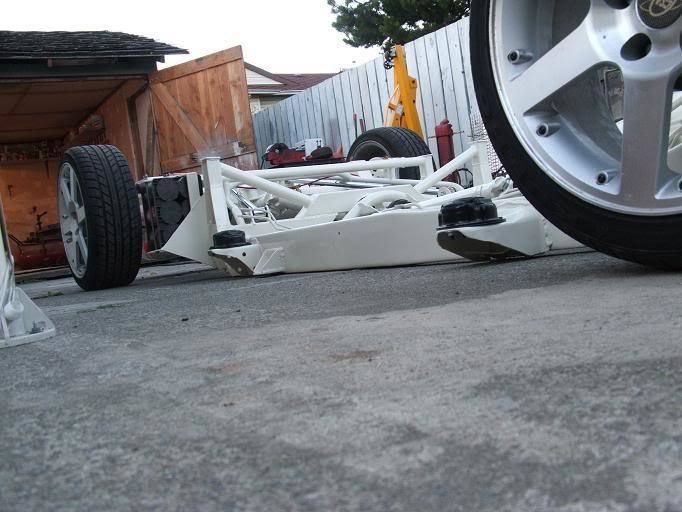

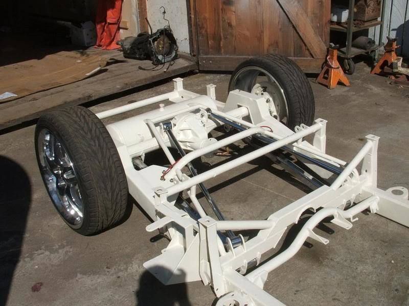

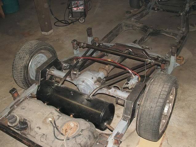

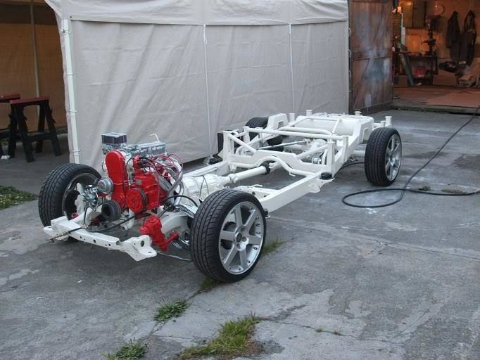

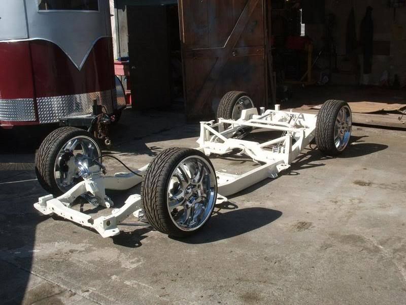

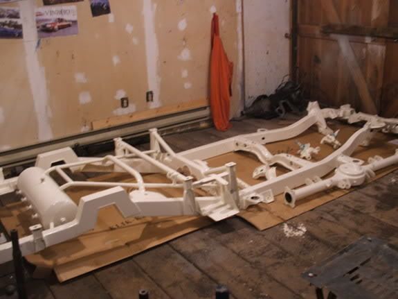

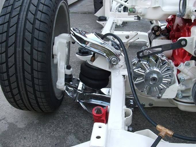

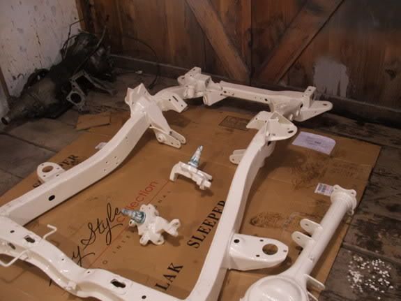

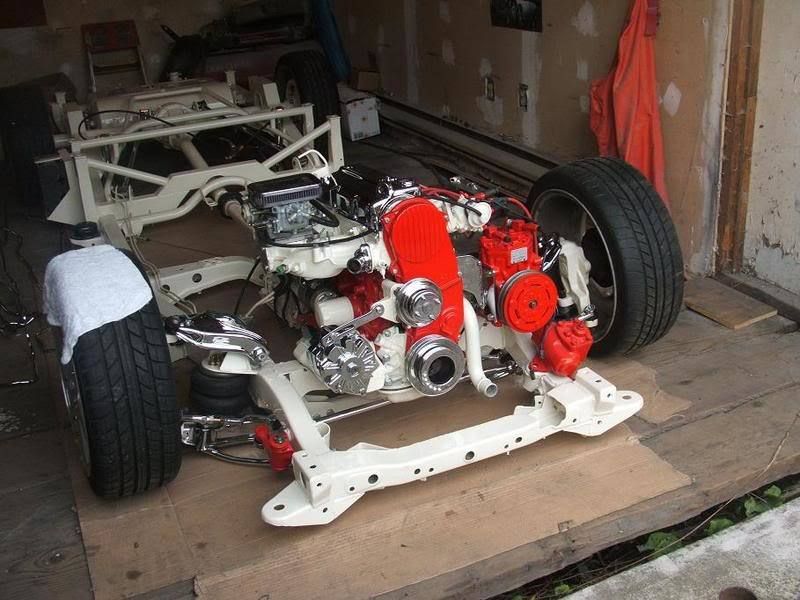

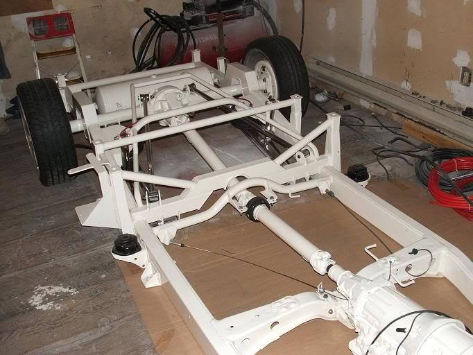

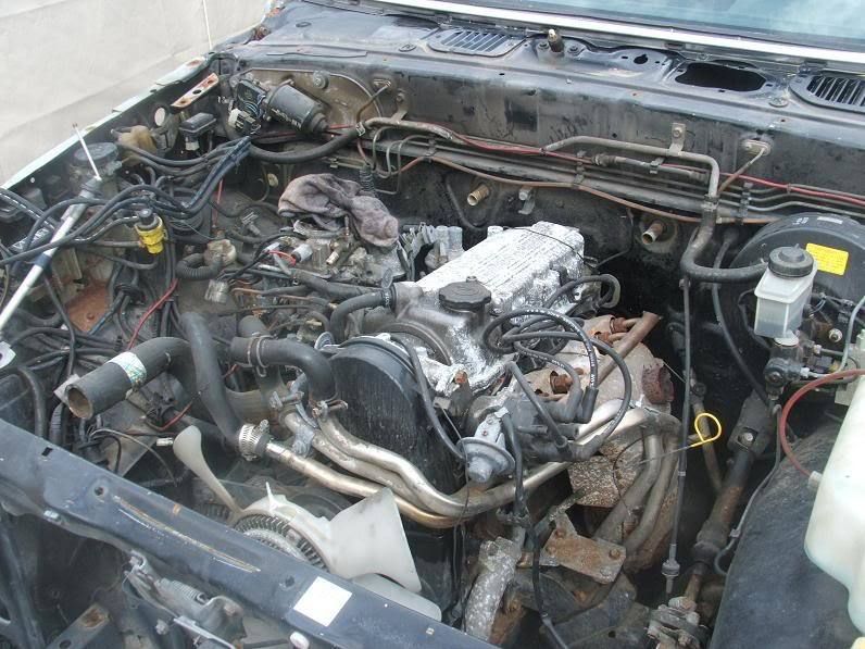

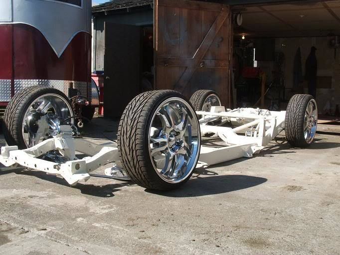

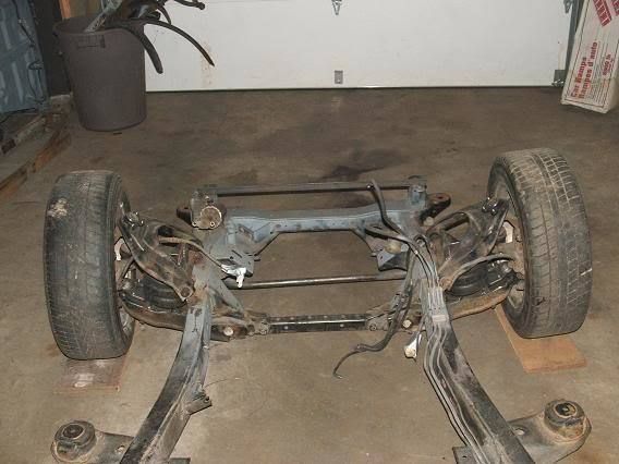

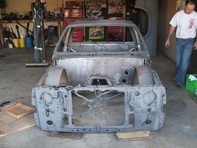

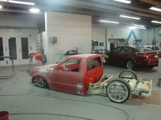

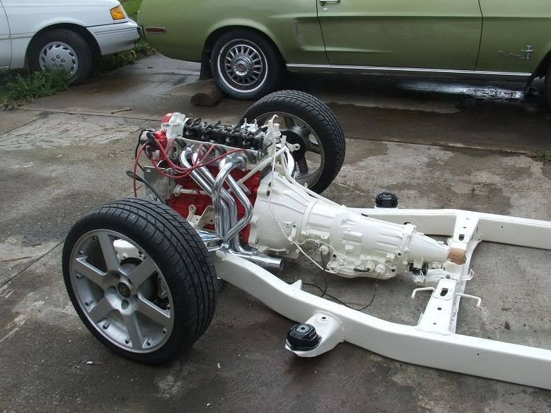

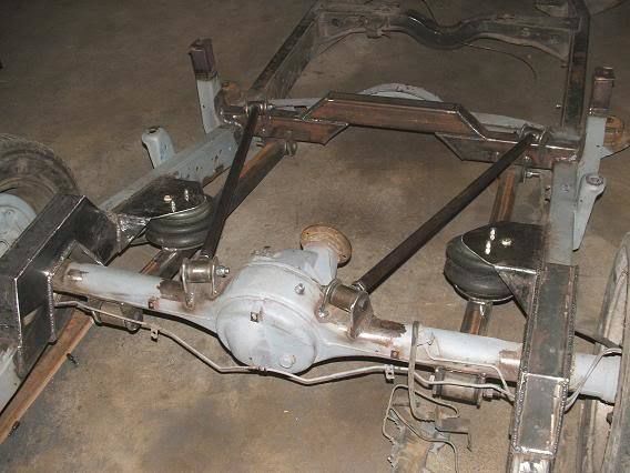

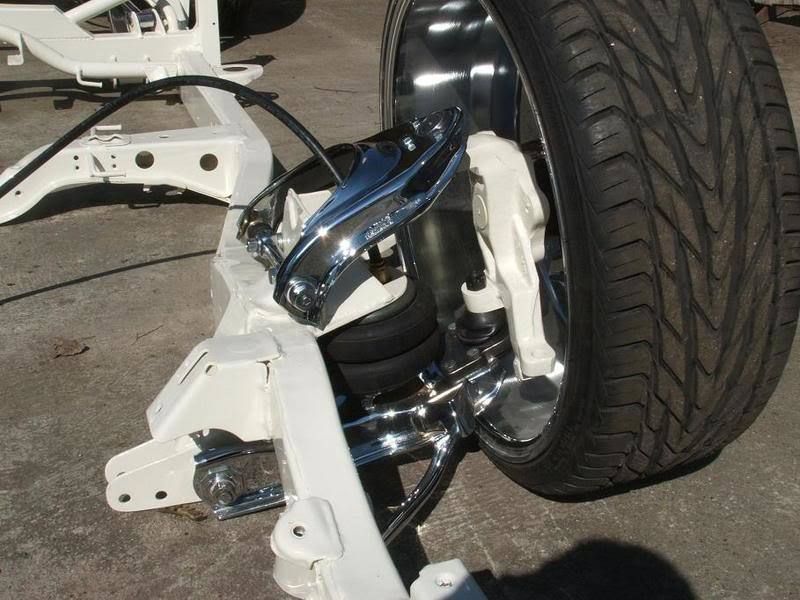

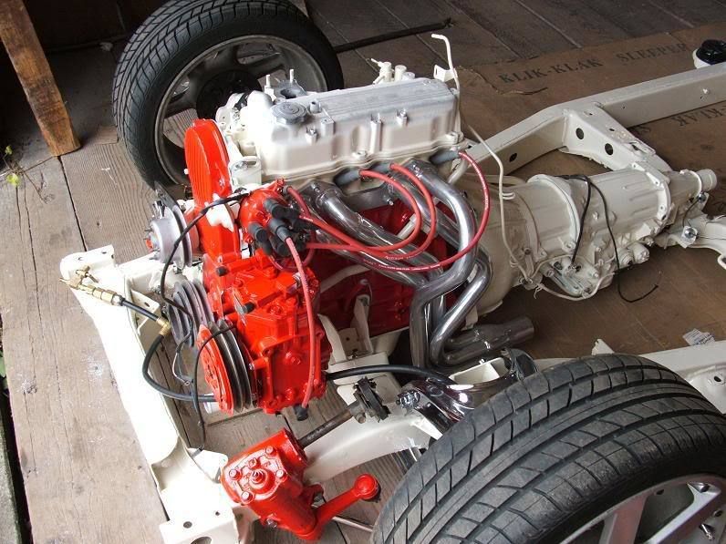

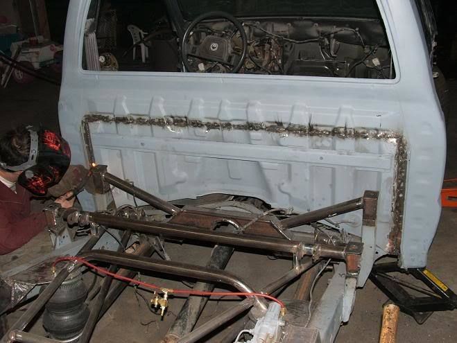

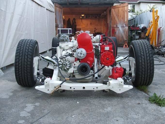

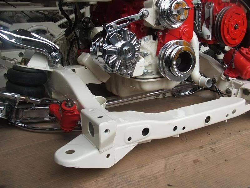

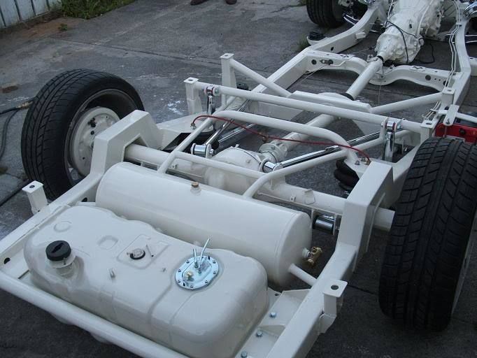

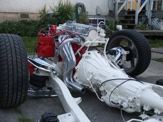

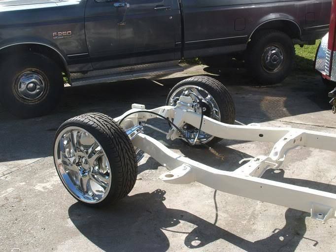

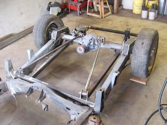

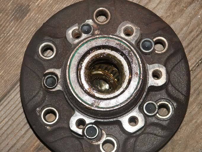

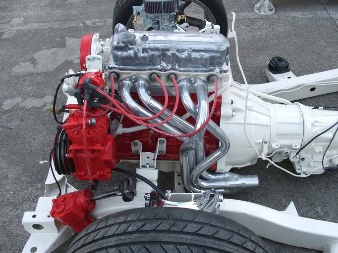

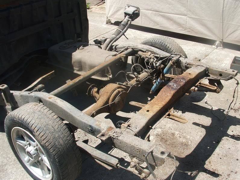

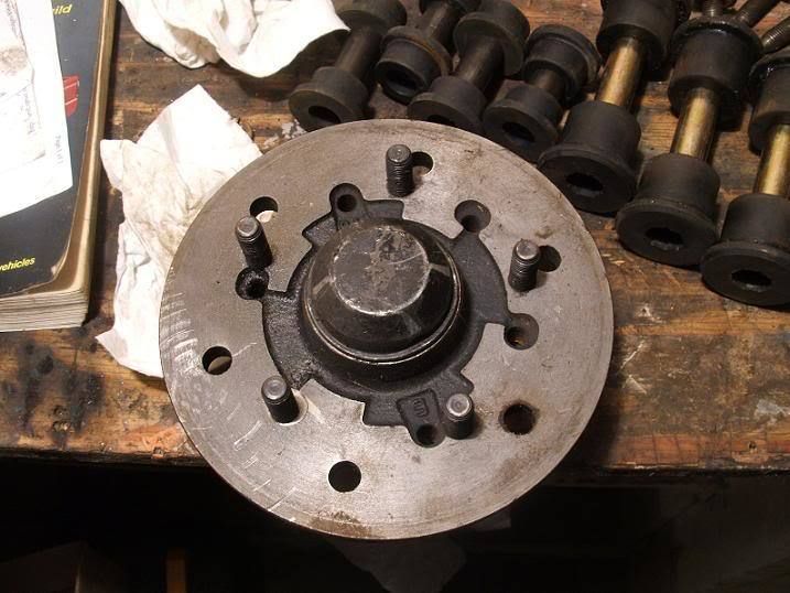

Next it went to devin Morgans house where it was all striped and we began on the suspension.

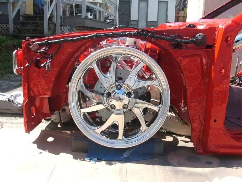

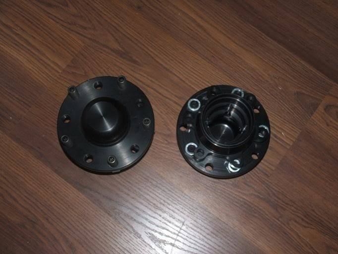

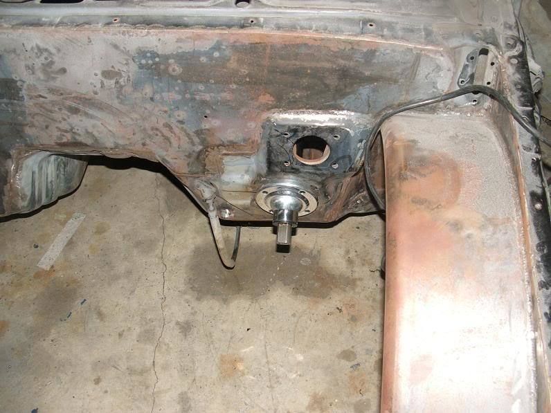

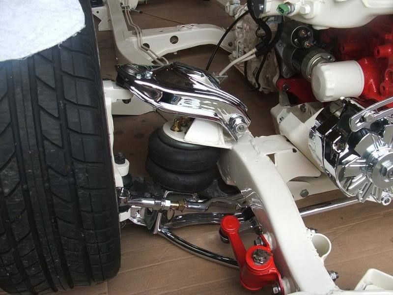

Front: Custom upper and lower mounts, aim spindles, firestone 2500 bags, reangled upper arms, redrilled hub

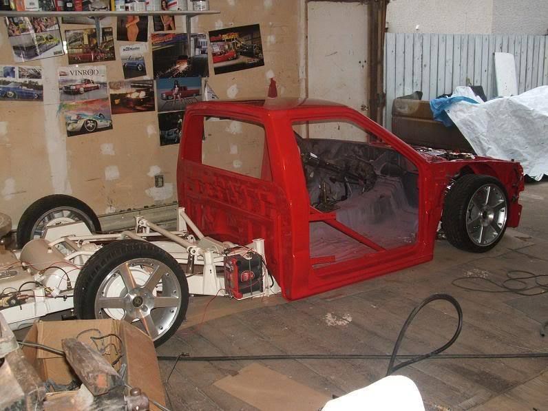

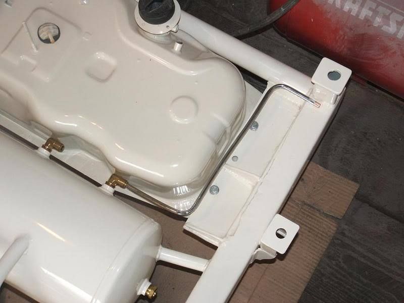

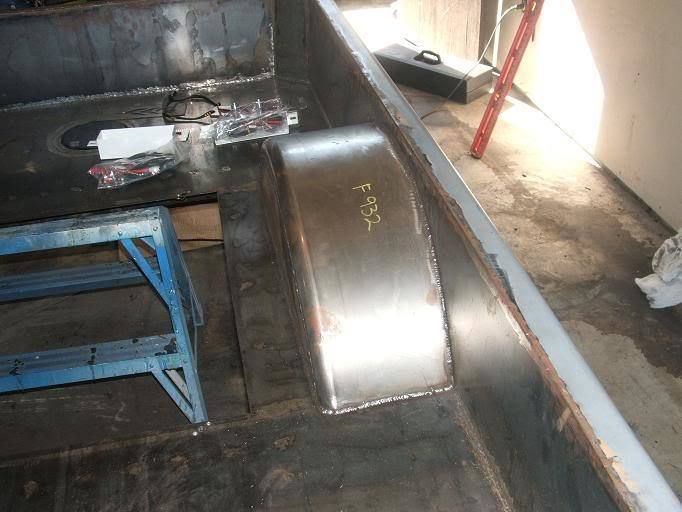

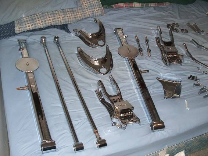

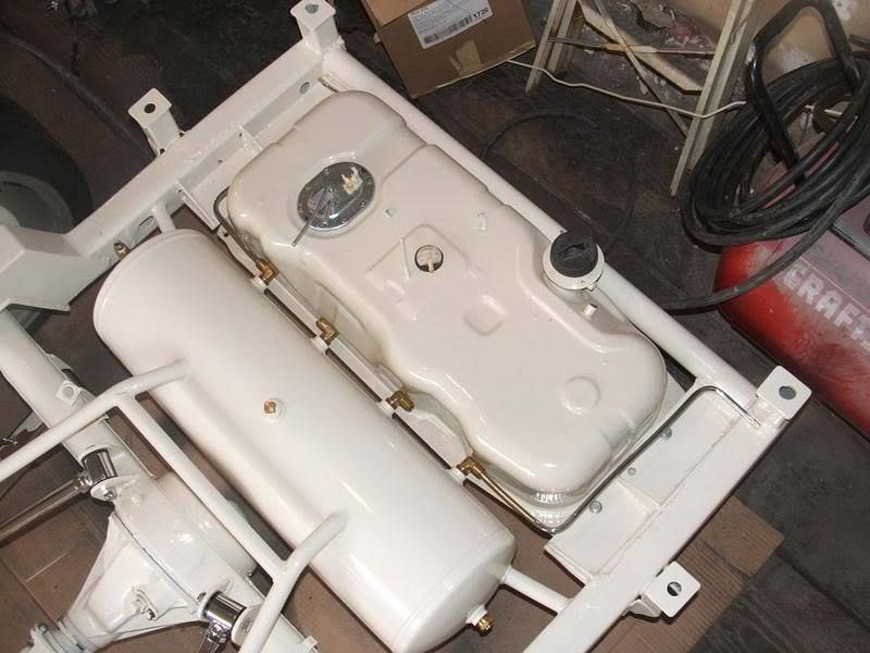

Rear: Foward 4 Link, Notch, Firestone 2600 bags on lower bars, 8 gallon tank welded to frame, custom tubing

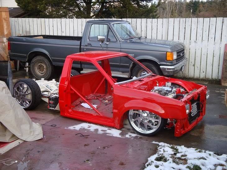

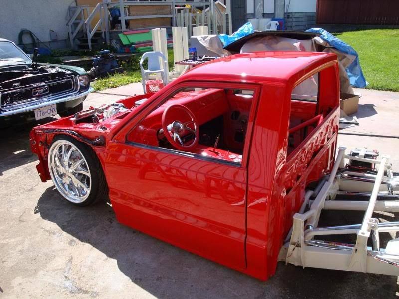

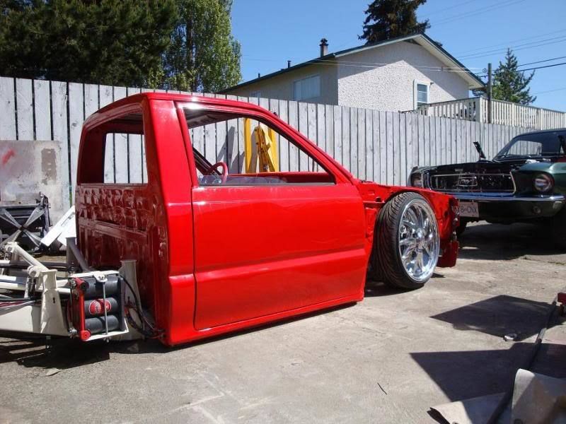

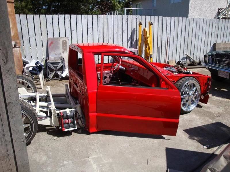

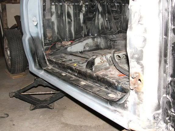

After The suspension was complete we did the body drop, 2 inches to the pinch, traditional body drop
flameds10(tyler)'s avatar
flameds10(tyler)

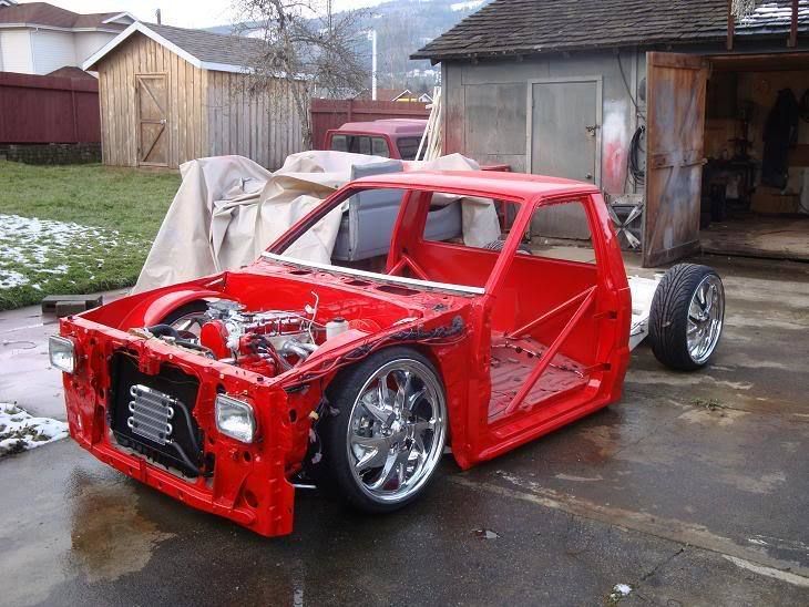

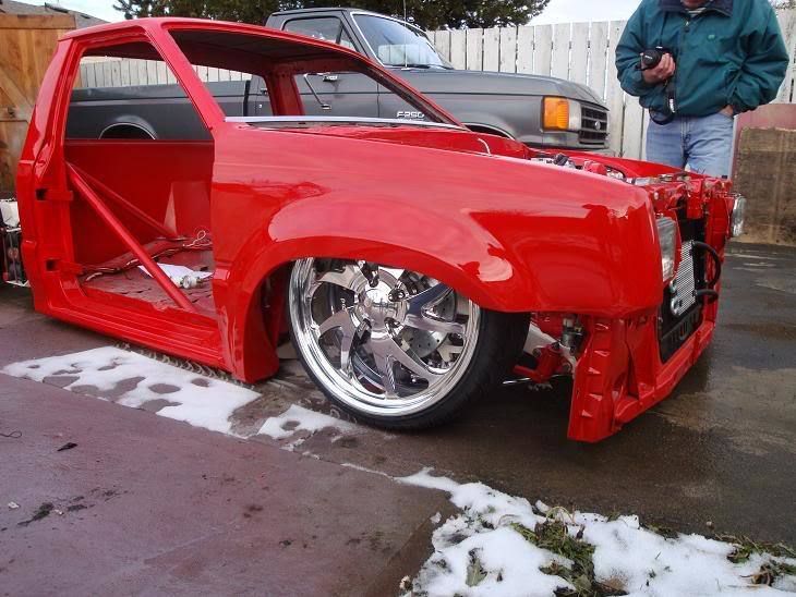

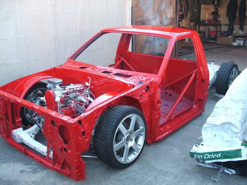

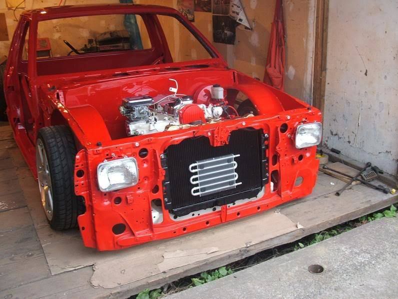

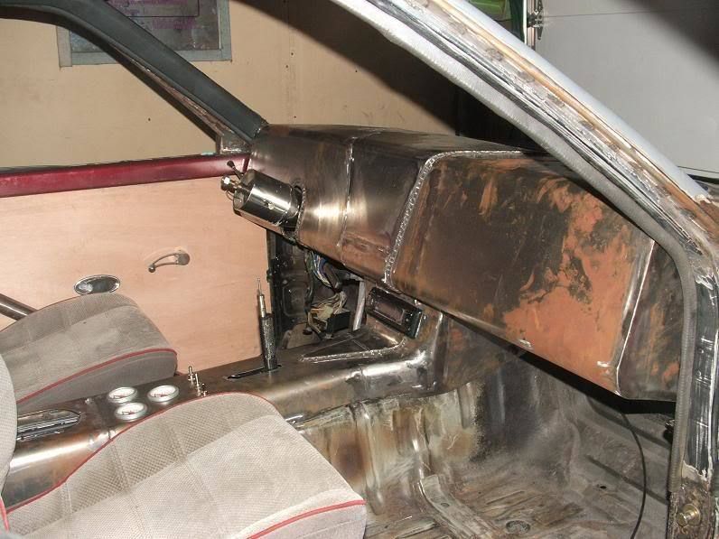

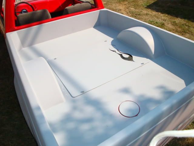

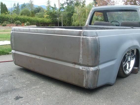

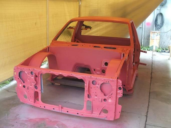

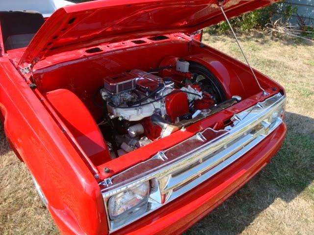

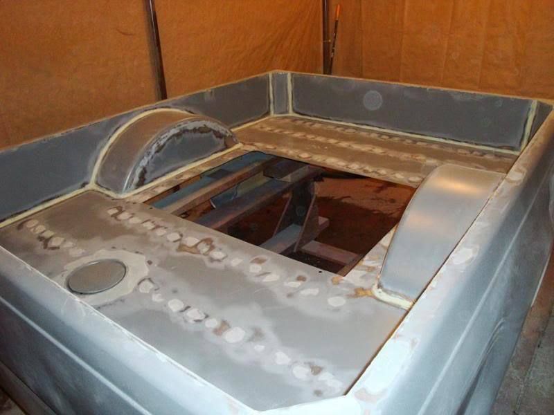

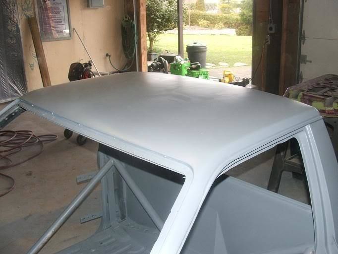

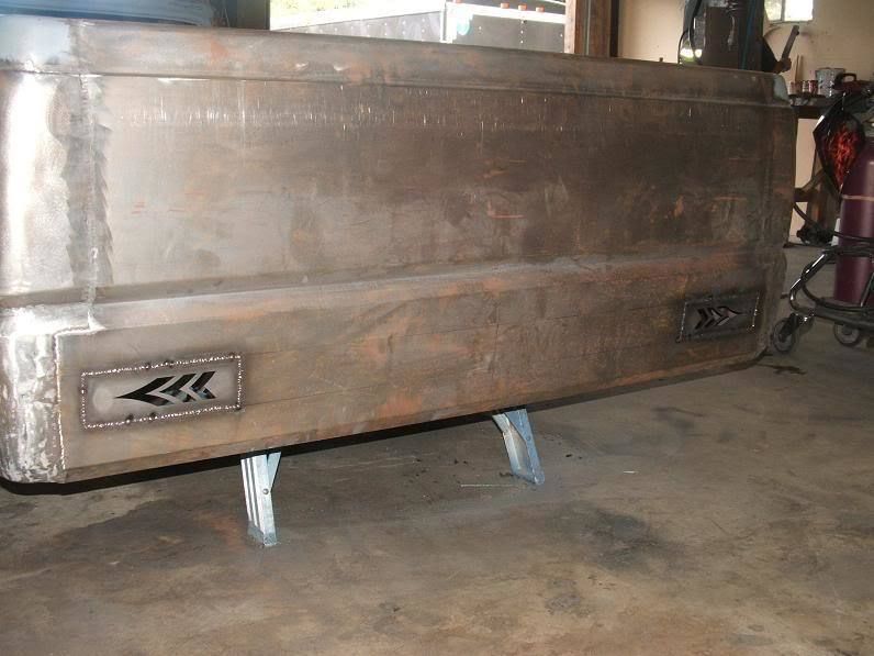

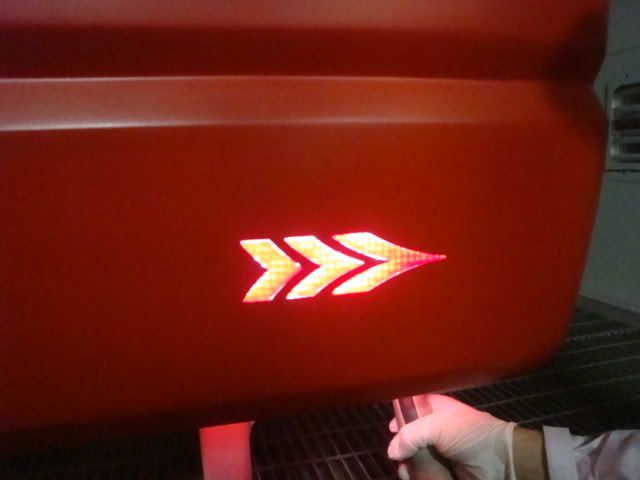

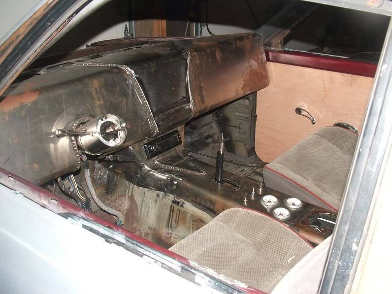

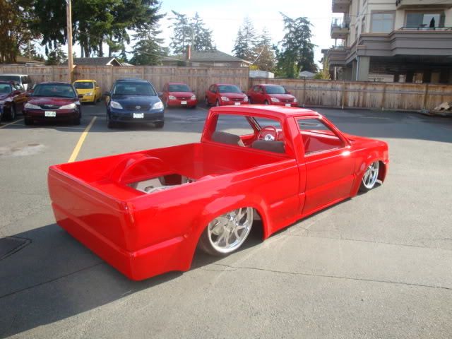

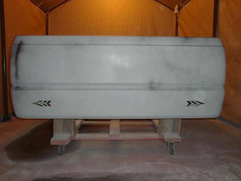

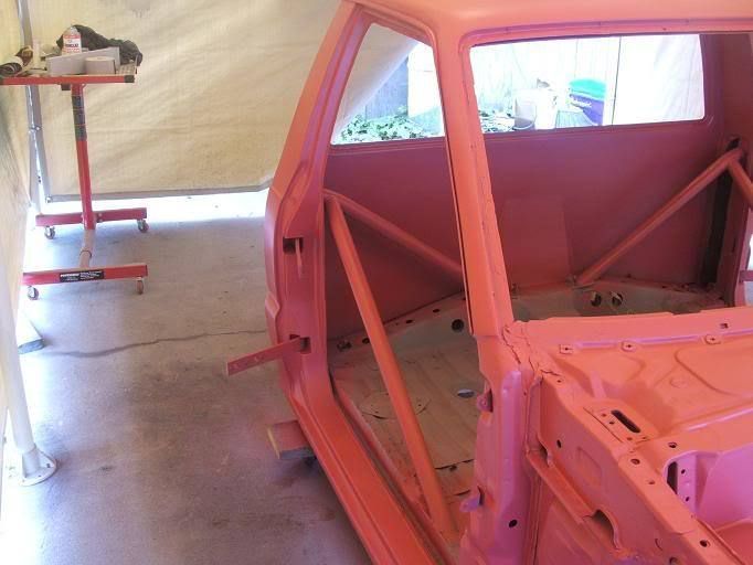

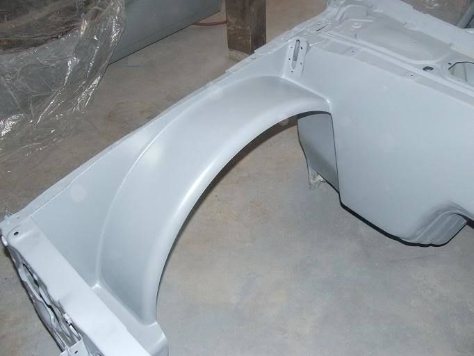

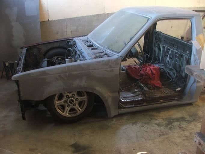

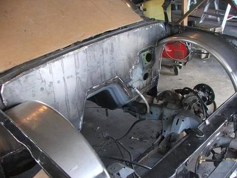

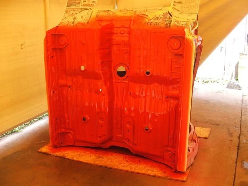

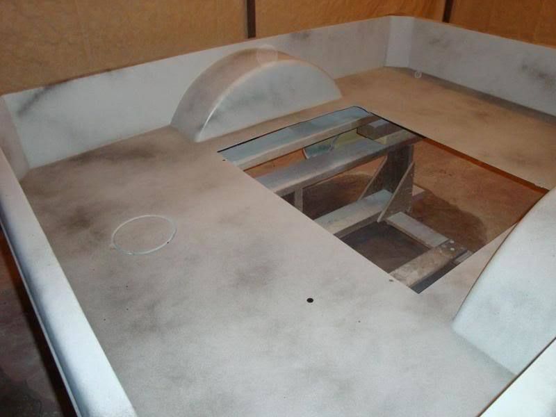

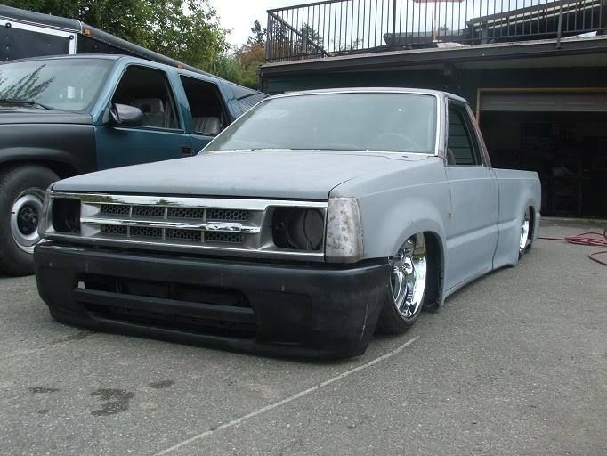

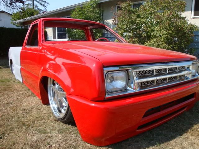

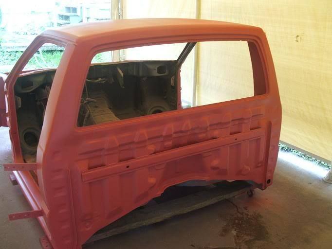

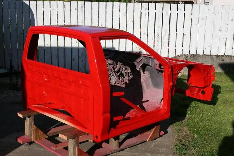

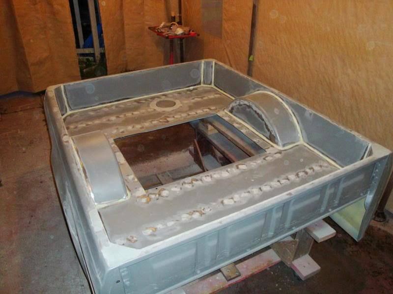

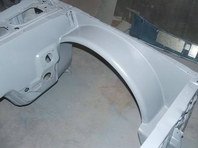

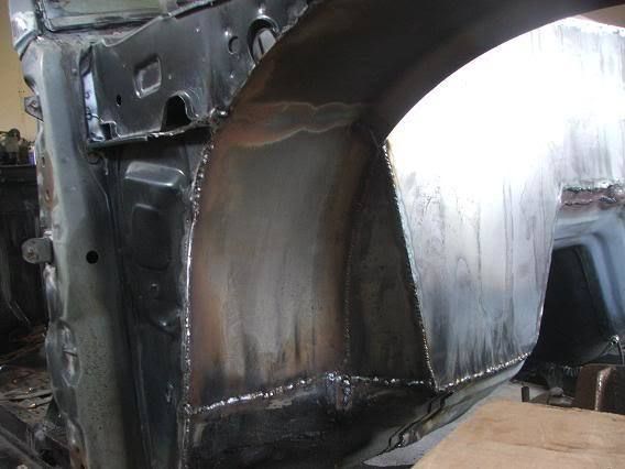

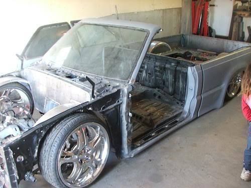

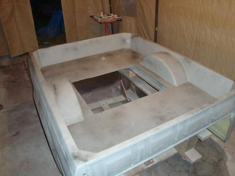

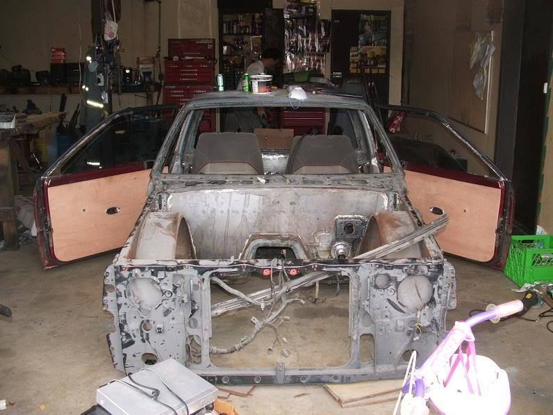

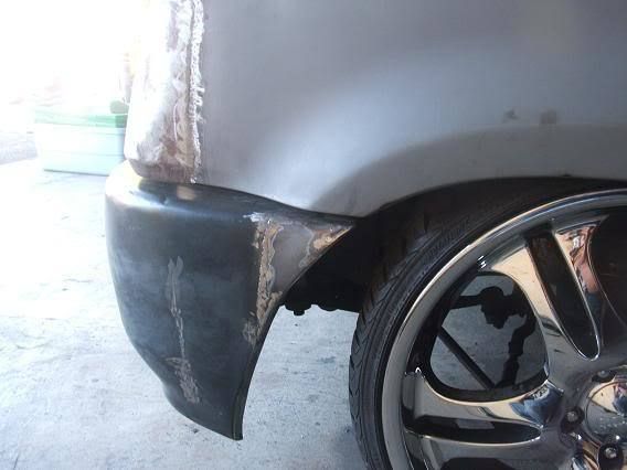

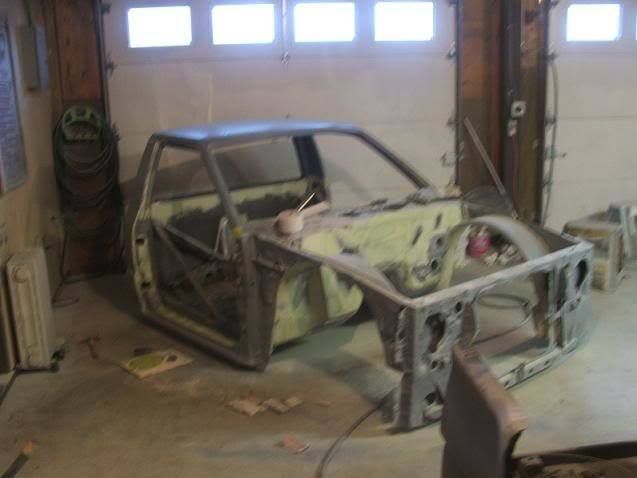

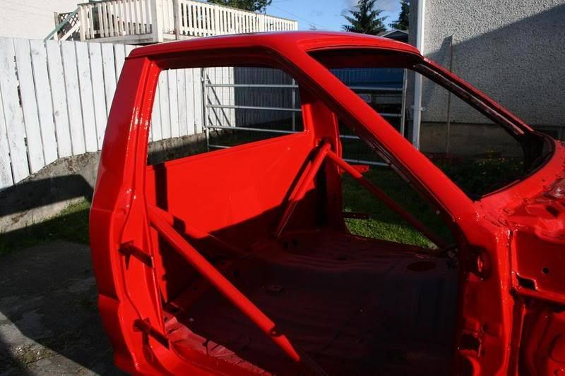

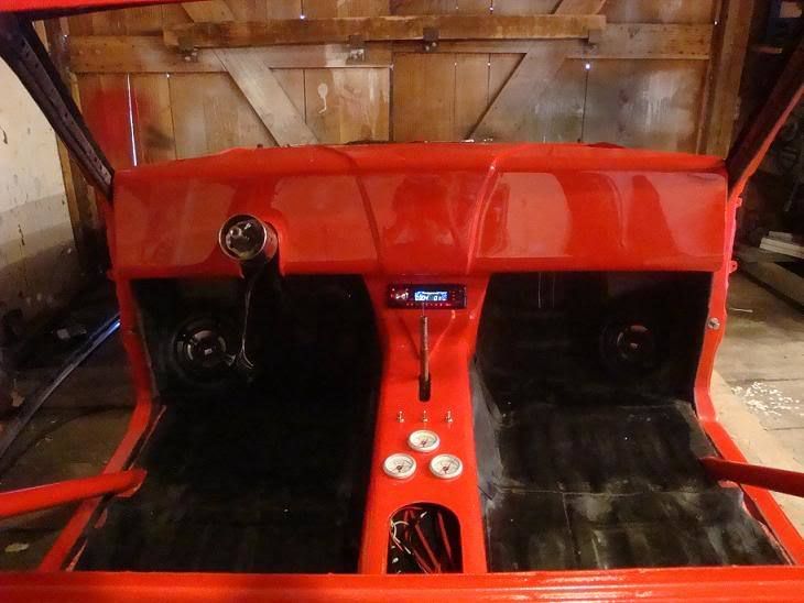

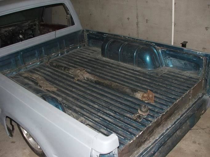

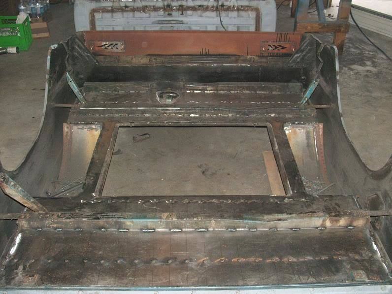

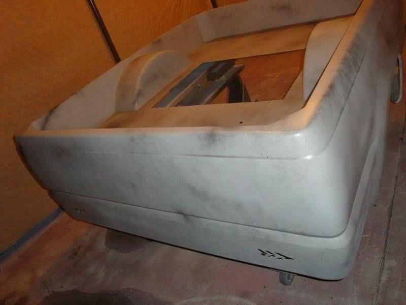

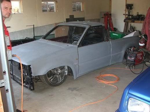

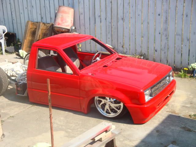

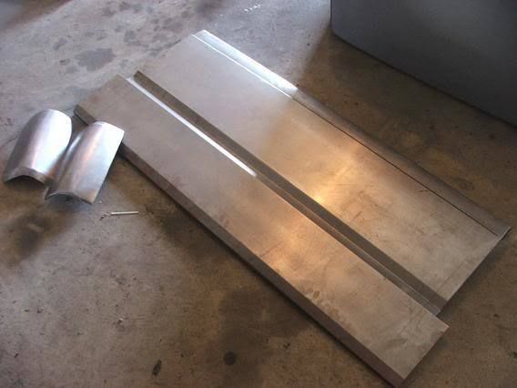

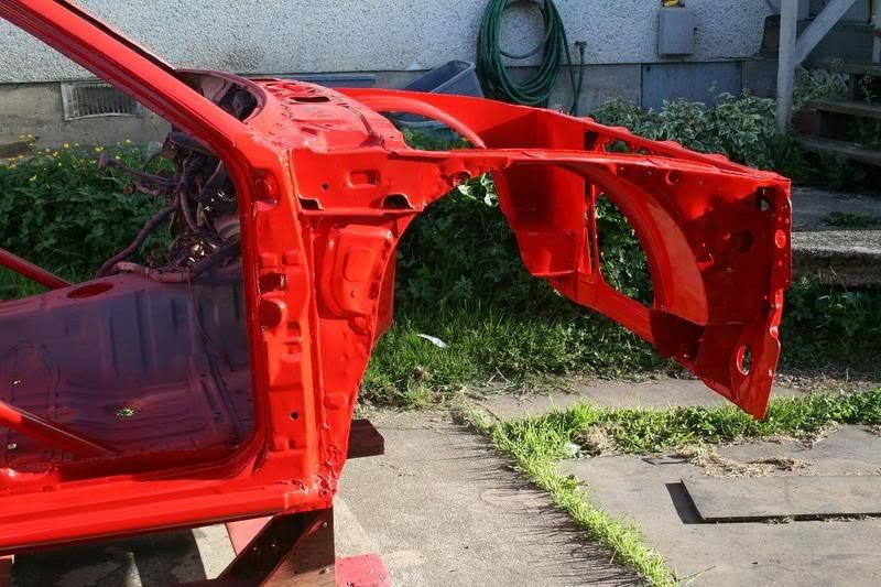

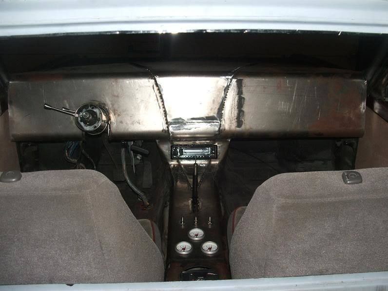

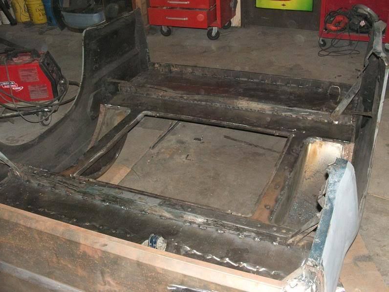

next came the body mods and sheetmetal work. This truck has the following mods. 2 inch stock window chop top (all stock glass), suicide doors, sheet metal bed, sheetmetal engine bay, grant kustoms combo, tail fillers, b-piller fillers, and corners,
Chop top
flameds10(tyler)

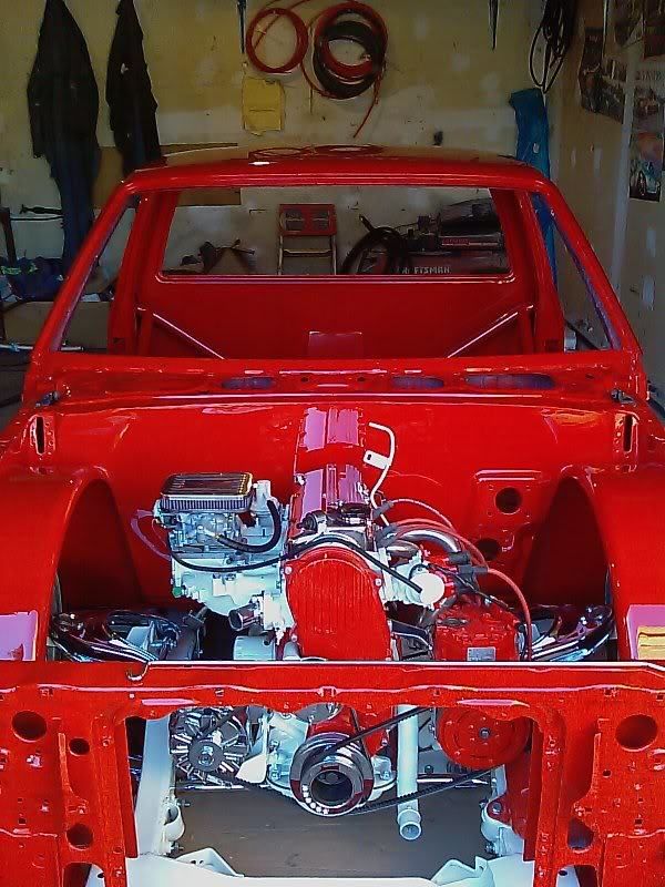

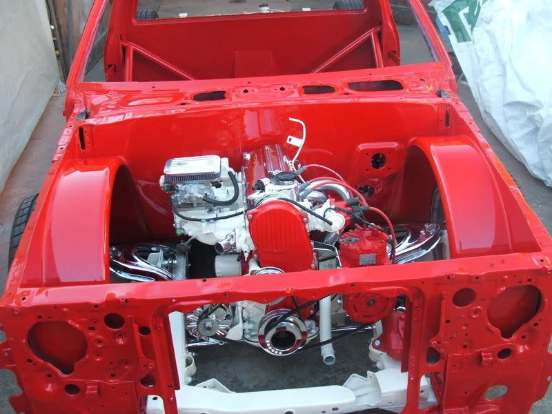

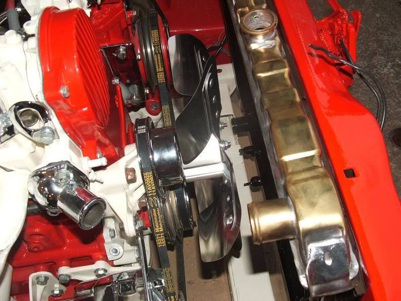

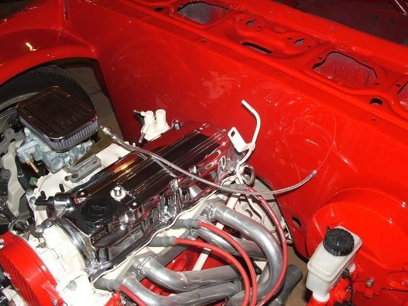

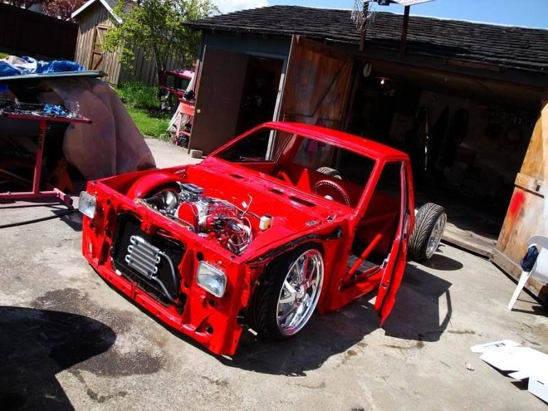

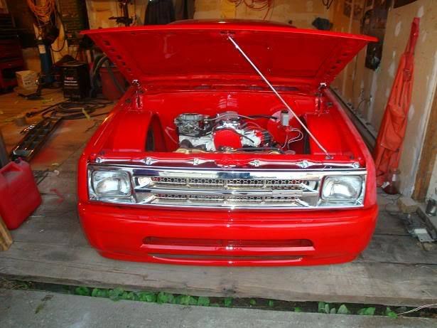

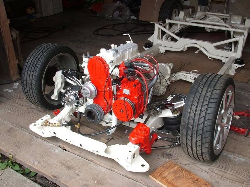

Engine Bay

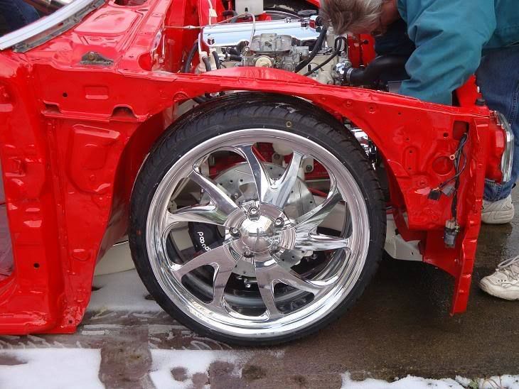

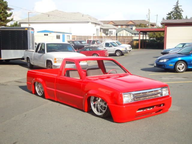

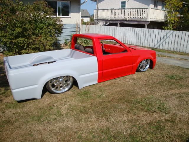

hey man, that looks pretty badass! i might have missed it but how bi are your wheels, and what front end are you gona use? -bf
flameds10(tyler)

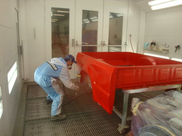

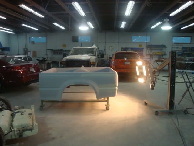

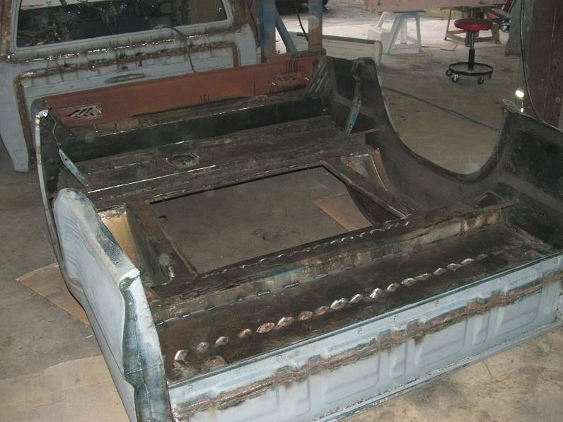

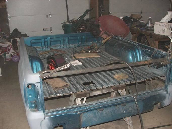

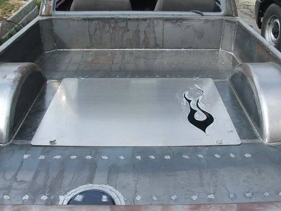

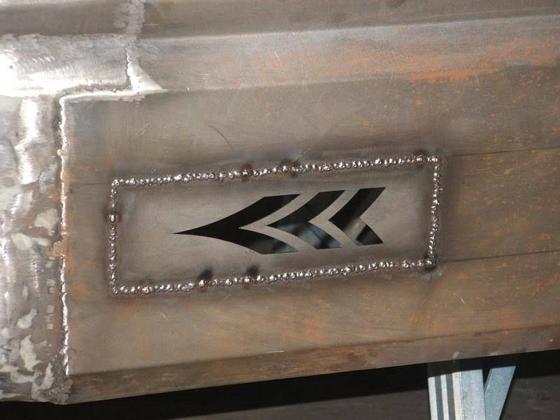

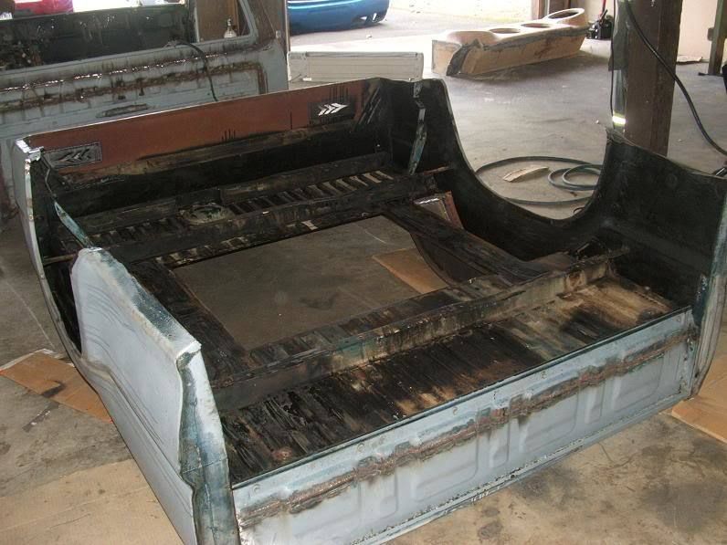

box and bed floor
flameds10(tyler)

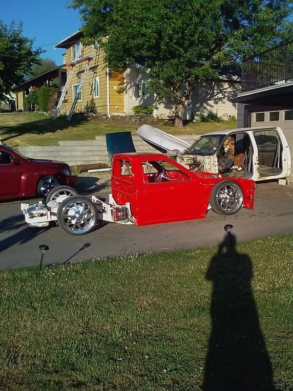

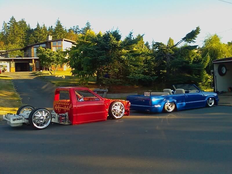

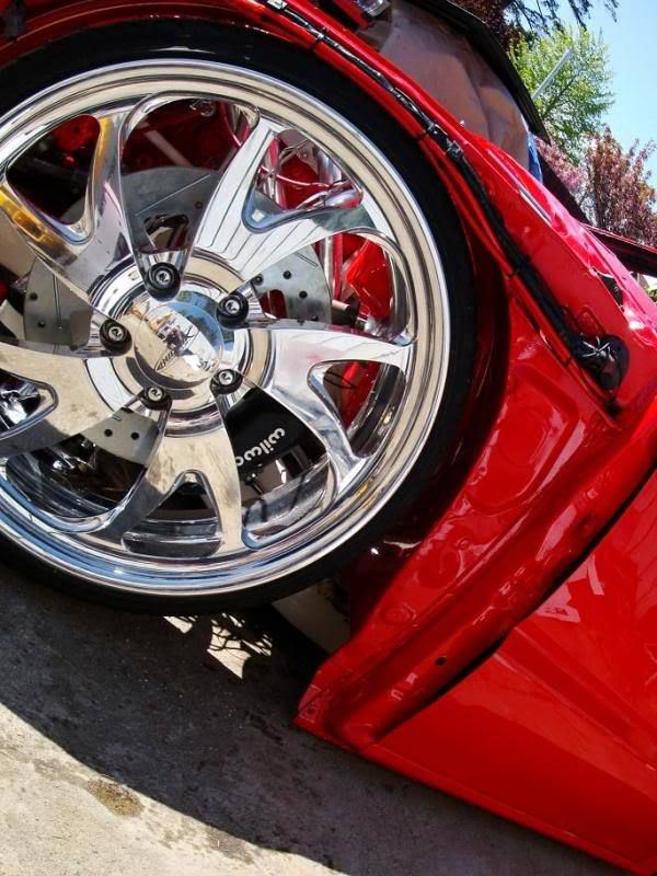

The wheels are 20's, just keep watching i'm updating right now
flameds10(tyler)

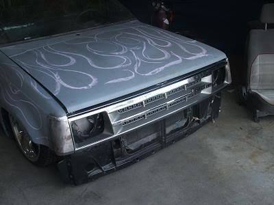

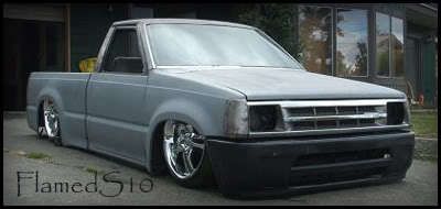

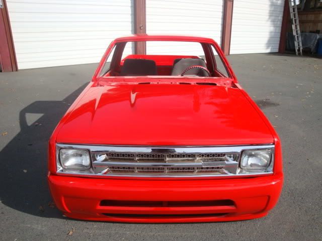

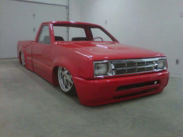

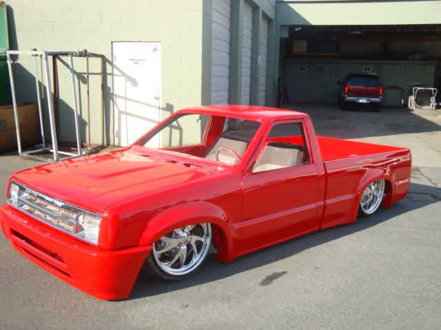

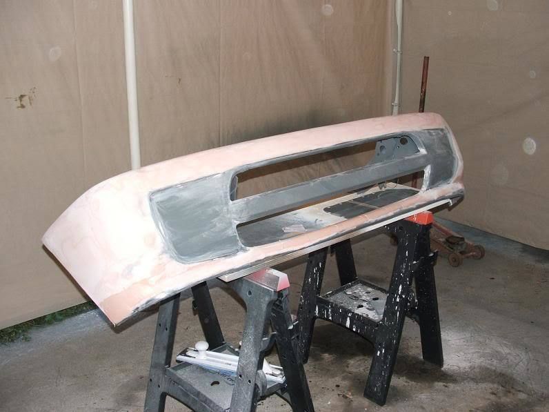

As for the front end its got shaved corners, chrome grille, and a streched Grant Kustoms front bumper
