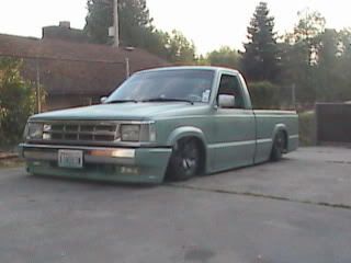

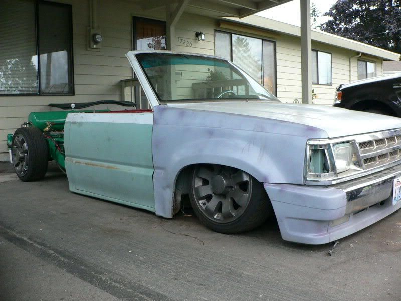

This is what we started with. This truck has needed a face lift for a damn while.

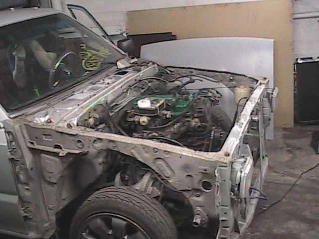

The front end was tore down, pulled the engine etc. Ill focus on this end after the rear is complete.

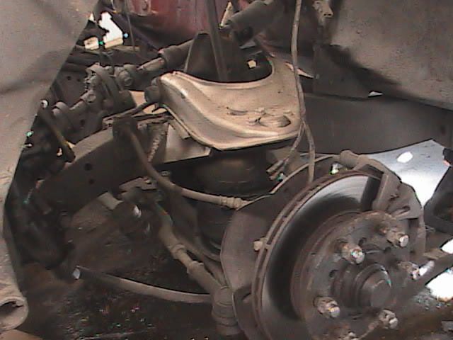

Airlift bags suck. all four are done. bands popped in the front, and the brass inserts pulled out in the back.

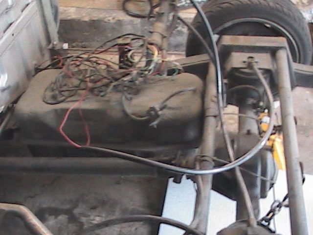

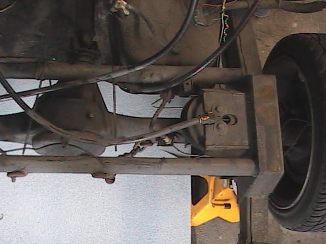

Heres what we started with in the back.

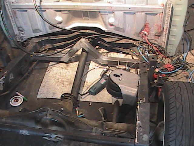

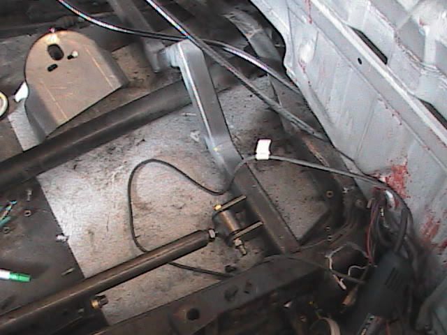

After cleaning the frame of all the old bag brackets, and swapping the axle the crossmember was built.
the bars have been layed out. next will come the bridges to mount the bags on the top bars.

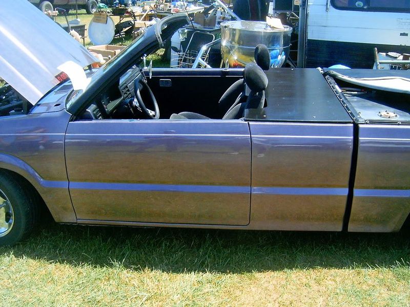

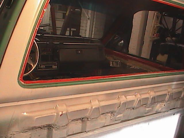

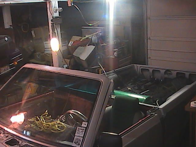

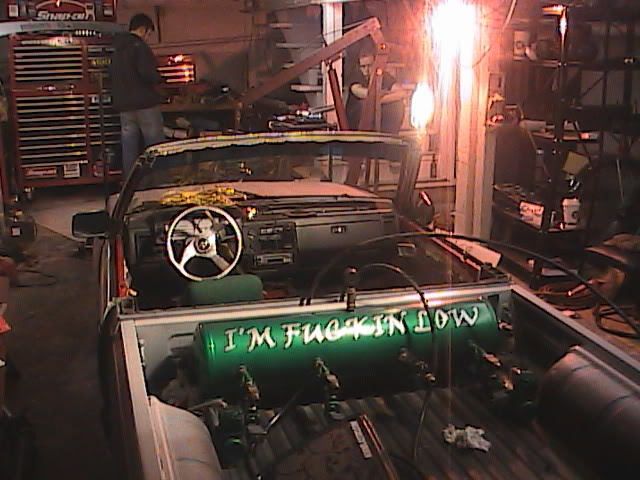

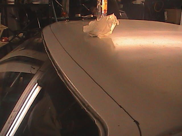

Heres the pics of cutting the top off. Pretty basic, but im gonna be cutting the windshield frame and glass down. at this height its way to tall.
Easiest way to get the cut line on top is to freehand it.
The line for the back was masking tape and spray paint.
Here it is.......

I really like the way it looks without the roof, I have always liked convertible mazdas, is a carson top a metal frame with fabric stretched over it?
-Mike
burnoutboy's avatar
burnoutboy
yeah, the frame shouldnt be to hard to make. I can have our upholstery guy at work cover it for me.

Why not forget the roof and just make it into a roadster. cut 3 inches out of the front glass weld over the door glass and put a nice clean roll bar behind the seats headrest high.
