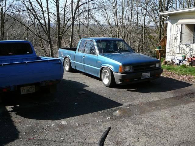

this pic is with the front down a lil more did it after work this morning
i think ill opt for some 195/50/15 next then some after market bumpstops... i cut the stock stops a lil too short and it hits kinda hard...lol
