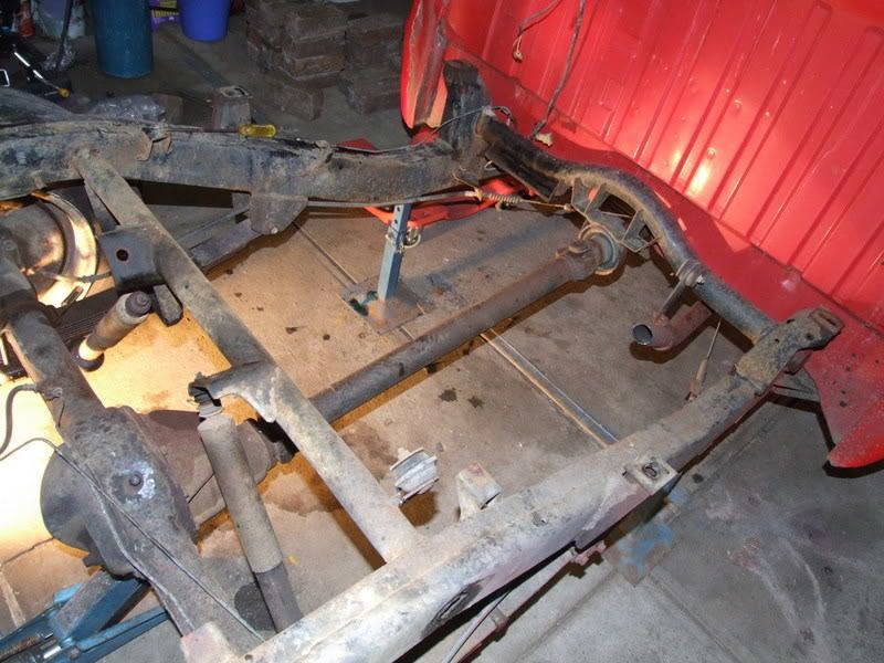

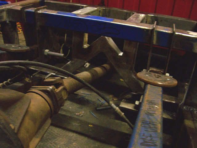

the link portion wtf is that, i have never seen it before. sory ifg its a dumb question
slammed84mazda's avatar
slammed84mazda
Do you mean at the rear of diff?
If so it's a watt's link. Due to the parrallel four bar setup this is used to keep diff central.

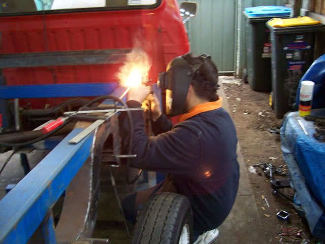

dude not tryn to be a smartdonkey.... but i would cover the back window while welding or cuttin with torch if you plan on keepin it.
but damn i will have to say alot of work you have invested in it. WORK=PAYOFF.
LOOKS GOOD
nytrdr24's avatar
nytrdr24
a little over kill on the metal size, but as far as form & function, well executed! you better put a little bigger motor in it than the 4 cyl
to pull that extra weight......

I bet you are having fun shaving that gas door, mine has been a bitch because its so close to the rounded portion of the body line. I would gusset some of the frame, considering you welded it on top of the original frame.

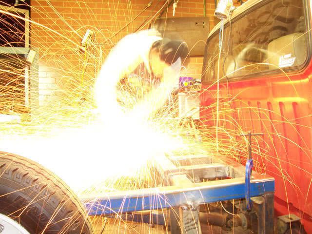

Not bad sparks for 60 kms!!!!
Wait till I get some real power in the engine bay!
Enjoy People.
