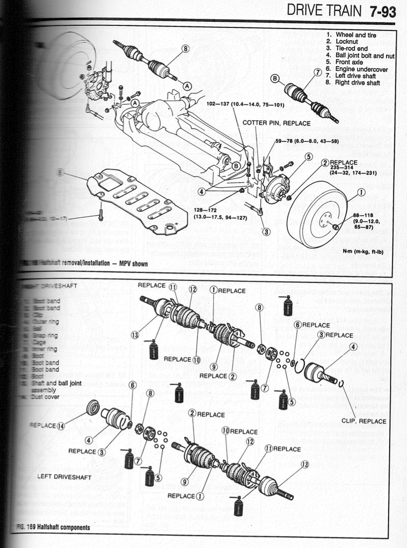

Many thanks. Will do. My biggest concern is a huge metal "Popping" sound when I turn the wheel hard over in the front-end . It is worse when in 4-wheel. I am thinking ball joints. Anyone have an ideas. Thanks,
N
norcallumps
CV shaft
9
91_2600i
Yep. Sounds like CV joints. You can buy new front half shafts on Amazon and eBay as well as plenty other suppliers like JC Whitney and the likes. I just searched on eBay and Amazon and you can get shafts from between $45 & $100 each. I would do the seals while I was in there.
Here are a couple of pics from my 91 Chilton's manual. I'd be surprised if there were any material differences between the 91 and 89 front drivelines.
