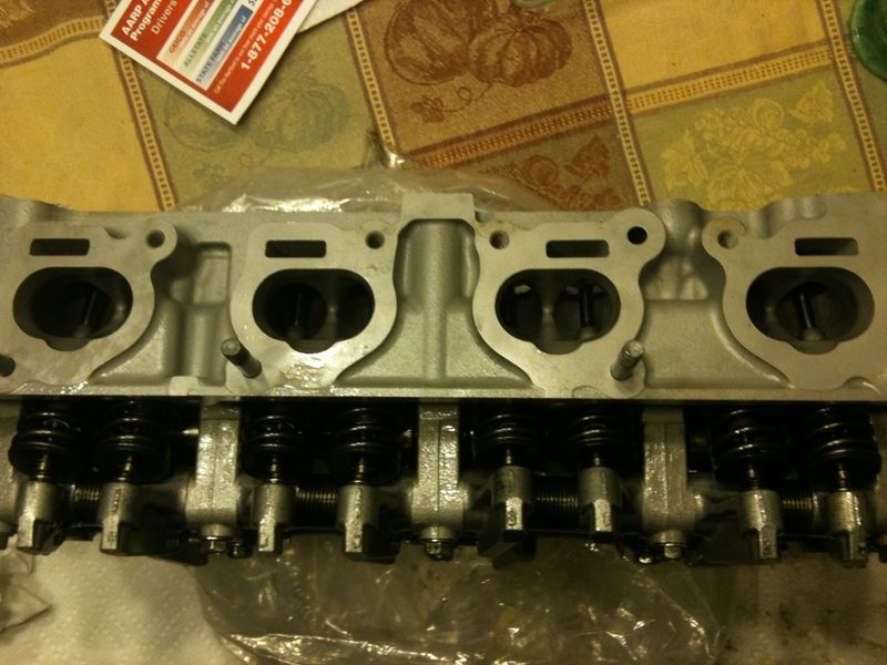

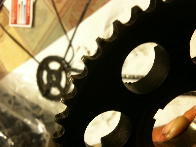

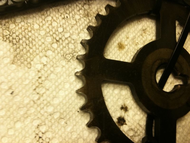

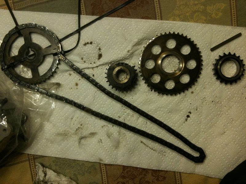

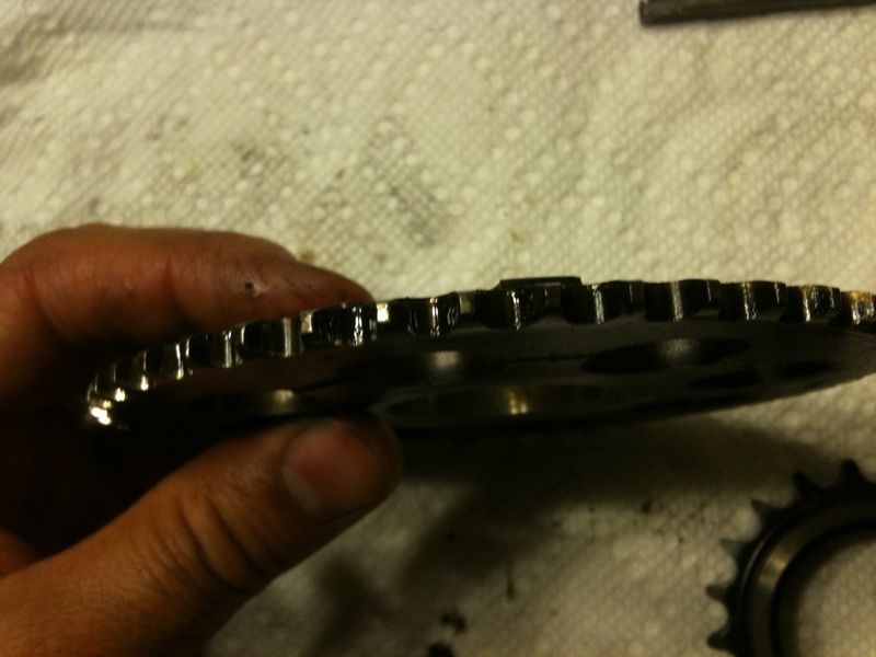

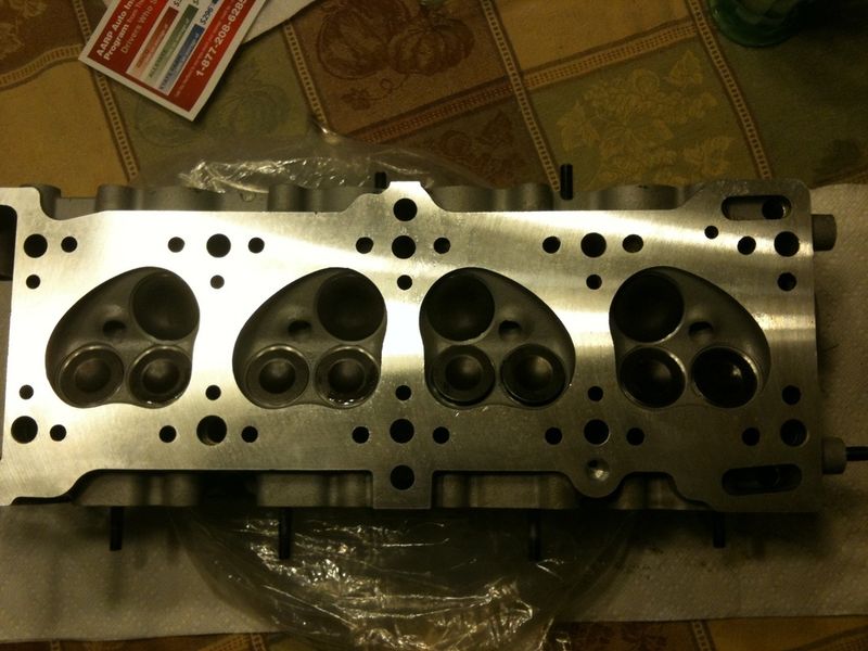

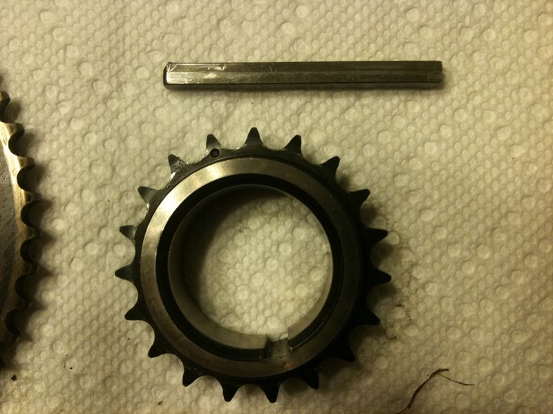

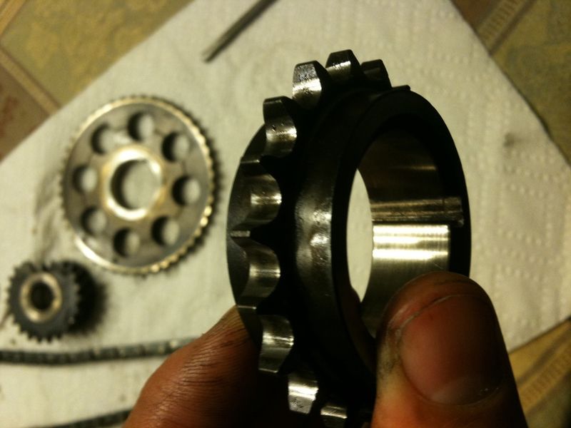

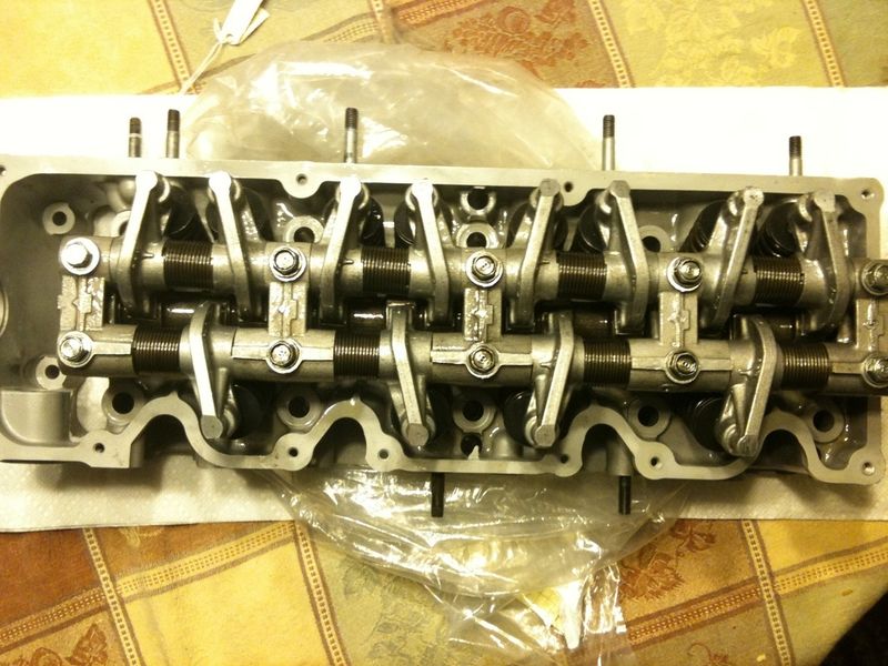

We finally have the Engine Pulled out! I'm attaching the pictures to this thread of the gears, chain, woodruff Key, broken gears, and the NEWLY REBUILT HEAD WE JUST HAD DONE. SEE BELOW
dadandsoneyes
dadandsoneyes
Please provide feedback and advice! We plan to replace the broken gear and Timing and Balance Chain, not sure if we also NEED or SHOULD replace the TIMING GEAR (LARGE ONE ON CAM) or not. Any advice from Experience folds on this 1989 B2600i Engine is greatly appreciated.
