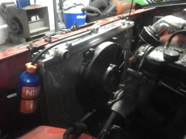

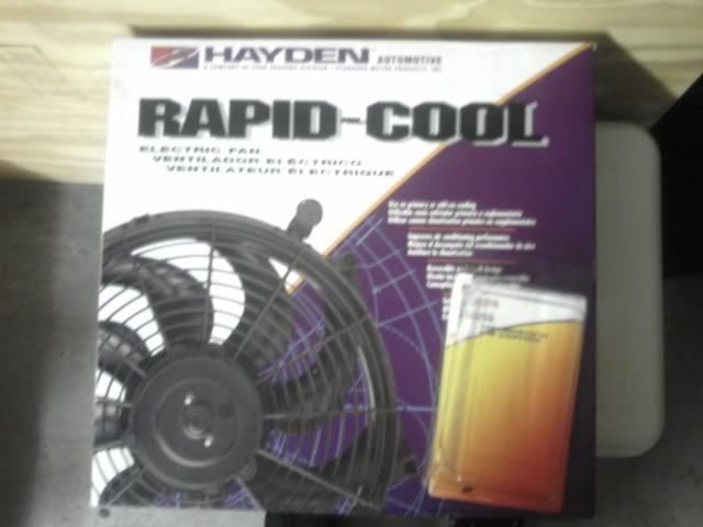

14in hayden electric fan
Koyo Radiator

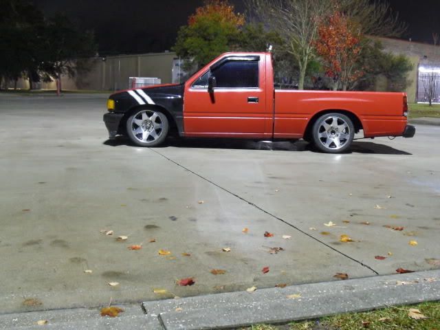

5/7 drop maybe more
isuzu amigo fenders
amigo/rodeo bumper and grill combo
custom widened stock valance

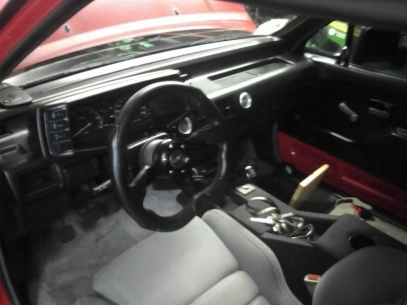

painted dash and door panels
v6 rodeo tach cluster

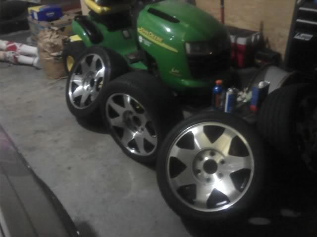

pioneer headunit with 4in 2ways in the dash
17in escalade rims with black "inserts"

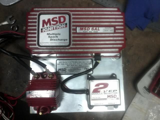

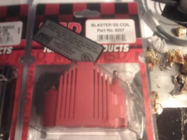

MSD 6AL box
MSD 2 step rev limiter
MSD Blaster SS coil
NGK Platinum Spark plugs and NGK wires
Accel 8mm coil wire

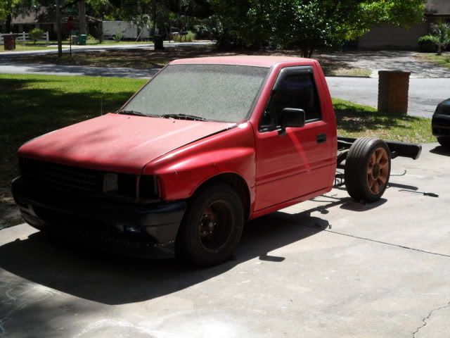

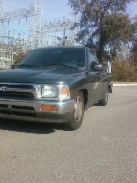

Stock when I got it about 2 or 3 years ago

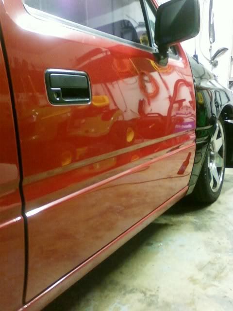

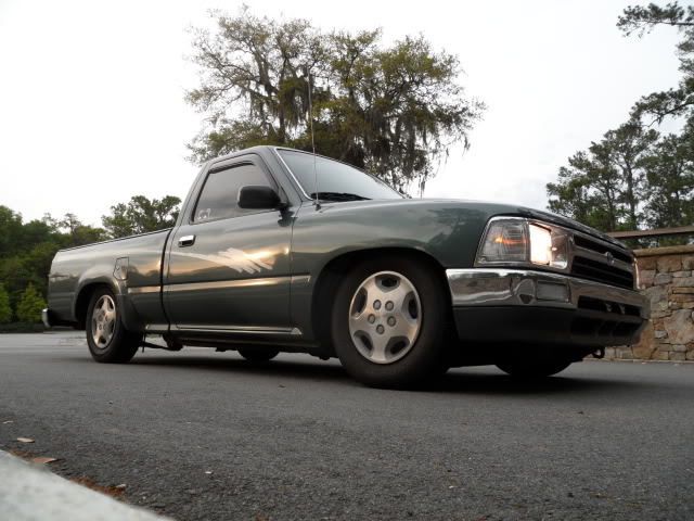

first drop

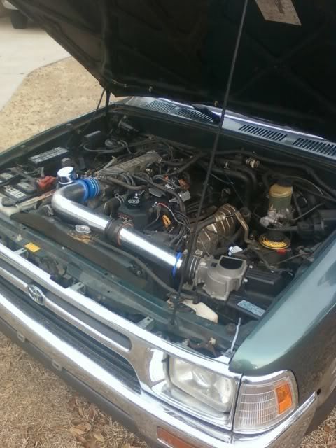

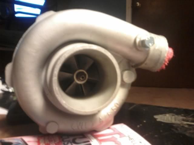

Ill give you guys a little hint on motor work
lethalethan

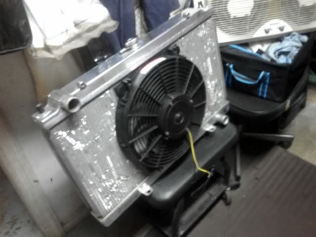

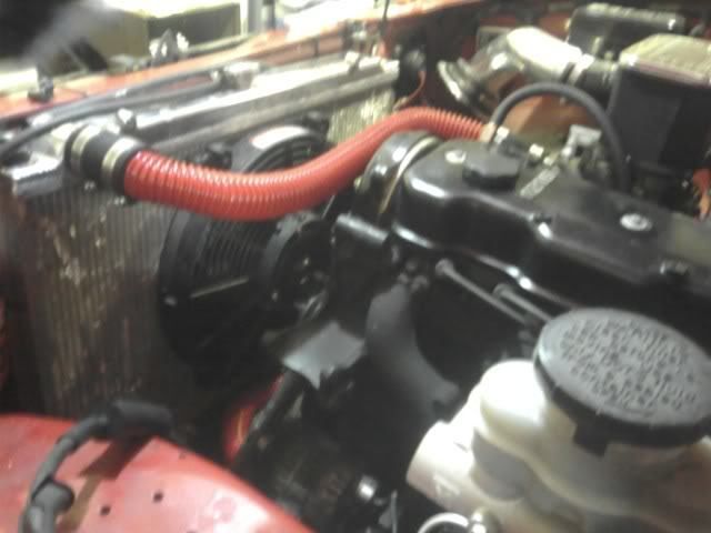

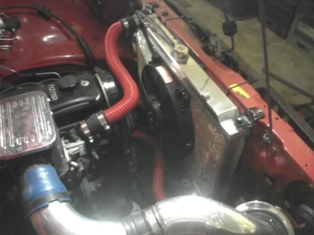

koyo rad with 14in hayden fan
youd be suprised at how many people ask me if im really running nitrous on my motor

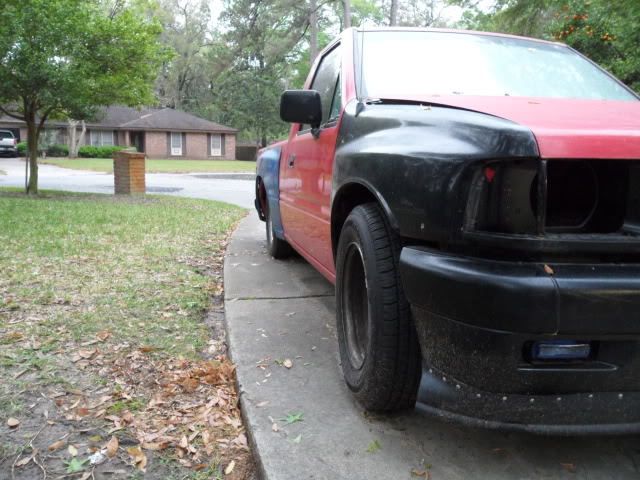

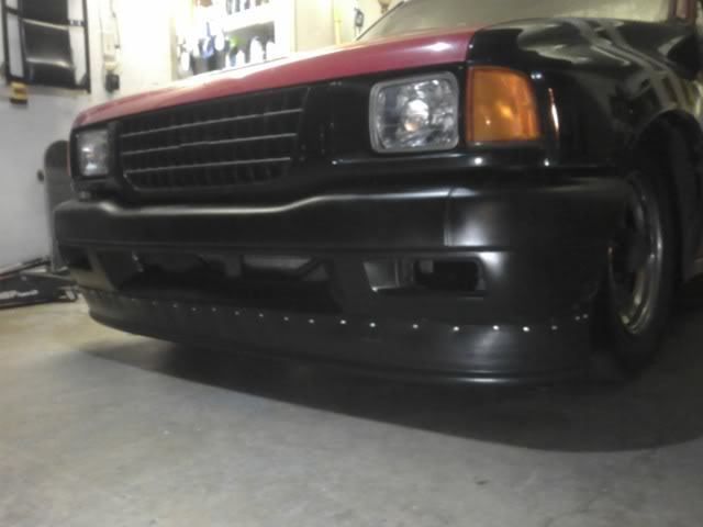

home depot lip
i used aluminum rivets to hold it on because I plan on it dragging a lot. The rivets will just pull out instead of cracking my bumper

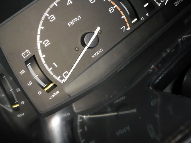

polished gauge cluster hood when I actually used it.

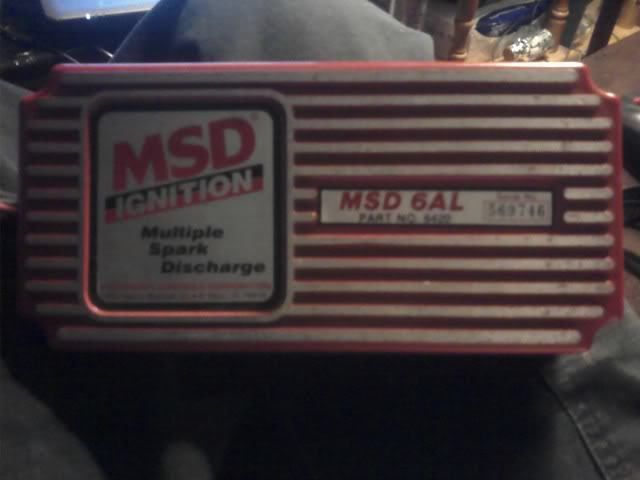

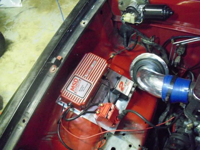

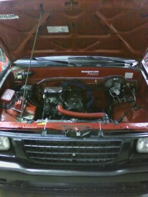

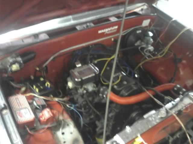

Ignition time

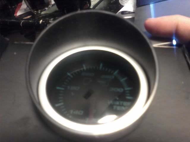

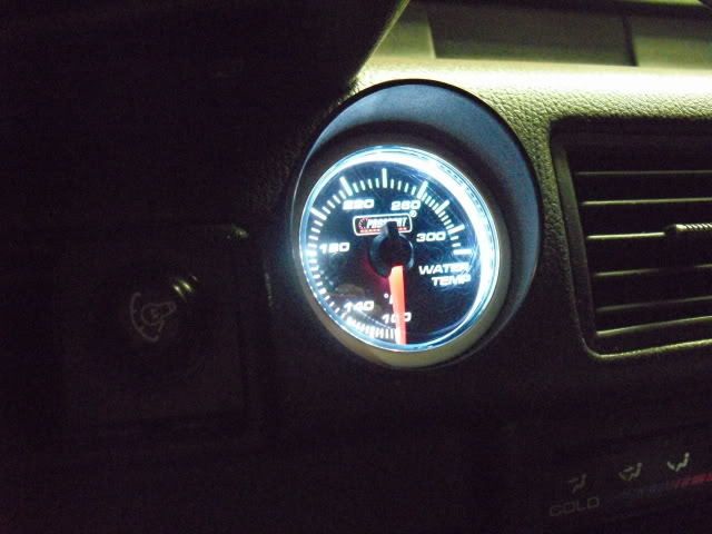

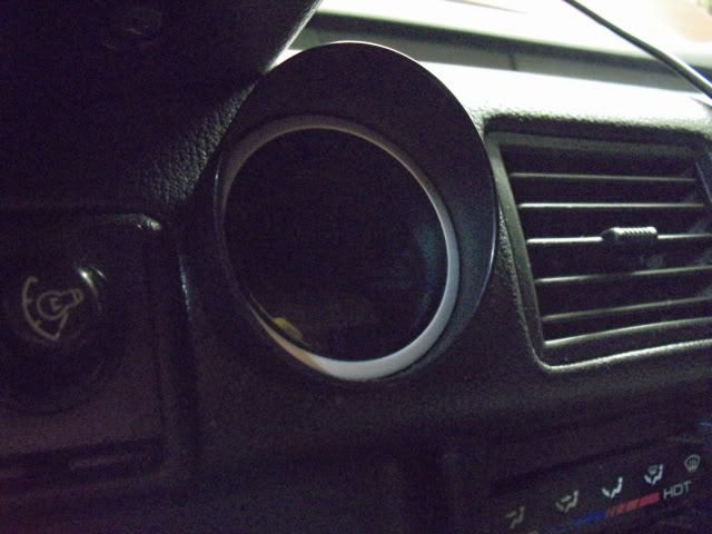

Prosport water temp gauge

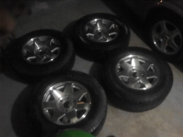

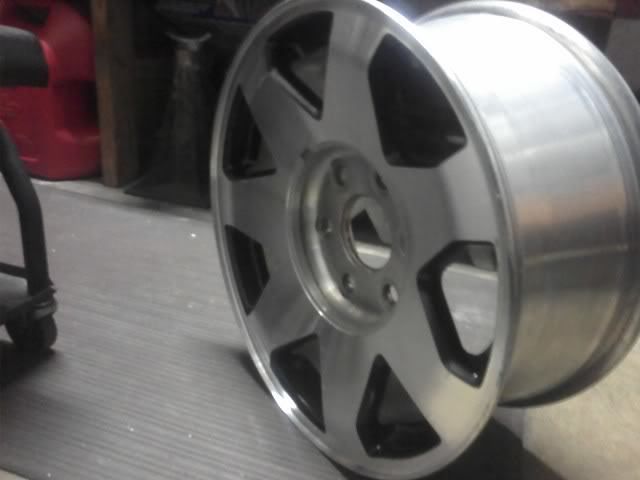

painted the inserts black
free tires ftw!

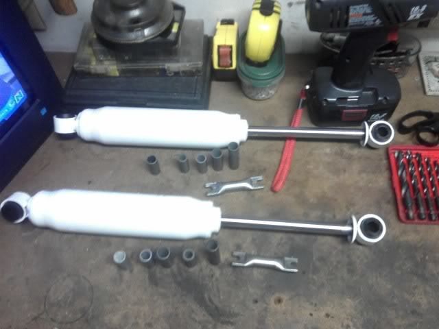

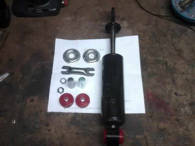

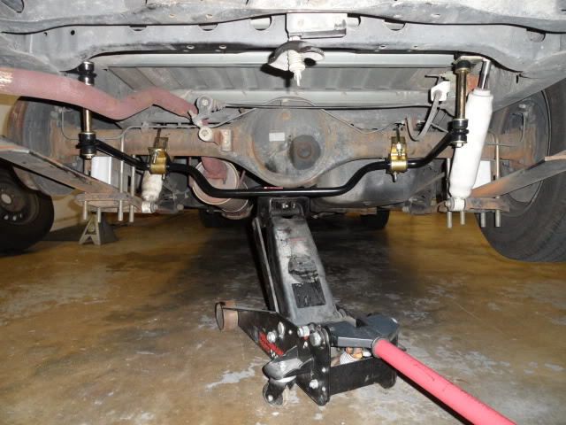

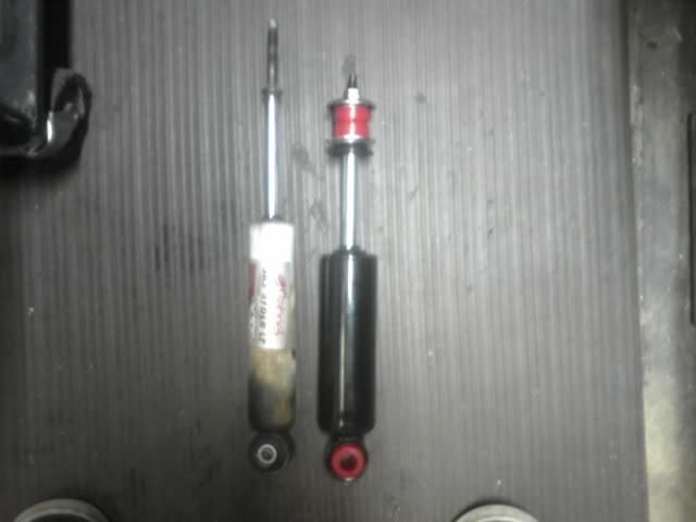

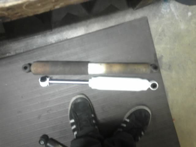

Summit sport truck shocks for the front, the bottom bushings had to be trimmed down to it the lower shock mounts. Toxic shocks for the back fit great, build quality seemed low compared to the summit sport truck shocks
old vs new
The summit sport truck shocks ended up being a doetsch tech nitro drop shock with a generic part number. The quality of these is great, they look very well built, but the bottom bushing was far to big to fit into my shock mount. They required a bit of modification but other than that they went right in. The Pro Comp toxic shocks seem to be lacking in build quality, overall they just dont look as nice as the summit shocks. However, they seem to be pretty stiff and almost stopped my truck from bottoming out on the frame completely.

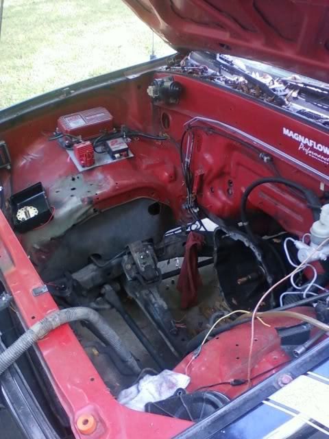

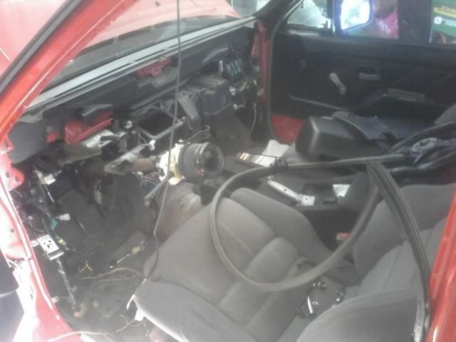

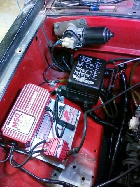

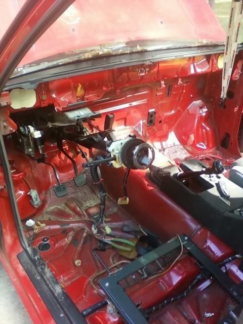

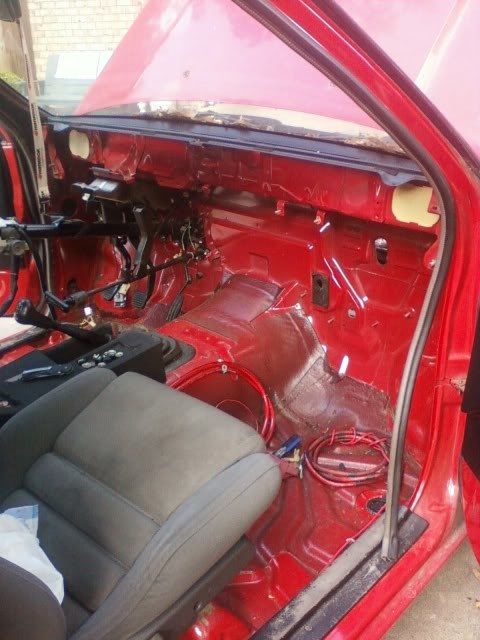

then i started tearing shit apart to re-wire

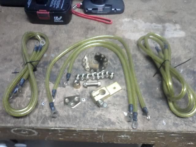

Option racing circle earth kit
Relocated fuse box

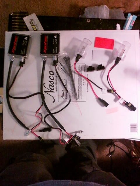

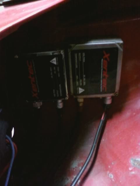

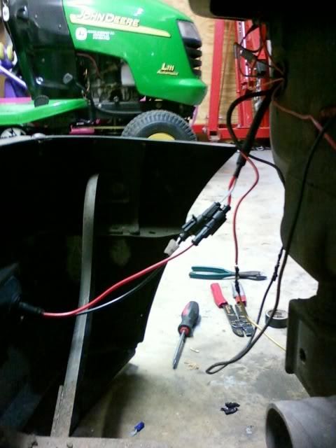

3k hid kit for my fogs
Headlight and fog ballasts

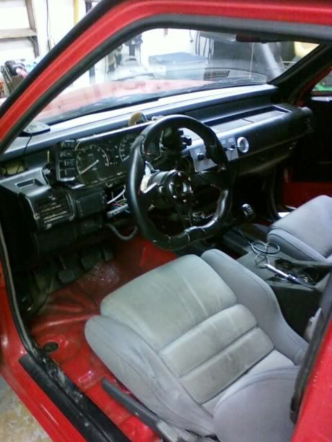

new driver seat

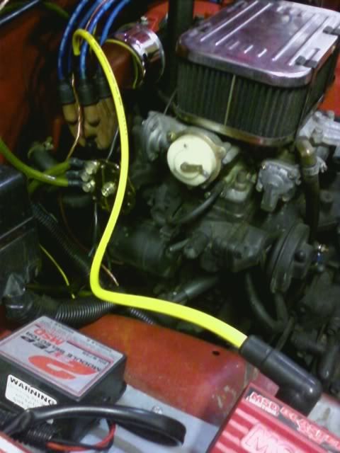

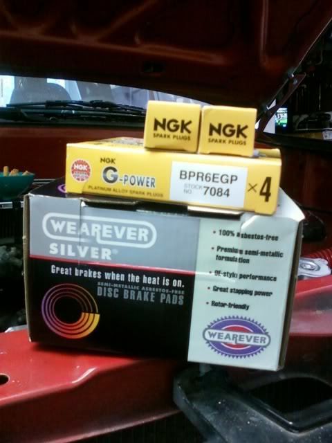

new NGK platinum plugs. The number 4 spark plug insulator came apart again. New brake pads, I also got an accel 8mm coil wire after being zapped by my msd box 3 times. The old coil wire had some little cracks in it i guess.

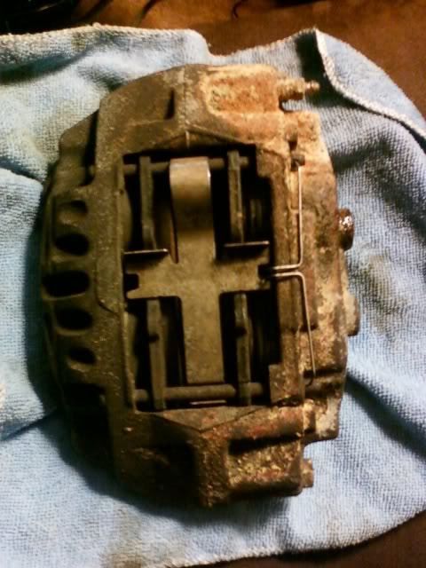

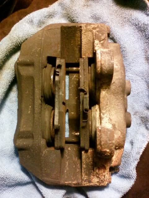

what am i doing now? Idk yet but I picked up these the other day
Thats right, 4 piston front calipers. Stay tuned
