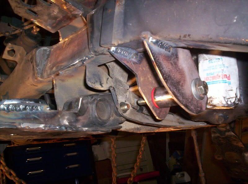

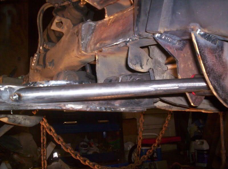

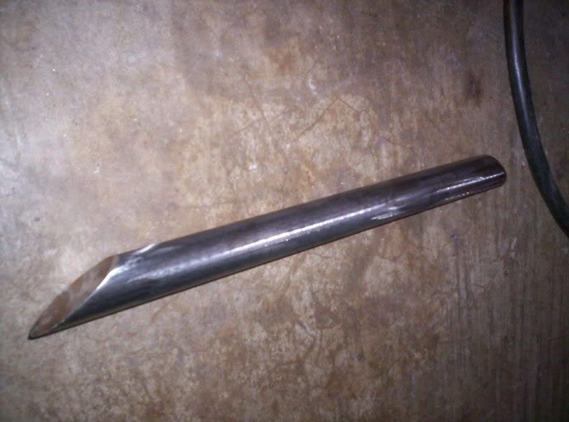

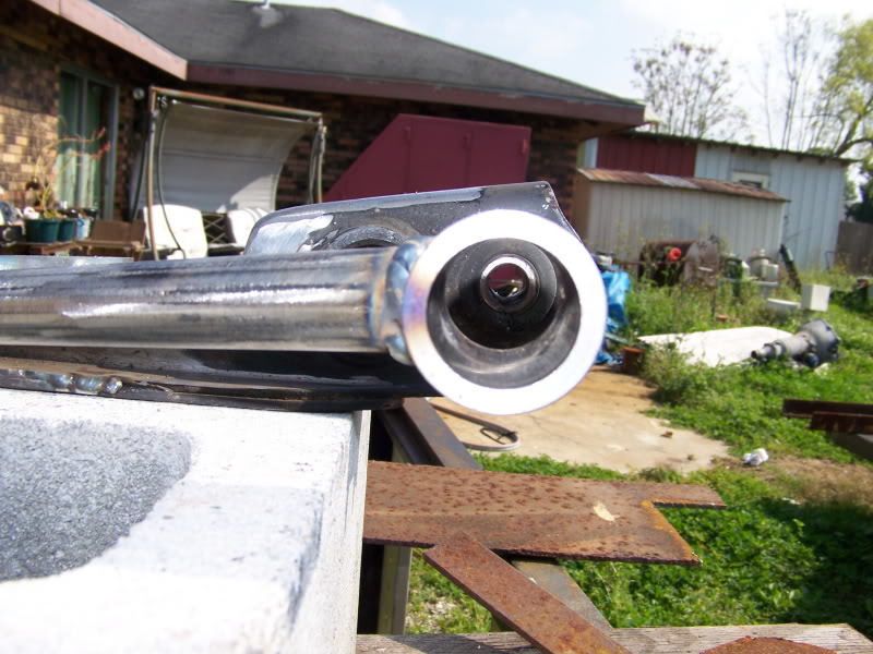

heres mine, i hacked up an old torsion bar to use for it...

thanks a lot for the pix. what did you use for bushings for the parts you built? have you had any problems with the lower homebuilt a arm moving forward amd back?? the roads are really crappy around here so i am kind of worried about hitting potholes and such.

no problems at all. i just used some universal urethane rod end bushings inside a piece of dom tubing. you think the roads are bad there you should come to south louisiana, lol.
