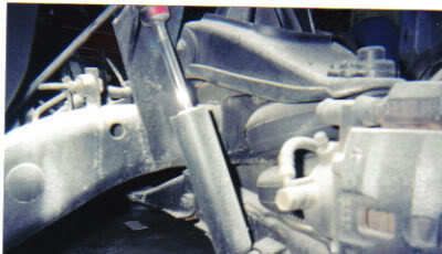

how do you run shocks on the front of a 92 isuzu pickup with bags it is tight in there no room

This is my front shock set up.

My setup on my Isuzu is very similar. You can get away from a shock if you dont plan on driving the truck alot. No shock on the front you can have alot of wave in the ride.

Sorry the truck was apart in this pic,its a little dirty! And thats before i moved the ugly brake lines.

make your own mounts for the shocks...

Thats what i did!

Of course you have to make your own mount. If the airbag is sitting where the shock use to be (on a 92 model.)

what shocks are you running?

I have belltech nitros up front and just reguler ones out back. The truck rides like a cadi.

Did the same But opposite Nitro's in the back Stock ones in the front Same result Smooth RidE!!!!!!!!!!!
