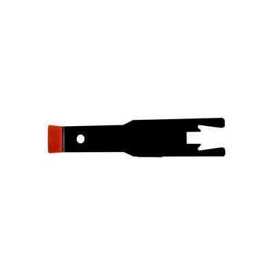

um no. use this on the window cranks

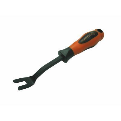

and this on the door panel

where can i pick up those tools?
bjscustombillet
just use a shop rag. Slide it between the handle and the door panel rotate the rag nice and easy, and walla! the little clip comes right out and the window crank slides right off. Thats how i do it ,might be the right way but it works for me.

any autoparts store or tool vendor should have these or some similar. i just personally use all matco.
