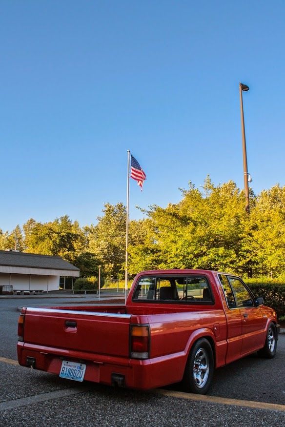

Some specs:
Rear - 5in rear drop blocks, removed overload leaf, air shocks
Front - Removed bump stops, torsion bars cranked fully down
missed.a.leter's avatar
missed.a.leter
Love the B man! How does it ride with the rear air shock? I just started hearing about them. Also with the bumpstops removed does it bottom out hard? Have you bottomed it out?
kmo_
The air shocks are definitely worth the money. I have a canopy that i run from time to time and all i do is throw some air in them and it rides like its not even lowered. The front end does bottom out a lot without bump stops. But its not to bad as long as you don't bottom out hard. But then again i do have the torsion bars cranked as far as i can get them and have them still be safe to drive on.
