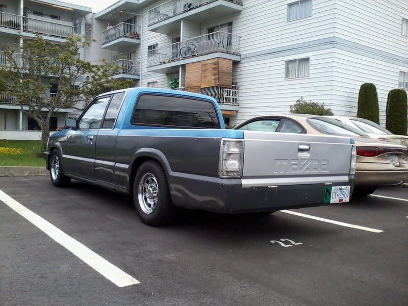

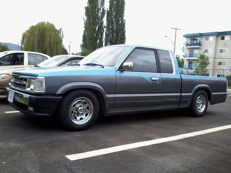

New chrome front bumper, chrome door handles and a fixable stamped tailgate.
immortal1 (linn)'s avatar
immortal1 (linn)
Looking good! You say "fixable" tailgate? Looks pretty good in the pic.
addiktion's avatar
addiktion
lol theres a pretty decent sized dent on the right side just between the body lines

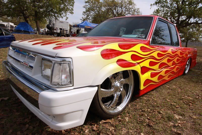

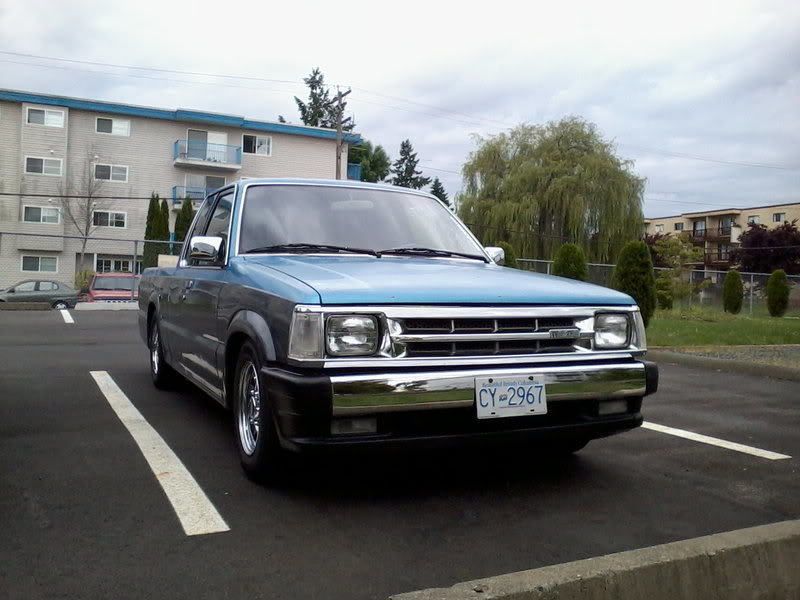

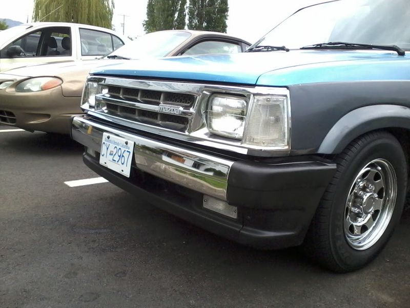

so i was bitchin last week about my bumper sagging on the ends, well with this new chrome bumper its still sagging and there is really not a lot of play with the end caps. so does anybody have any idea what could be the problem? its tight to the grill in the middle and then fans out on both sides. i dont know if its the grill, or the bumper brackets, or the horns that hold up the end caps or if my truck is just fucked. everytime i see a b with a tight bumper i get pissed off lol.
addiktion's avatar
addiktion
this being a perfect example...
Mine:
What it should be:
killerb's avatar
killerb
Your saying the back edge where it flows into the arch of the fender sags? If that's what your getting at mine used to do that too. I kinda figured out how much they needed to come up an took the bracket out that's on the inside of the end caps. I then ovaled out the holes that the screws go through an used that for adjustment on the caps. Hope that helps.
90-b22dawg [andrew]'s avatar
90-b22dawg [andrew]
im willing to bet that the bumper on the red and white ex cab is bolted to the fenders somehow.
It's the bumper brackets but killer B has a good suggestion on how to fix it with out replacing the brackets.
