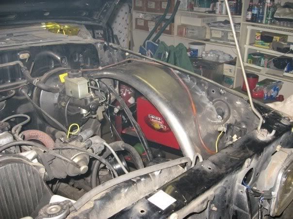

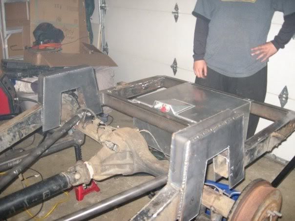

Well she has been taking her sweet time posting pics, so i will do it. I built the truck, so i figure its my right and it DID used to be my truck.

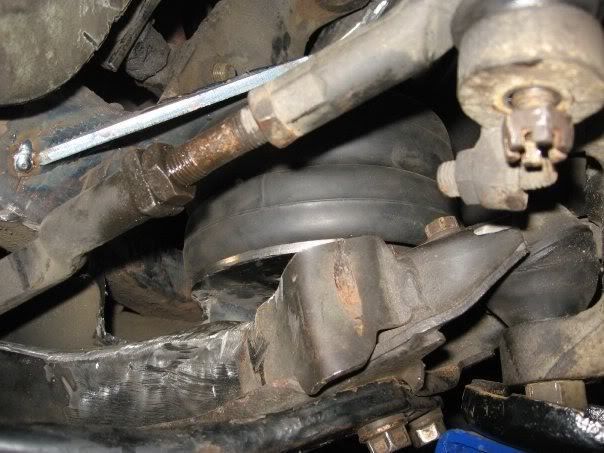

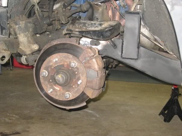

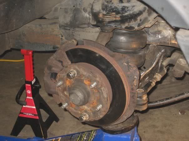

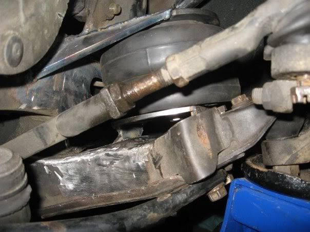

Front Setup
Slam 6's
Hydraulic Line
Factory Mazda Shocks relocated
Pics
Compressed bag
Non compressed bag
Shock mount
thought i had a decent pic with the shock in, but i dont

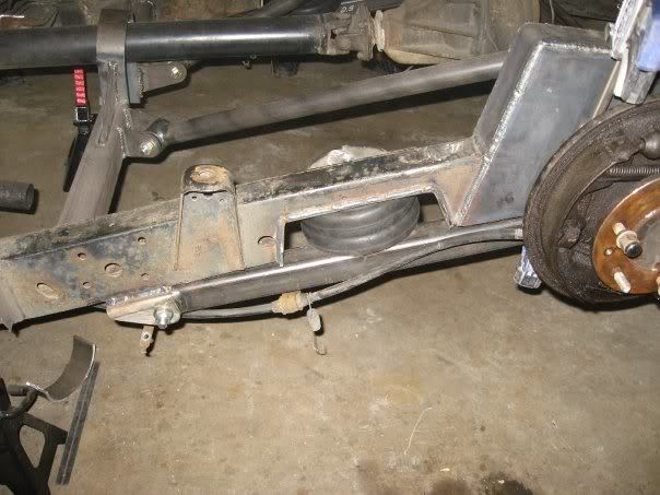

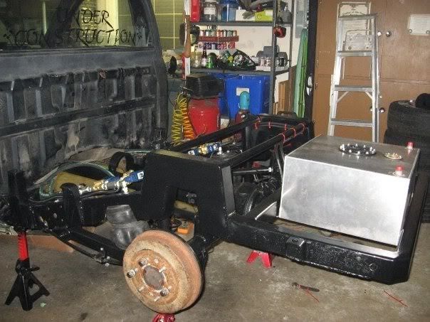

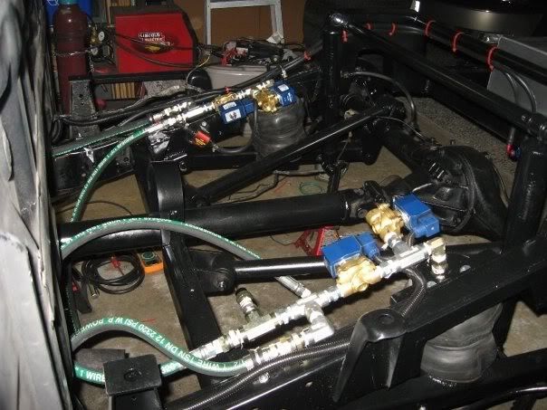

Rear Setup
Slam 7's
Hydraulic Line
1/2" GC extreme valves

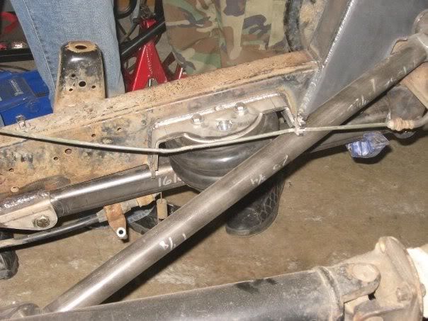

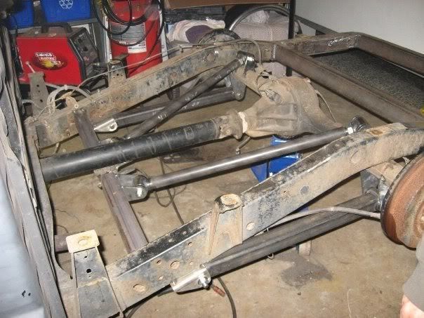

Super lift triangulated 4-link. bag on bars with custom upper bag mounts
Factory mazda shocks relocated

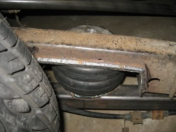

Pics
Tacked in for mock-up
Rear bag mount (we plated the hell outta the frame after to prevent bending)

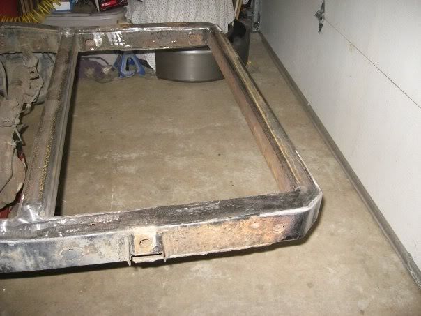

Rear Frame Section
Excuse the air lines running everywhere in this pic, they were not hooked up yet

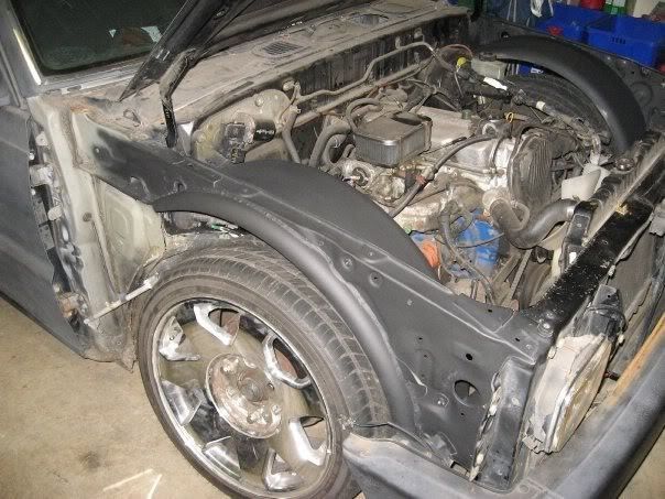

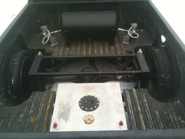

Fuel Cell Mounted
Front Tubs

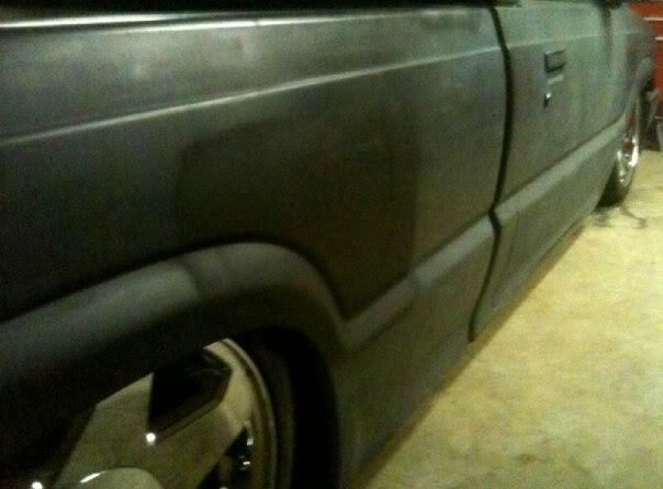

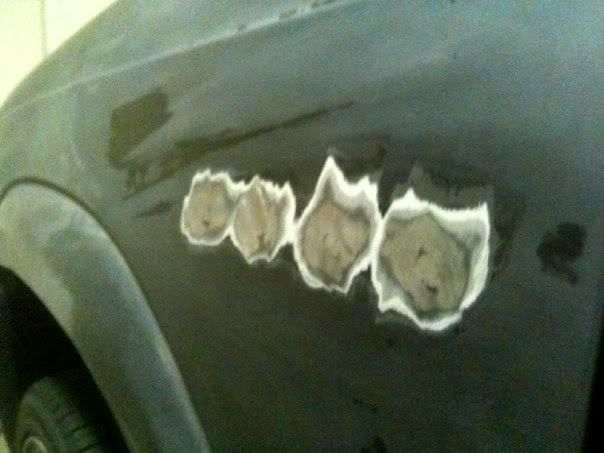

Shaved Fuel door and front fenders (pre bodywork)

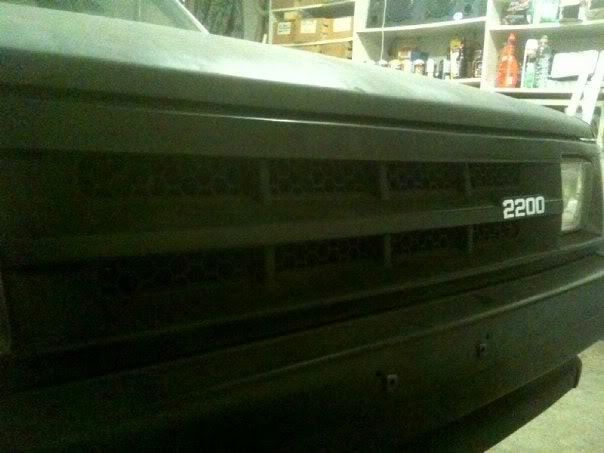

and a custom grill emblem for fun
Let me know what you guys think.ill try and track down some pics of it layed out. when i find em ill post em up in here.

skrapinsask's avatar
skrapinsask
I really like what you have done with the custom rear upper bag brackets and how the lift arms are parallel with the frame!
mazdaman82's avatar
mazdaman82
sweet,sweet, love......get some pics of the rear bag when its done.... I love the in the frame setup
8
88mazdamini
very nice, like the upper bag bracket as well.

dropped90(justin)'s avatar
dropped90(justin)
so what kind of lift you gettin with that rear setup? i like that alot.
-justin
pjsbird's avatar
pjsbird
The lift is limited by the rear shocks but it gets just over a popcan if lift front and rear. It sits dead level when lifted.
I'll get her to bring it by so I can snap some good pics one of these nice days.
