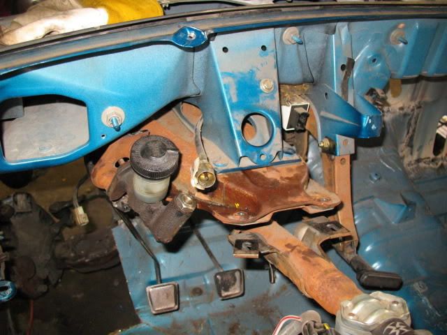

I know there is a couple of people wit there master cylinder mounted on the cab floor cause I've seen them on some threads but I can't seem to find them, can someone help a brother out

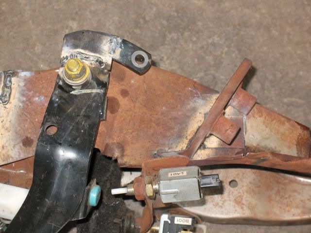

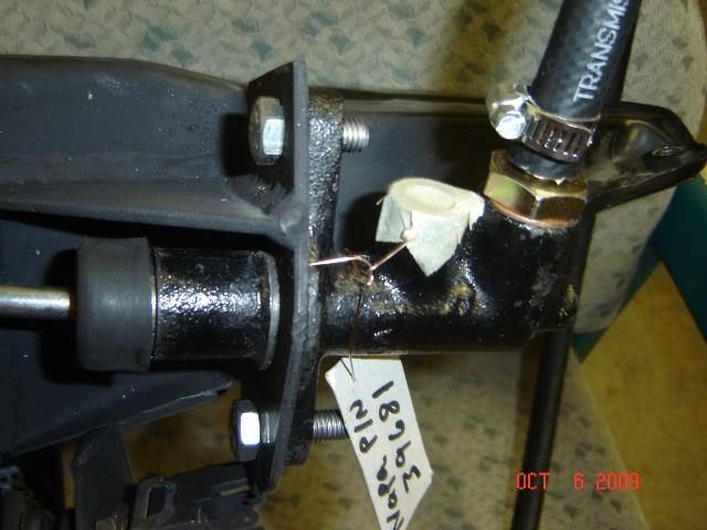

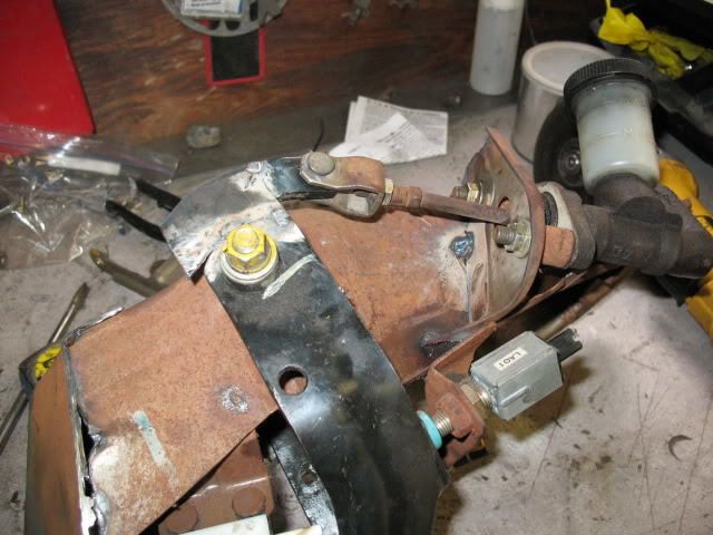

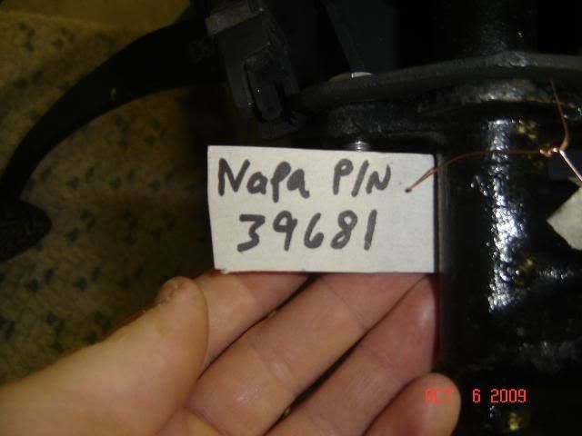

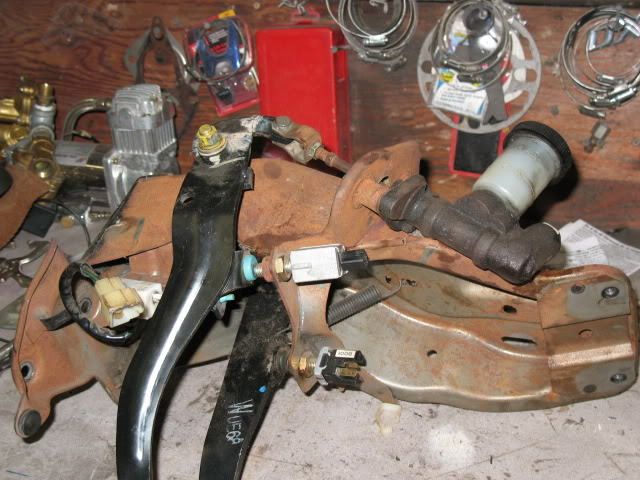

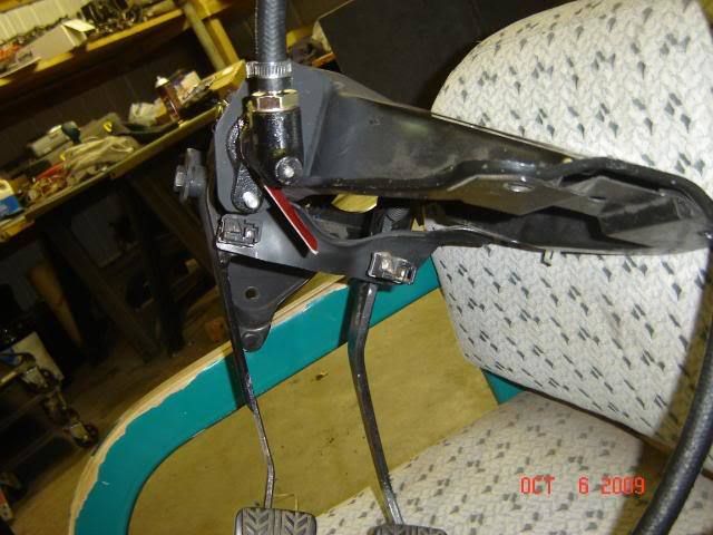

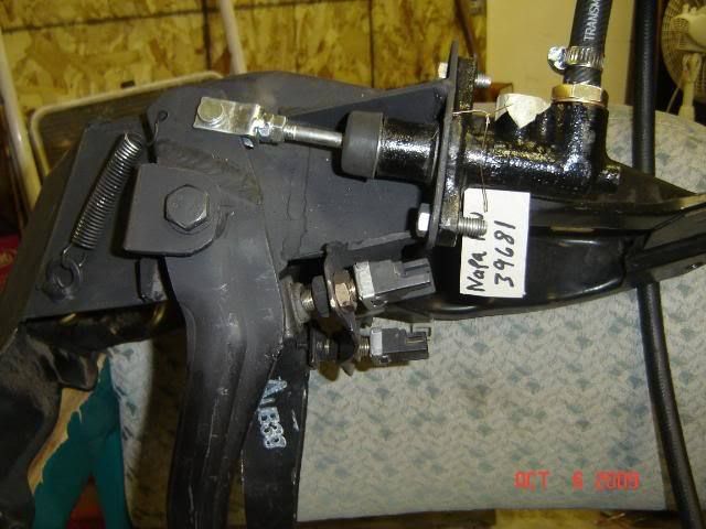

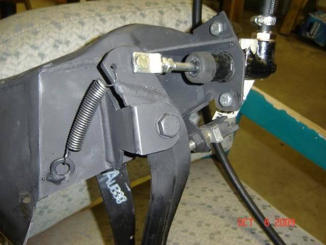

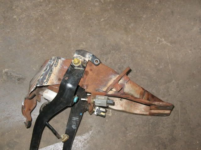

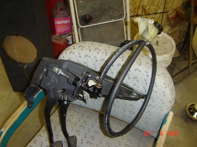

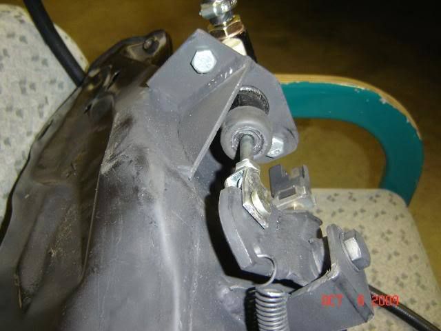

My buddy just fabbed up a master cylinder set up that mounts right up on the side of your pedal bracket. The master is new from NAPA and is off of a early 80's Toyota Corolla, has the same bore and fittings as the stock mazda so the line bolts right up. He then attatched a line to the resivore input and out to a S-10 resivore. Once you see the pics it will totally make sense. I just got it back yesterday but am working a couple graveyard shifts so I won't get any pics up until tuesday evening. It is WAY simple and WAY easy to do.
It cost less then $70 in parts and a couple hours of time to fab it up.

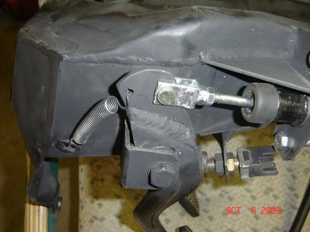

tuckin20s
Well here you all go........... I hope the pictures are clear enough.
thats cool as hell tavis
paparoach1983's avatar
paparoach1983
SWEET looking good bro
paparoach1983
Wait is that the brake or clutch lol. i cant tell. i wanna see a brake mounted on the floor. hmmmmm
