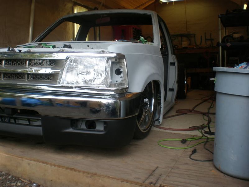

she will be painted soon...
pics will come when it done
paparoach1983's avatar
paparoach1983
good start man. cant wait to see.

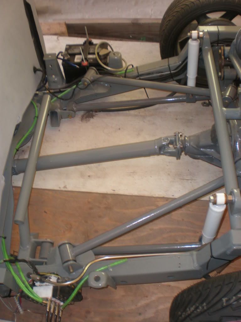

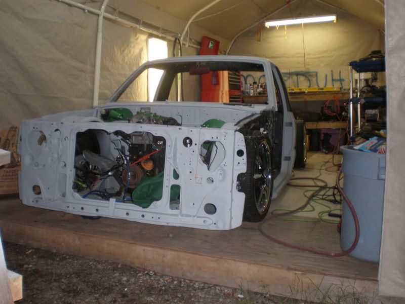

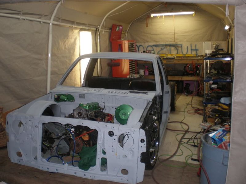

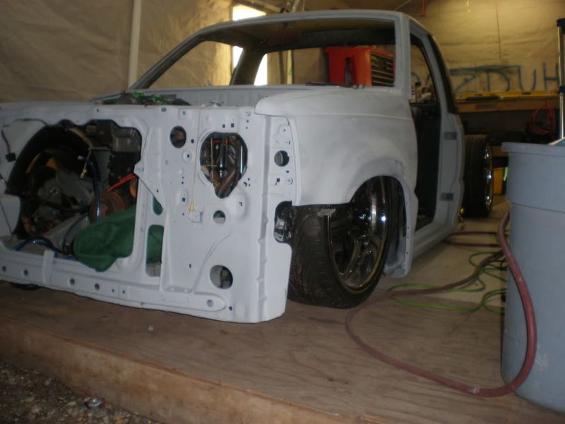

word man i hear ya. that thing is bitchin. from what i see its of course standard cab, bd'ed, suicide doors, maybe 5lug swap with some 18-20s, and the rear looks like its cambered in, is that independent rear or is it just my eyes?
blackhulk's avatar
blackhulk

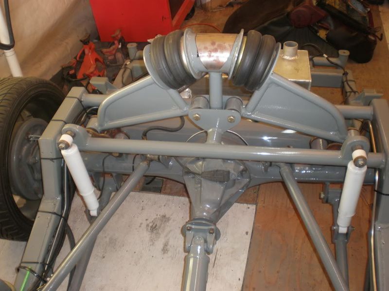

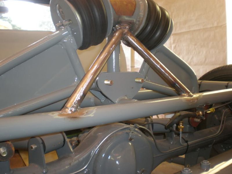

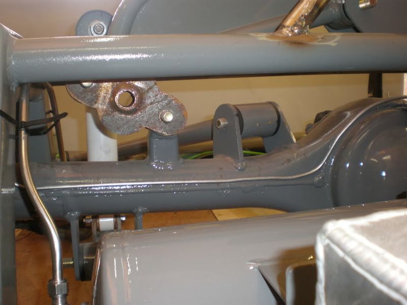

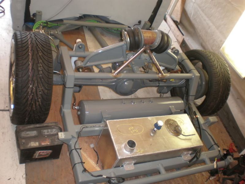

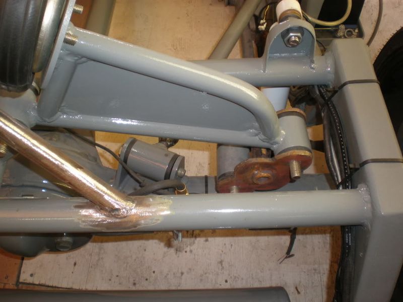

this is my rear set up..i had to re weld some proper gussets to strengthen the single post that holds the bags up
2.5 bd on 18's and 5 lug too

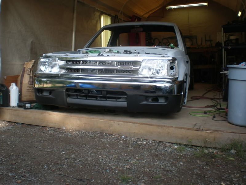

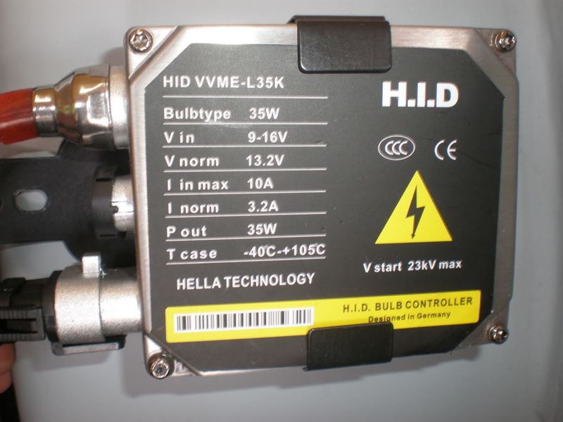

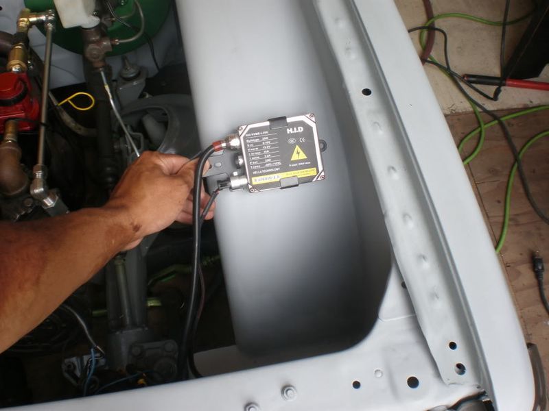

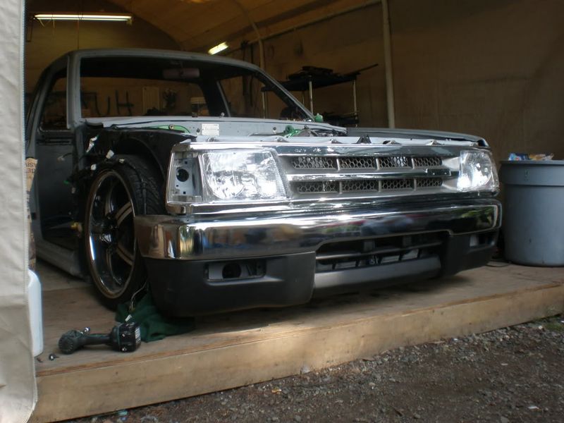

up front is 04 rangers with 8000k hid wrapped around a chrome b2200 grill and to set it off i added a 97 Tacoma 4wd chrome bumper and black lower valance..its to die for
