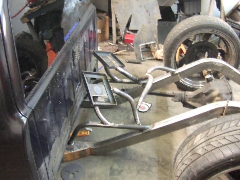

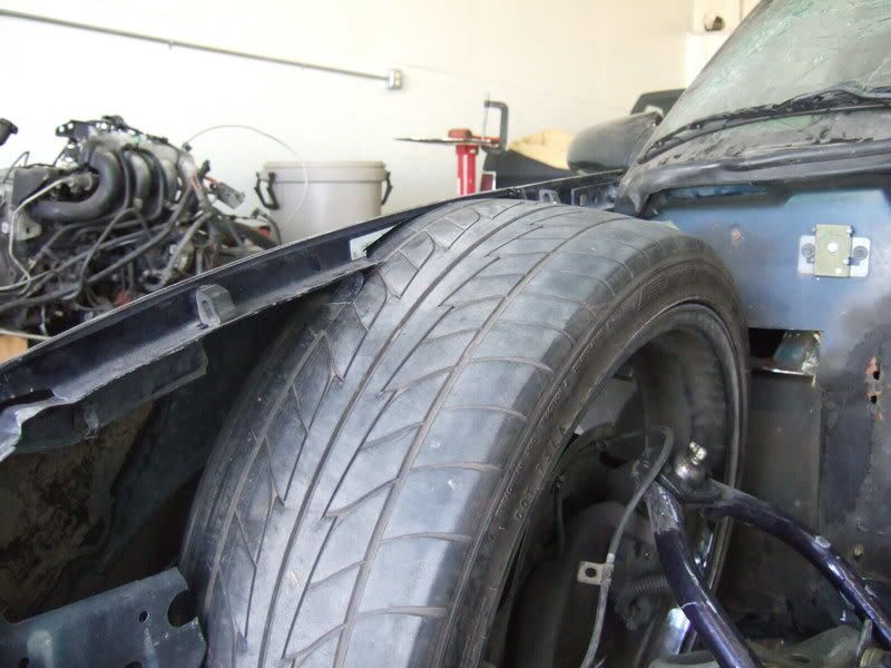

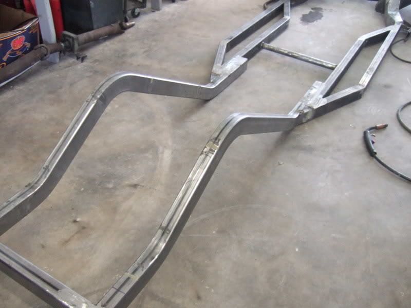

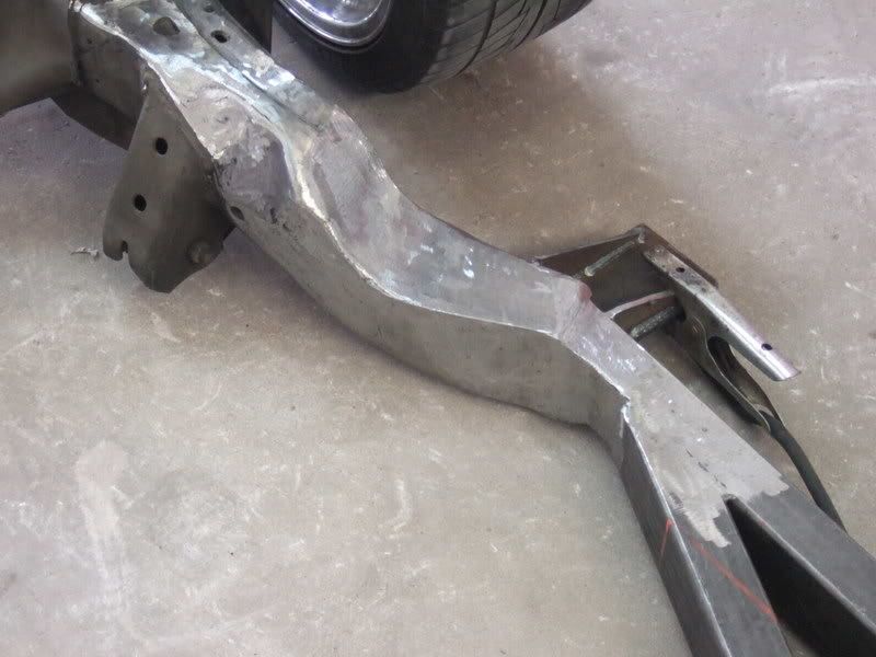

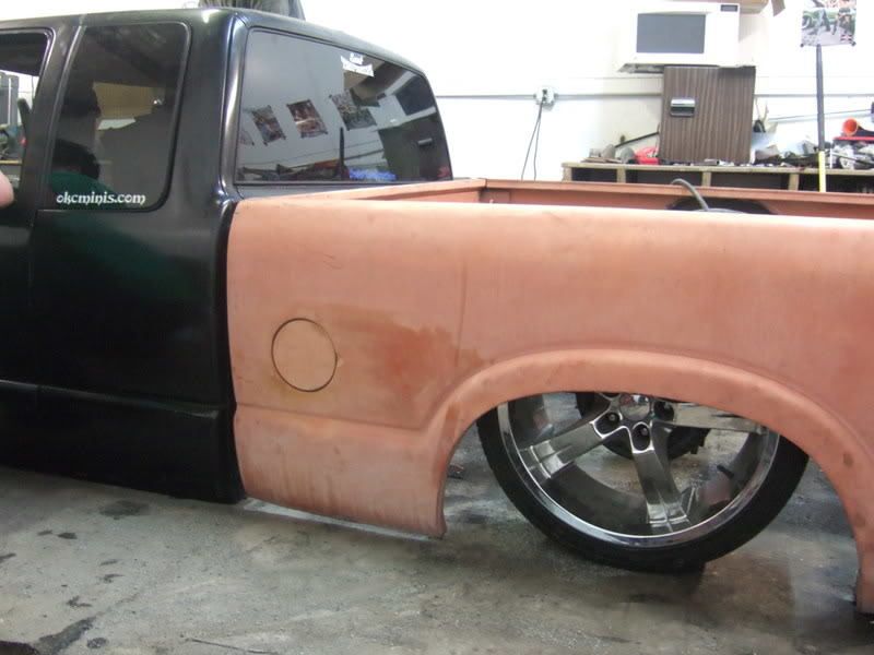

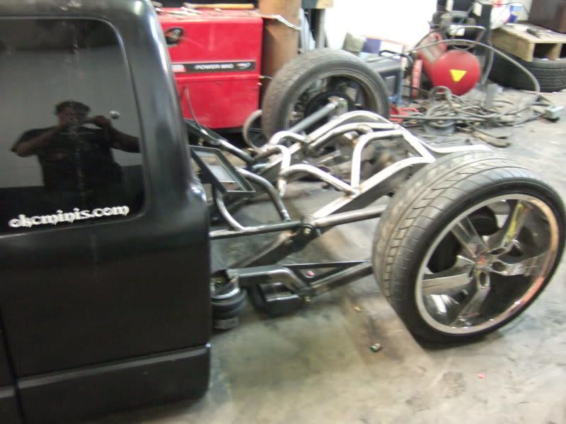

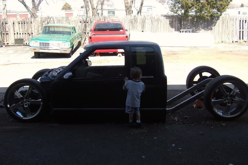

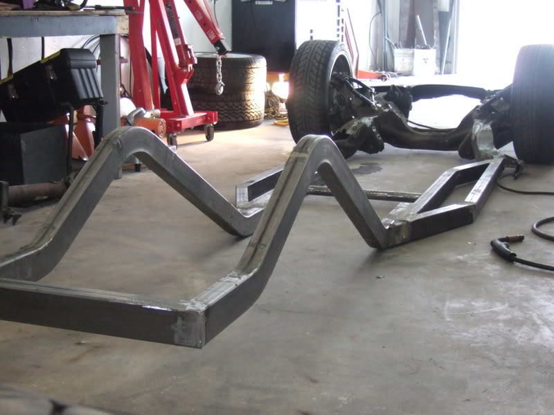

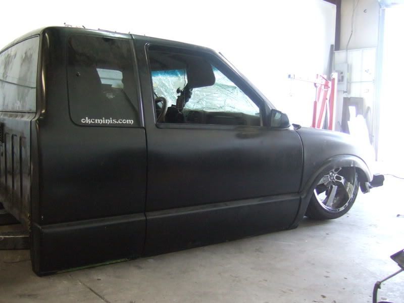

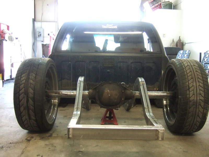

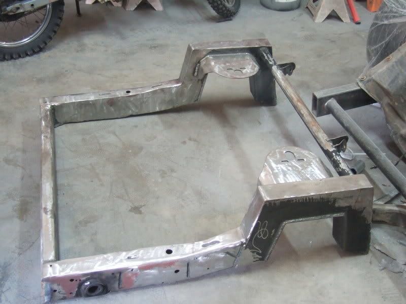

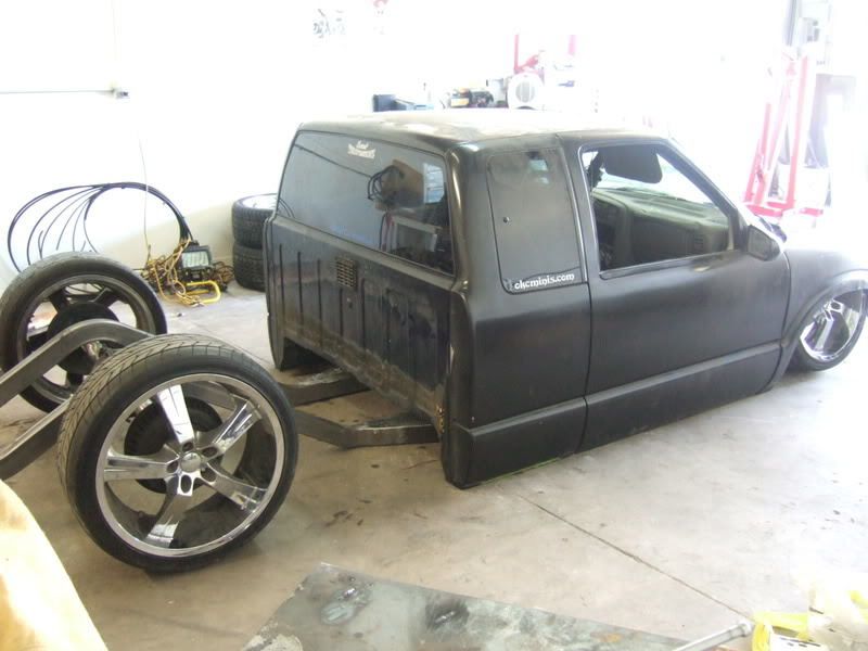

this is my buddy from tulsas s10, it was originally traditionally body dropped but was in rough shape. he wanted to to do just a backhalf at first then we decided on a tube backhalf then it was mandrel bent backhalf and then a stockfloor 3/4 frame to the doors.
first i cut the stock frame off.

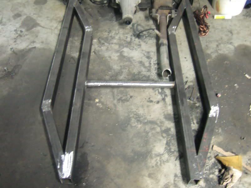

start of the tube backhalf
3/4 frame
mandrel bent rails

luckily hes doing a new front clip
my son

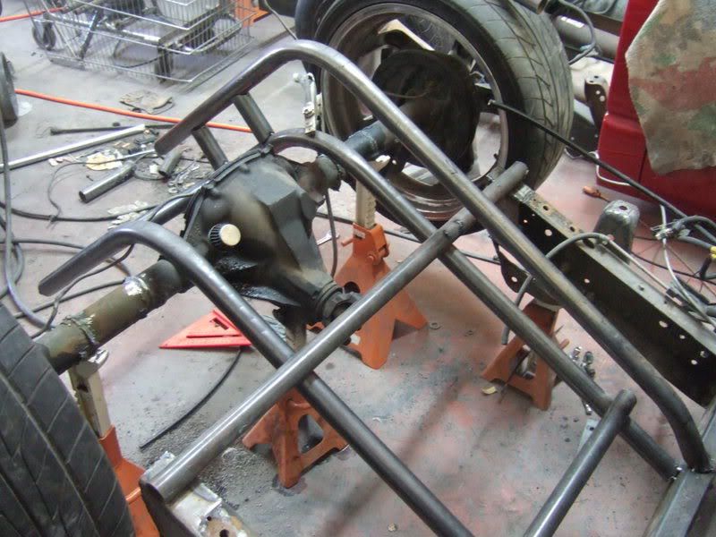

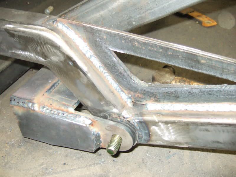

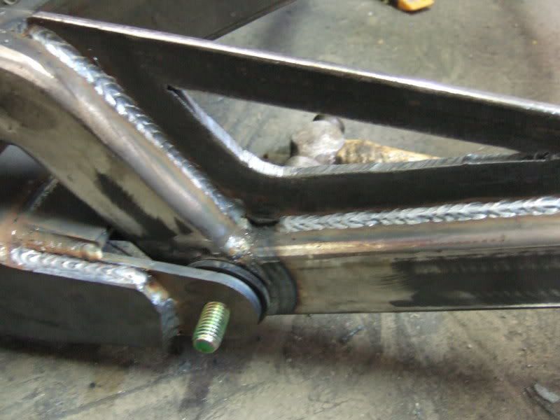

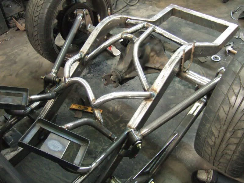

and finally some tube work!

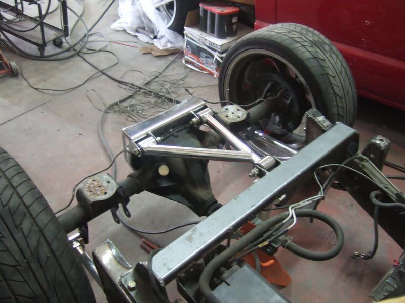

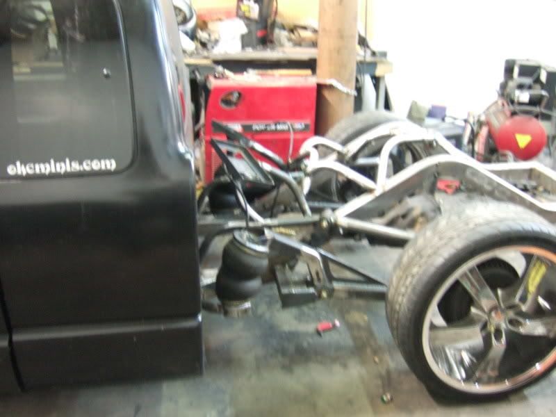

cantilever tri-4link. going to put better bags on there to get more lift, those are just the shop bags.
im not done yet still have to do the tube work in the back that holds the fuel cell, tank and compressors. then the sheetmetal work start haha.

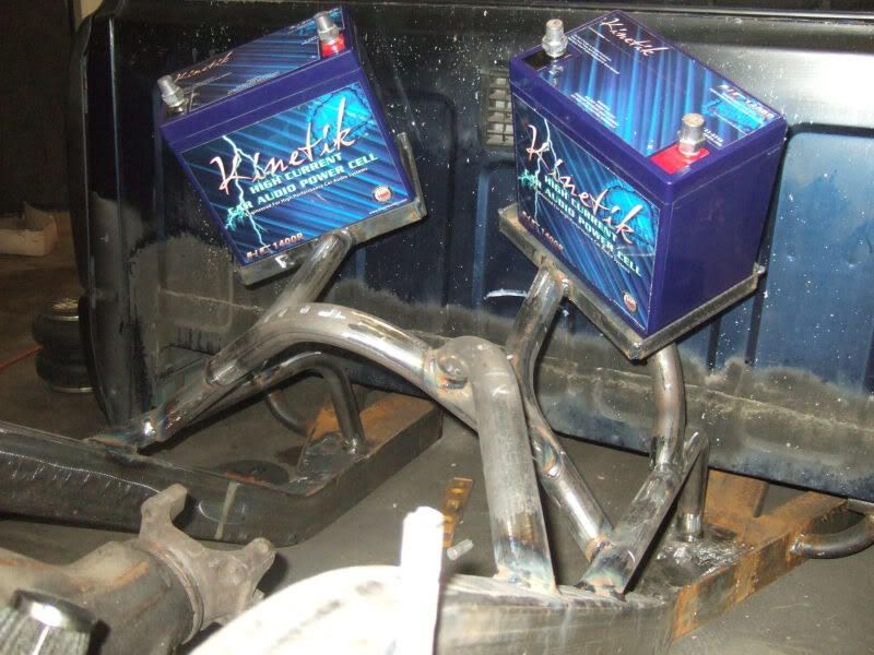

those are some CLEAN welds! TIG or wire feed? I thinking thats TIG work...pretty smooth looking! Its coming along nicely....clean build man
and I hear good things about them kinetic batts...are they pretty good you think?
mazdalowrider
that is not tig

yea...guess I coulda looked at the welder sitting right next to it huh? LOL.....hey man...gimme a break...Im blonde!! LOL
mazdalowrider
no i just looked at the weld craters in it are elongated from two much wire feed or moving a little to fast

the kinetics are supposed to be really good. he got a hellofa deal on those too. and yes i was going a little fast on those welds.

mazdalowrider
did u run just one pass on the welds? if so i would run two to three more, like ur hot and cap
