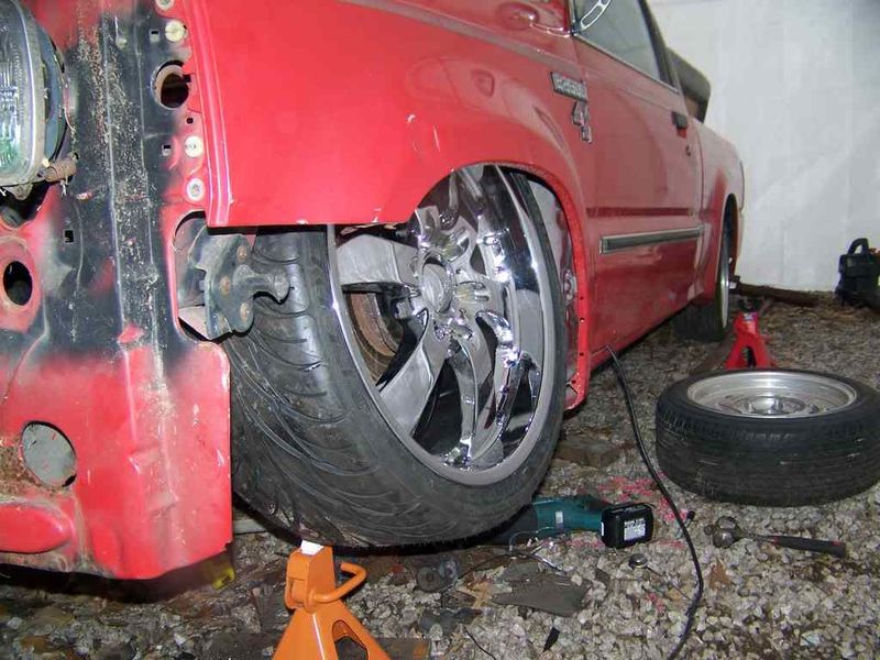

Not finished yet but here is one pic. They are Eagle Alloy series 026 20x8.5 with +40mm offset.

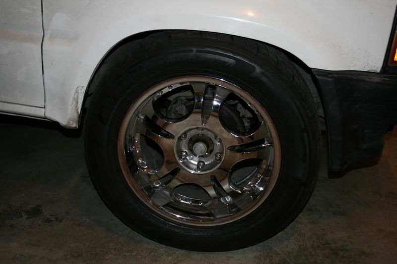

mine are 20x8.5 Budnik Sweepers, with a 7 inch backspace, 225/30/20
stock rear axle redrilled to toyota bolt pattern
front is aim spindles, pie cut upper control arms, and a Phatty Fabs custom 5 lug hub with 12.2 inch rotors and 4 piston calipers, upper arms are shimmed abit to get more camber

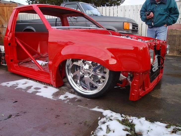

4 Lug all around, offset is 42MM . 20x8.5 sporting 255/35/20 . Front suspension is stock spindles,modified lowers with rear strut rod.Upper control arms were custom made from a jig. Rear suspension is a Rx-7 Independent axle assembly. Hydraulics all around.
