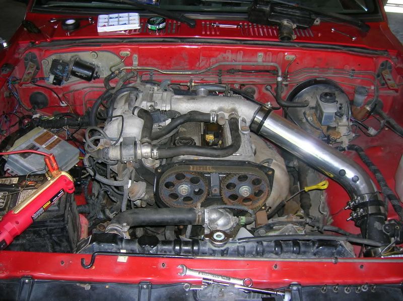

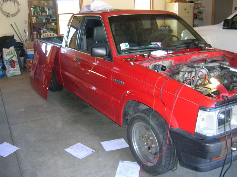

I know the engine aint much to look at now but it's almost running.

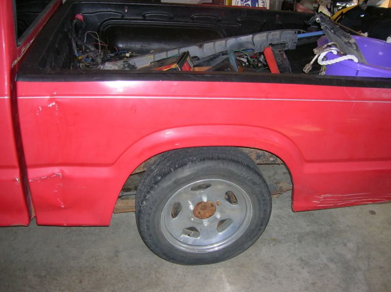

Truck was bought outa a junk yard for $300 bucks. cheap for a complete truck that was perfect outside
It was perfect till i went to get it and i saw they hit the lower rear box wit something and hit the front wit the loader

So, I have a question for you and anyone else reading this thread...
Where can I find a complete run down on this swap? It seams that there are bits and pieces scattered around, but nothing with all the info in one. Basically what needs to be done to swap the FE3 into a carbed b series? Fuel delivery/ return? Stand alone computer on the new motor? If not where do you tie it in? Do the stock guages work with the swap? Ect. I could go on and on. Where did you get your info on the swap?
F
fe3mazd
As far as where i got my info from it was matthole who inspired me to do this. Im not one for after market computers so i used the stock harness and ecu. For the fuel delievery i used a mid to late 80s ford frame mounted fuel pump and kept the stock return setup. The wiring all depends on what year motor and harness you use. Mine is out of a 95 sportage and my harness was different then mattholes. Anything you need info on just ask and ill do my best to help. good luck
tre5
Is the Kia computer stand alone? Or does it have to tap into the mazda harnes? I am guessing it does for guages, that is if they work with the swap. Does it tie into the mazda harness in order to run though?
F
fe3mazd
In order to run no the harness doesnt tap into the mazda harness. I used my stock positive cable and the wires attached to hook up the starter so you dont have to cut into the ignition wiring. Havent got into the gauges yet.
