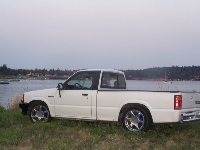

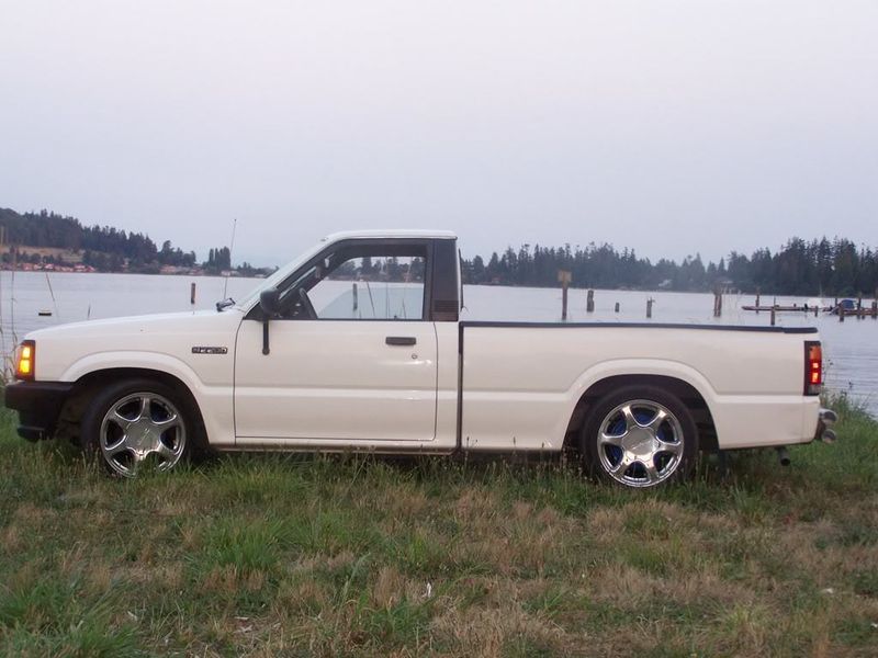

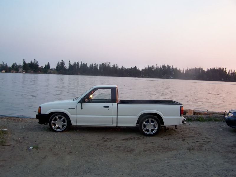

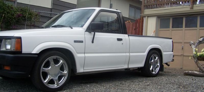

what do you think ?
truckinfavis

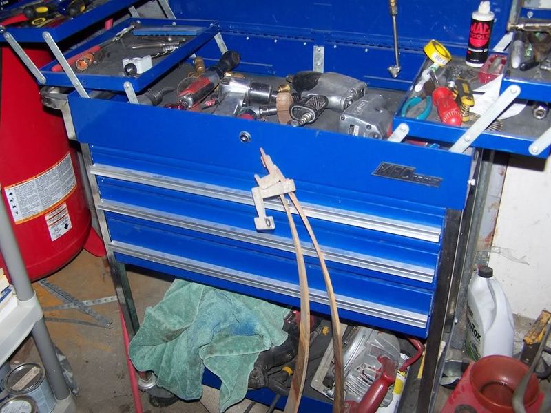

I pulled two but was rubin so i put one back. So now i am two plus helper
mazdawg(mikey)'s avatar
mazdawg(mikey)
looks good dude
truckinfavis
Thanks
mazm's avatar
mazm
yeah man it looks good real clean lookin truck and im lovin the denalis
crazymikey's avatar
crazymikey
lookin good.love the denali rims...hell,the whole truck is clean.i love em in white.
what size drop blocks and what size tires do you have?
you'll get a really nice stance and awesome handling with 205/40/17s. I had those onmy Eskies after changing from 205/50/17s that rode and looked like balloons.
Run 3" blocks with 1 leaf and a helper and you'll sit low. You could do 4" blocks with 2 leafs and a helper and maybe a mini C notch 2" into the frame.

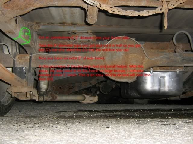

crazymikey's avatar
crazymikey
so you have 2 large leafs and the helper? i ran just the 1 big leaf and the helper on mine. Never had any problems other than the axle smacking the frame,hence why I suggested a mini c notch.
do you have drop shocks or anything?
truckinfavis
I dont wnt to have a couple of holes in the bed but would love a mini notch.
so 4 in blocks and 2in mini would but me where i think it would still be a usefull truck for me. how dose it handel? and what size shocks?what about camber? <img src="{SMILIES_PATH}/icon_rolleyes.gif" alt=":roll:" title="Rolling Eyes" /><!-- s:roll: -->
