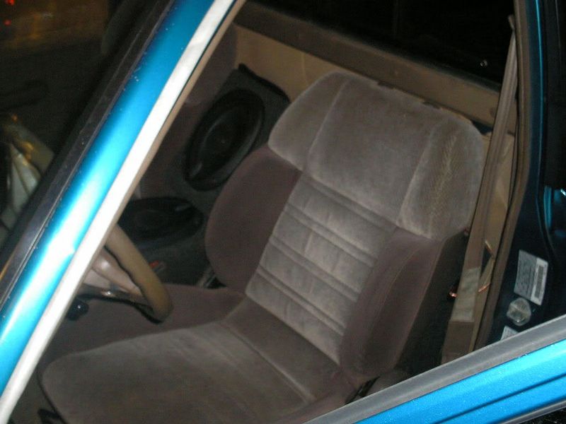

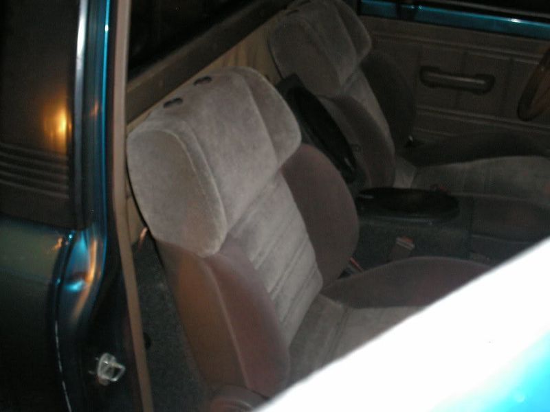

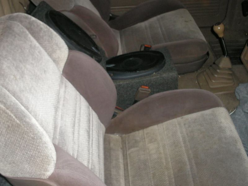

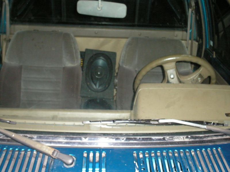

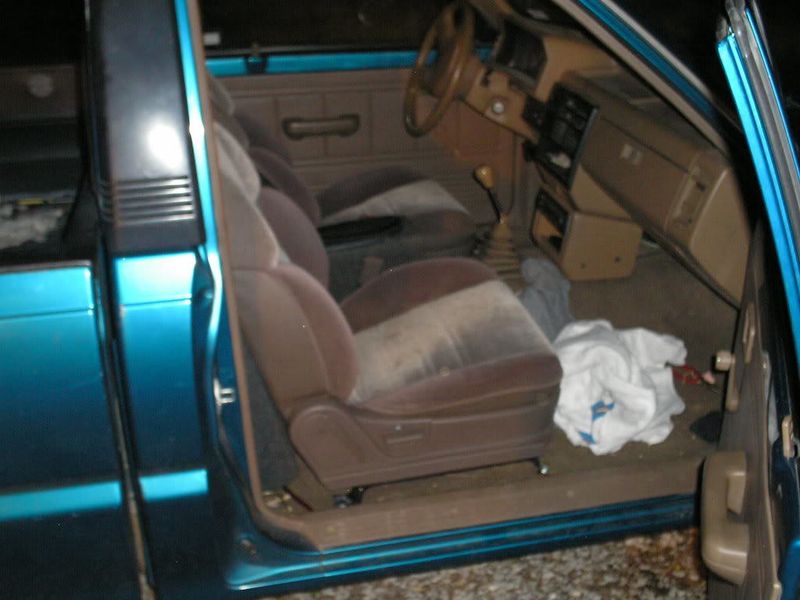

Hey Guys it took me about two hours cuz nothing but one bolt lined up but now it looks and rides GREAT check em out tell me wat ya think... next i am working on mounting speakers in the doors and building my own custom console

Sooo, did you drill new holes for the other holes on thelegs on the tracks?
Also what hapened to the head rest pieces? My friend is doing the same mod but his seats are the blue ones and his truck is extended cab.

i just drilled new holes through the floor board and used some 3/8 inch bolts with two washers up top and two washers down below and a lock nut... it really wasnt to hard and i just pulled out my headrests.... i like it without them my seats lay back further with them out

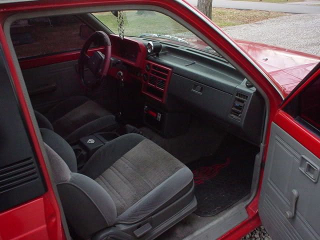

i had some 626 seats in my 86 b2k...i mounted em up the same way you did...i would love to get ahold of another set...where/how much u get yours for?
Heres a pic of mine...

What year 626 seats are they - the late 80's early 90's 626 seats I have bolted right in - fit in the factory holes I just needed to get myself 4 more bolts cuz I replaced the bench - SO I just used the bolts that were in the 626 that I got the seats out of..
