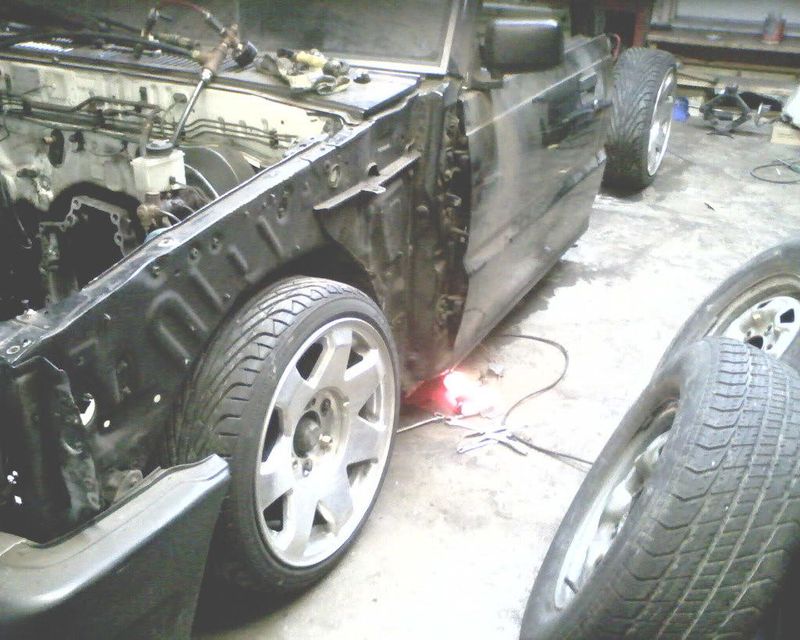

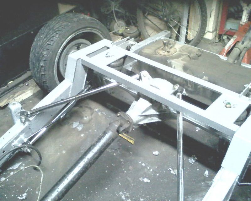

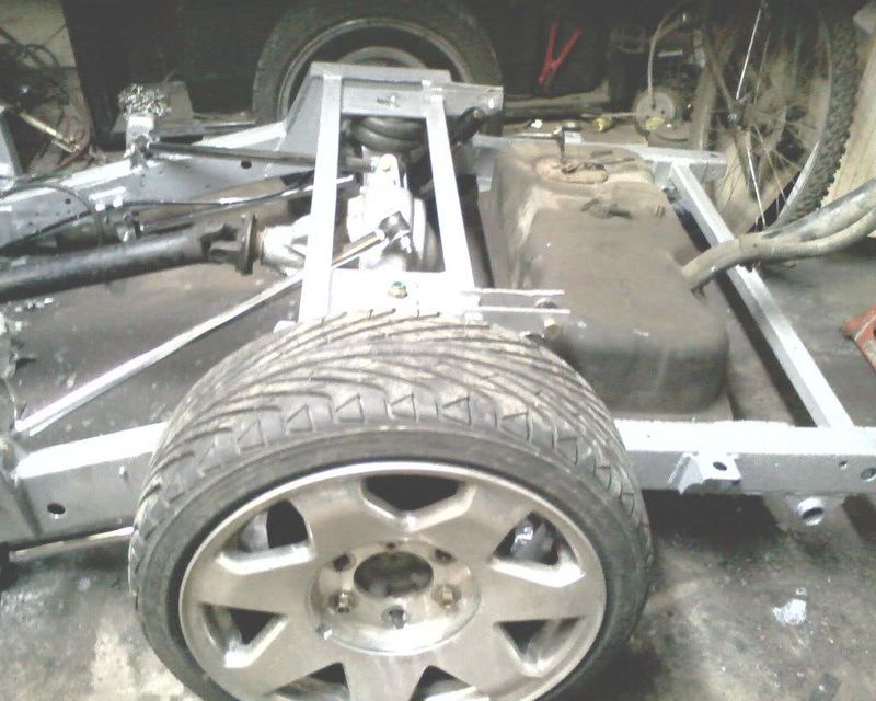

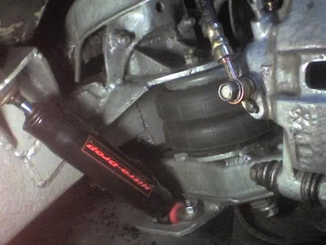

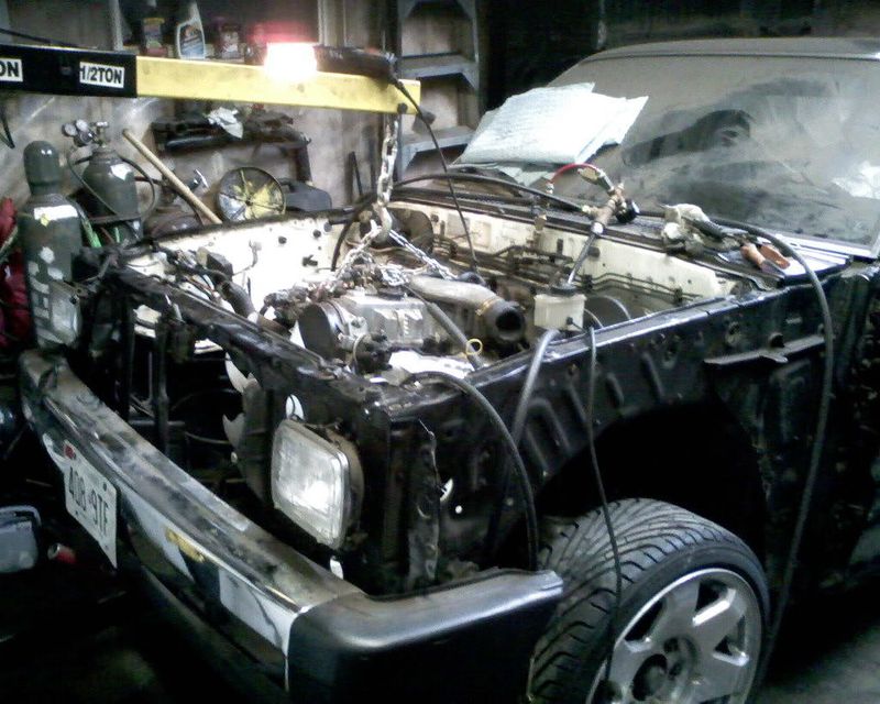

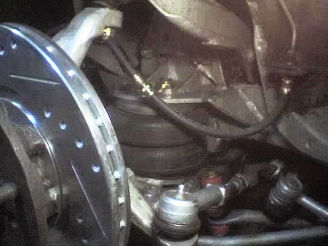

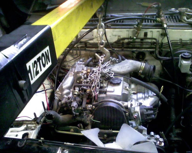

Hey guys heres some pics of my project. Just finished bagging it and doing a 4-link. I still have to mount that brake line in the first pic. They're cell phone pics so sorry about the quality.

Looks good man. I like the polished 4link.
looks good i like the front rotors

looks like to me that the rear bags are not collasping upon themselfs (brackets not lined up correctly.... could and probably will cause problems down the road) also thats one hella pinion angle you got going on when layed out...
good eye
mazdamn's avatar
mazdamn
bars look adjustable, most likely can take care of that issue...or most of it anyway.

Yea I built the 4-link at ride height with the same pinion angle as the old leafs had. But the bars are fully adjustable and when I adjust out the pinion angle it will re-align the bag brackets back up. Good observation though. I am also going to throw some bump stops in between the axle and the notch.

Looks like some good work, you front shock mounts are clean!
