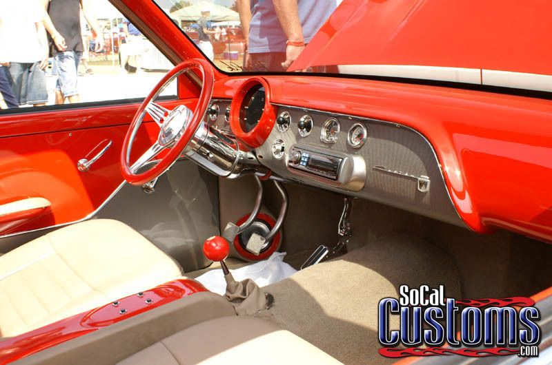

that interior is freakin sick!!! really nice looking truck

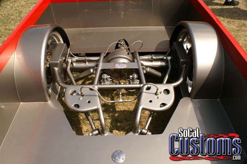

bags on bars...with tubular bars? wtf, sick truck though, fuckin sick!

yeah and nice big bends on the bars at the axle end... great place for them to break... but that is a sick ass truck... I love those wheels.

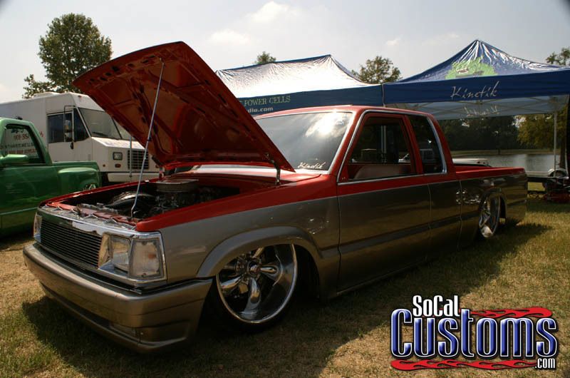

Thats a killer truck...

thats Elis truck , its been bagged like that for atleast 6 years , front set ups way trick . use to be copper9when it was chris hansons) then it was dark green and grey9MT cover ) , now its current forum.

i'm not so sure about trick front setup...the upper ball joint isn't made to be load bearing...

yeah like gravity said, those bars wil eventually crack and causeing it to break but considering it isnt a daily it wont be a problem.
I believe it still has the bag on top of the control arm for the front setup i got alot of pics of this mazda at havoc sick truck overall

do you have anymore pics of the front setup. maybe some lower pics. i am having a hard time understanding how the lower bag mounts are mounted. thanks man.

the bag does not push on the upper control arm , theres a rod attached to the bottom side of the bag whick runs thru a guide and attaches to the lower control arm.
