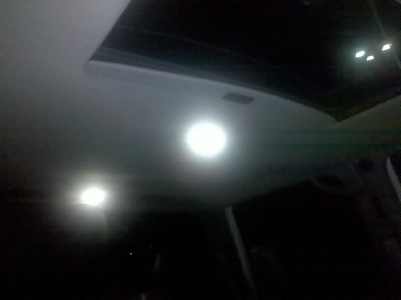

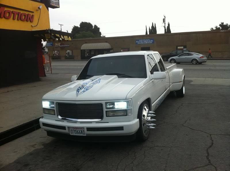

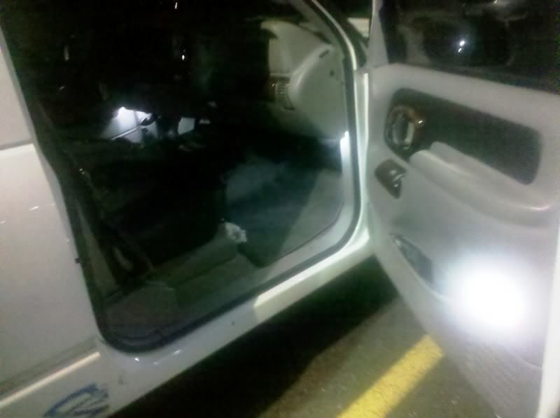

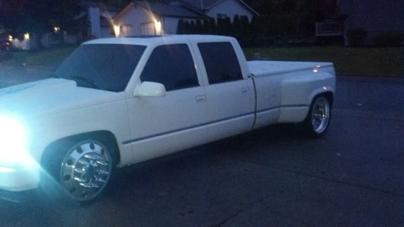

I converted my low and high beams on my 2000 Crew Cab to HIDs. I then switched out the license plate light all interior lights and my dash to LED. I love the set up and look.
I liked it so much I hooked up an HID system on my 95 GMC Sierra and my 99 Silverado. Hooked up the interior to LED too.

Yes I will definately get that done asap! Dropped are those 22s or 24s? lookin to do the same with mine with 24s... Ive seen several pics of that truck I love the way it looks.

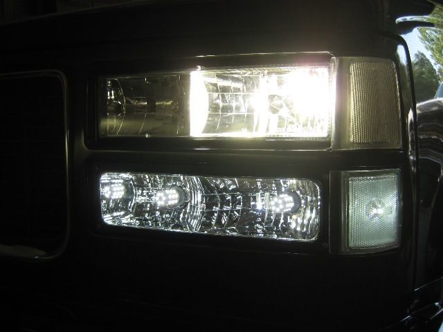

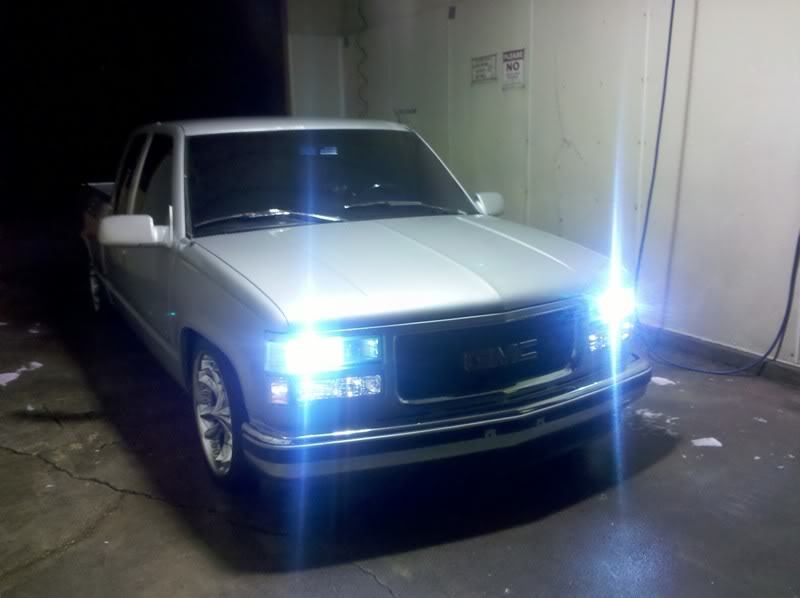

I got the cheapo kit from (a cheap place that drop-ships from china) in my '94 ext cab, 5000K 35W slimlines and I got the optional harness kit too. Decent quality for the price but I wasn't expecting much, ya know? The factory housings are horrible for HID, or at least the capsules that aren't meant for reflector housings, so I swapped in some TYC Elegante housings and they glare way, way less. Switchback LED turn signals and LED corners in the pic too..

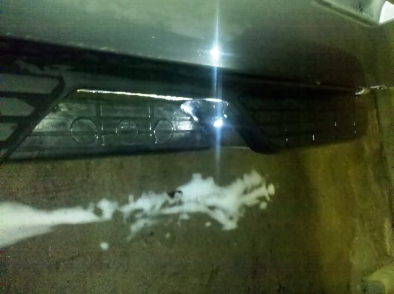

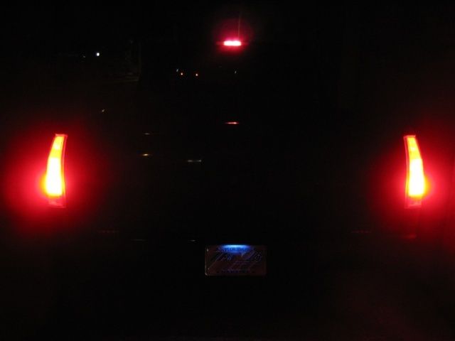

Really bright LED tail/brake since I'm running the "illegal" totally clear (but OEM-patterned) tails, and made my own LED tag light for my Sir Michaels roll pan when the original hardwired bulb burned out, I drilled a couple holes and used a pair of cheapo 194 style LED's glued in and soldered together.

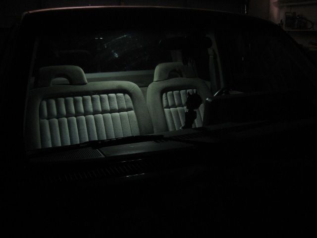

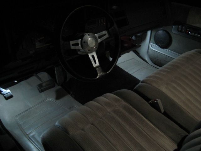

Most of the interior bulbs (courtesy lamps, dome, map, ashtray, glovebox) of course I had to solder in the map lamps since they didn't have those hook style attachments. Wish I could come up with some kind of different dome lens that had more of a clear appearance; no matter mine is still very nice white plastic it makes the LED output look yellowed.

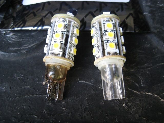

Tried to do the 3rd brake/cargo lamps and caught the goddam bulbs on fire because they fit so tightly in the socket it broke the leads off the LED's internally and they shorted out. That sucked...
