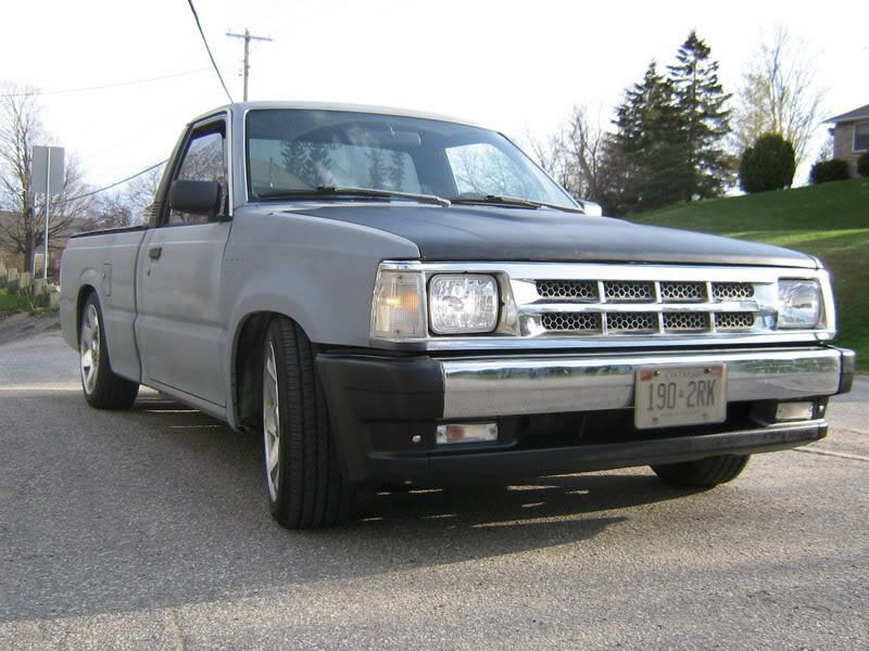

Well I've been rollin the bubble hood for a little while,but since I put the spindles on,I needed a set of 4x4 fenders for my clearance issues,so I picked up some 4x4 fenders and bumper caps. Now all I need is a bed,lol
I used Krylon Fusion paint on the valance & caps. Stuff is sweet!

Can't wait till I spray the truck in a few weeks. Gonna look sooo much better. I'm definetly lovin the 4x4 metal though!

Looking very nice Mike. I can see by the bottom pic what you mean about the clearance issues. Another option I might suggest is what I dod with the daughters lower control arms - balljoint moved in 3/4" on each side. Upper control arm moved in the same amount. Definately makes for a little breathing room.

Immortal,I took my grinder and trimmed the inside lip of the fenders for a little more room. I also think that the alignment may help with the right wheel,because it's way off. It actually looks like it has positive camber and it has some massive toe out.
