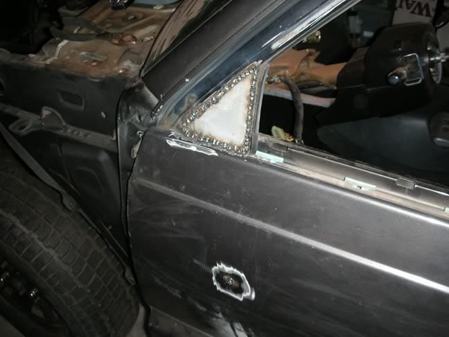

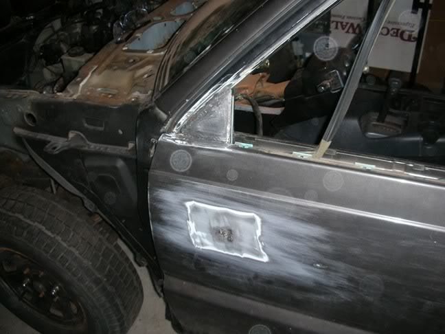

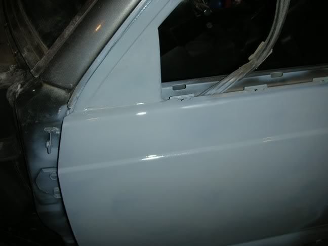

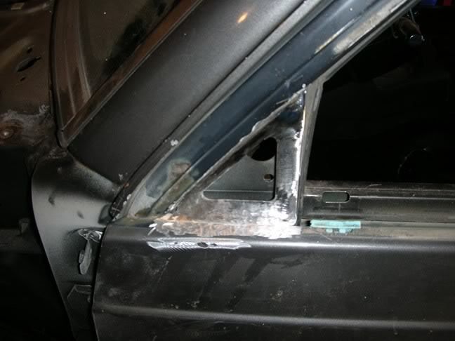

Decided to shave my mirrors today, they came out really nice the worst part about it was grinding down the welds in such a tight area. other wise it was pretty easy. let me know what you think! thanks

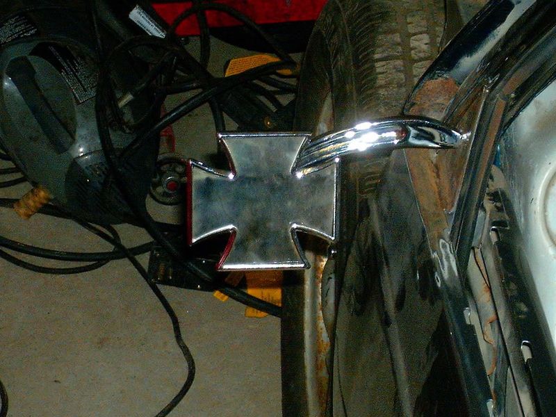

Do most motorcycle mirrors have threaded ends, or do you weld it in? HOw are yours mounted v8maz?
cruznlow612
dude... thats awesome. i love your truck so far... how hard was it to mount those mirrors? do you just have the stud go through a whole and a nut on the backside?
V
v8mazda4ever
Ya those are billet mirrors alll I had to do is drill a hole, and they do have a threaded end all I had to do is cut down the treads a little and use a washer then lock washer then snug it up when the truck is finally finished I will use some lock tite to make sure they are really on there.
